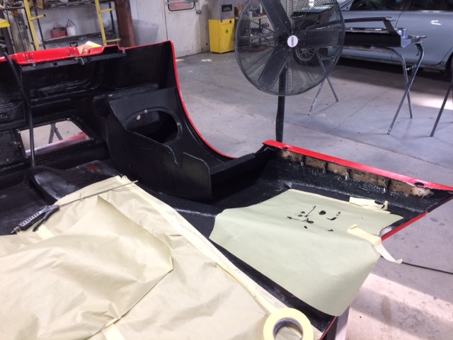

Anyway, I want to share with you some issues I have discovered in the fiberglass body. I spent hours sanding, blocking, and prepping the car for paint. Now I know fiberglass is somewhat flexible, but gel coat is less forgiving. When the gel coat cracks, you will find spider cracks in your paint. I thought for sure I had reinforced all the potential areas for cracks, but I missed one that is so obvious I'm not sure how it got passed me.
As you work on the engine bonnet, pay close attention to the tail section that the sits on the two pins of the main body. Its very thin and needs additional support. The tail actually sits (mine anyway) on the two "ridges" of the pins so a lot of stress hits those two points. Well it flexes there and caused some spider cracks. I am too anal to let it be, so I added additional support to this area so the flexing is reinforced over a larger area. Now you may have a better idea on how to do this, aka foam, more glass etc, but however you do it, it needs it. I added aluminum gussets and thickened the glass a bit.
I also got some spider cracks in the curve that heads upward toward the gas cap filler in that curve next to the door. I wanted to use some aluminum reinforcement but spacing there to the main body in so tight, I couldn't so I added a few more layers of glass. Probably won't work long term but I had to do something.
The body lacks the same precision of the frame and CNC'd parts so pay close attention to things like air pockets and areas that are just too thin. If you plan to paint, it will pay dividends now to fix the glass and gel. If your wrapping, probably not as big an issue.

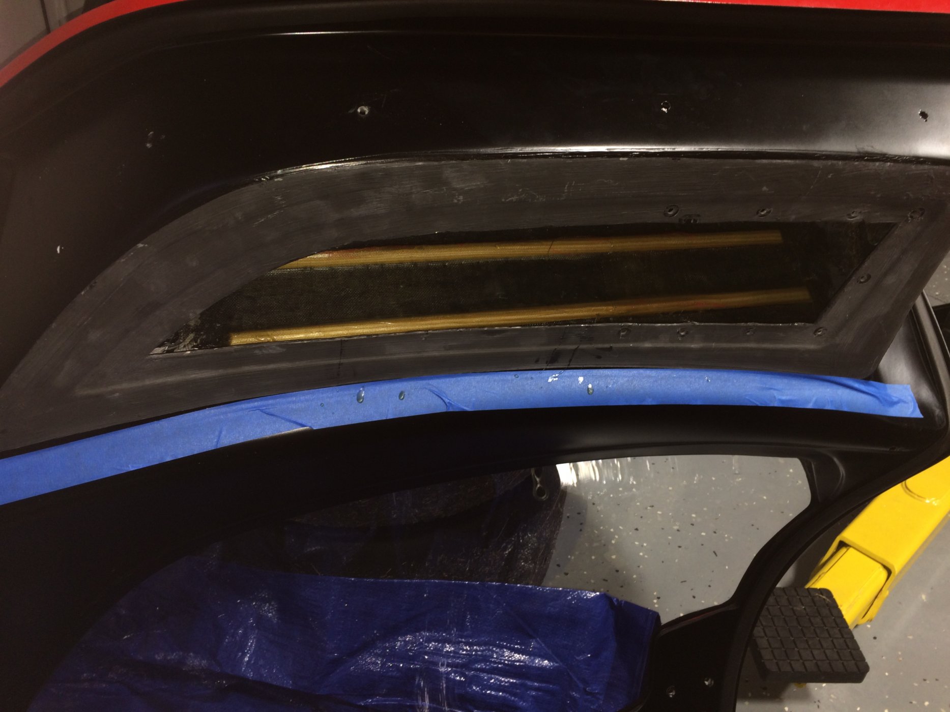

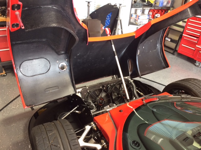

May I ask what undercoat did you use for your nose/tail? I have that on my to do list, find something more of solid black to apply over what's on there. Only for appearance when they are opened, seems some what easy to do as well.

I used a product called RAPTOR. It’s a Bedliner material, easily applies with brush or spray. What I really like about it is you can have a paint shop color match it to whatever color you want. I matched my red and applied it in areas such as the front wheel wells for impact protection. You really have to look hard to even notice. You should check it out.

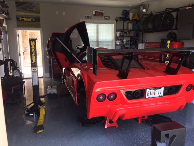

Looks great Dan - epoxy floors? I’m in the process of working on my garage as well - well, I’m paying a pro to do the heavy lifting this time around. Poor guy’s been mudding the last 2 days and still has at least 1 more to go before he can texture.

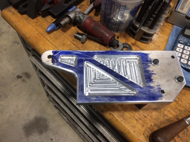

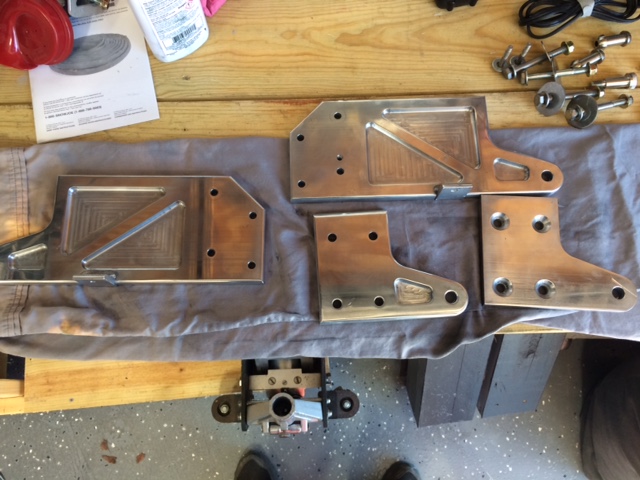

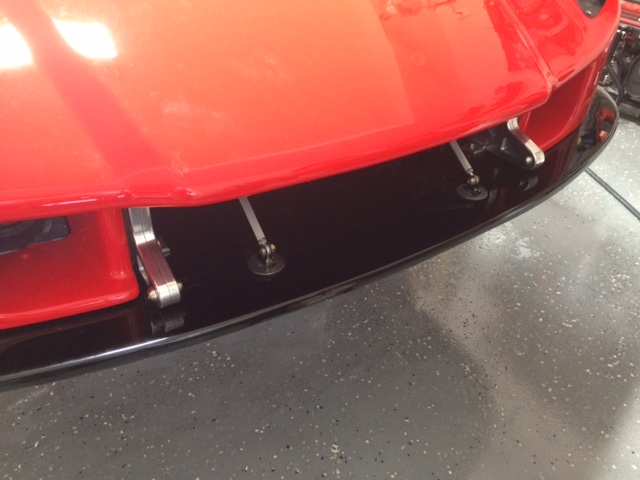

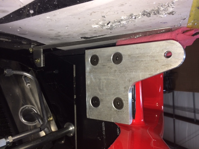

Necessity is the mother of invention. I wanted hinges for the nose, so I finally just built my own.
In the process of mounting, it was critical to ensure the hinges were truly parallel and perpendicular to allow unrestricted hinge operation. We needed to ensure perfect shimming to the fiberglass body. Rather than spend a ton of time measuring and finding precise shims to fit, we took sandwich bags and put panel bond inside the bag. We then placed the filled bag between the hinge mounts and the body ensuring precise alignment and put some pressure to allow a nominal amount of panel bond to fill the space we wanted to create a perfect shim. See the picture of the four black goofy looking things. Once trimmed and mounted, they disappeared from sight.
For now the hinges are polished billet. They may get powder coated later if I decide I don't like the look.
This may work for other applications as well.

Very nice work Dan, at some point if you could share a template I would really appreciate since I’d like to make something similar.
