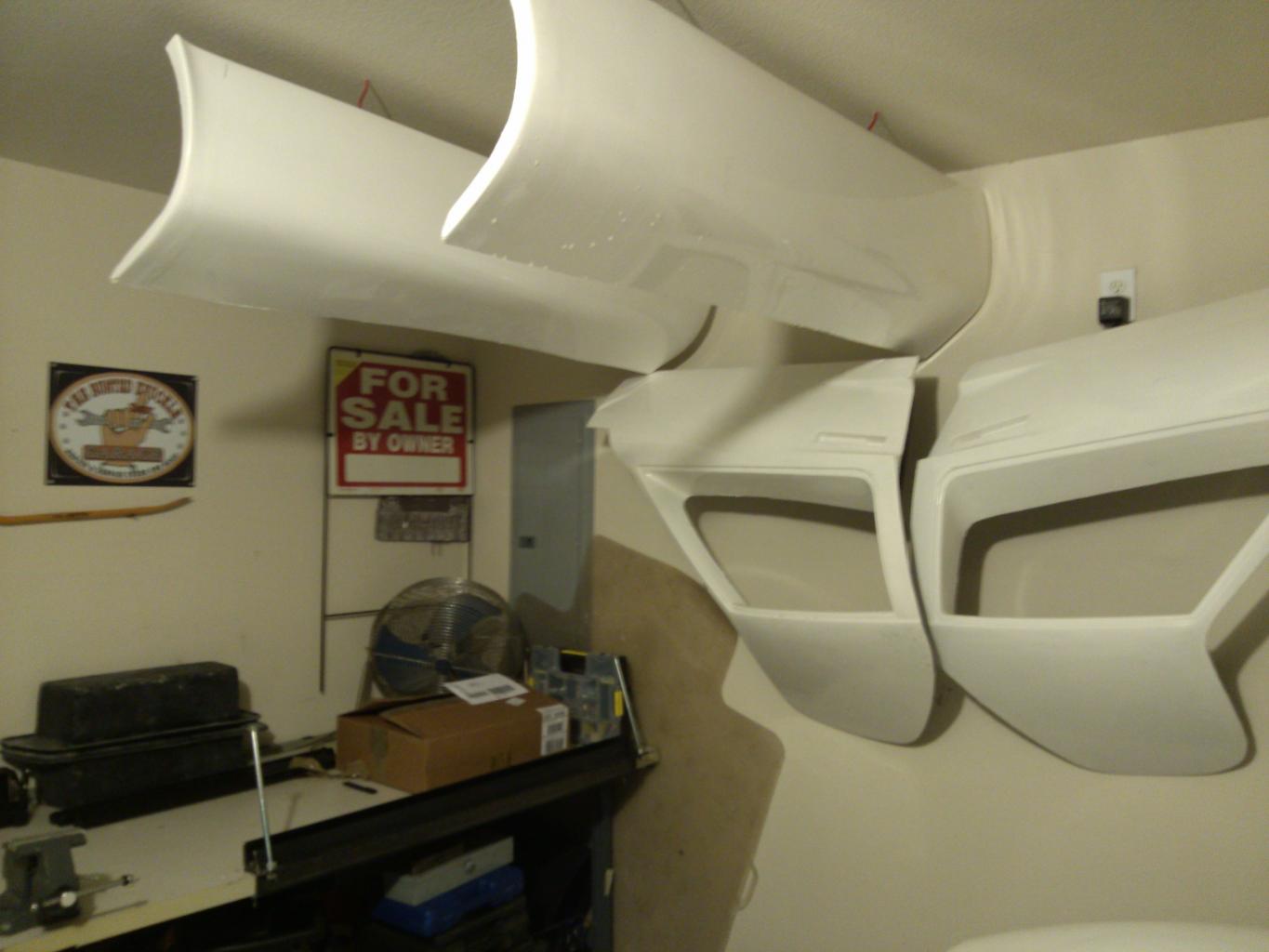

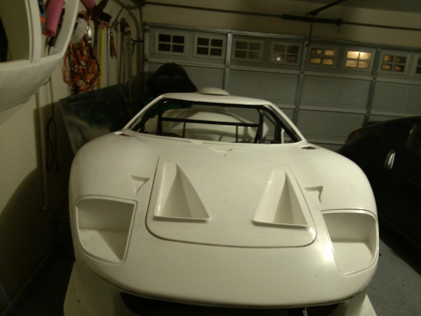

Finally, it made it in! Delays all along the route and today I found out that there was some damage done by the shipper (crushed Gurney bubble, chassis scratches, some bent suspension components, and minor rear clip damage) but it's here at least.
VERY pleased with the chassis. Welds look great and the powder coating is excellent. The fiberglass is pretty thick and although there will need to be finishing for sure, at least everything seems to fit from what I can tell on a loose fit trial basis.
I am missing a couple items but a little harassment and I'm sure that will work itself out! LOL
Anyway, here are a couple of pictures. The garage sure looks small now.

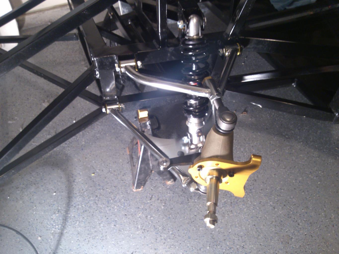

Not much of an update. Just trial fitted the front suspension to make sure all was well while waiting on some laser cut panels to get finished. Looks good to me.

Hi Darrin
Just a note, if that camber adjuster in the top wishbone is aluminium I would suggest you please get it changed to a steel version. It looks to be the gold anodized Rally Design supplied part. On the locostbuilders website their are several stories of these breaking on a 7 type, let alone a GT40.
Regards
Fred W B
Camber adjusters - there's a guy selling steel camber adjusters on ebay in the UK. Sized to fit the Ford drag link thread, M18x1.5. He also does a version with matching sleeves for if you're fabricating your own wishbones.
I tried to look it up on eBay but couldn't find anything.
It is and I was wondering about just that. Will see if I can find a replacement.
Hi Darrin
There was a link in my post to the part on ebay, but I'd obviously done it too subtly! You've found it though, so that's the main thing.
I understand these should be a direct replacement, but yep, it would be good to get it confirmed first if poss.
