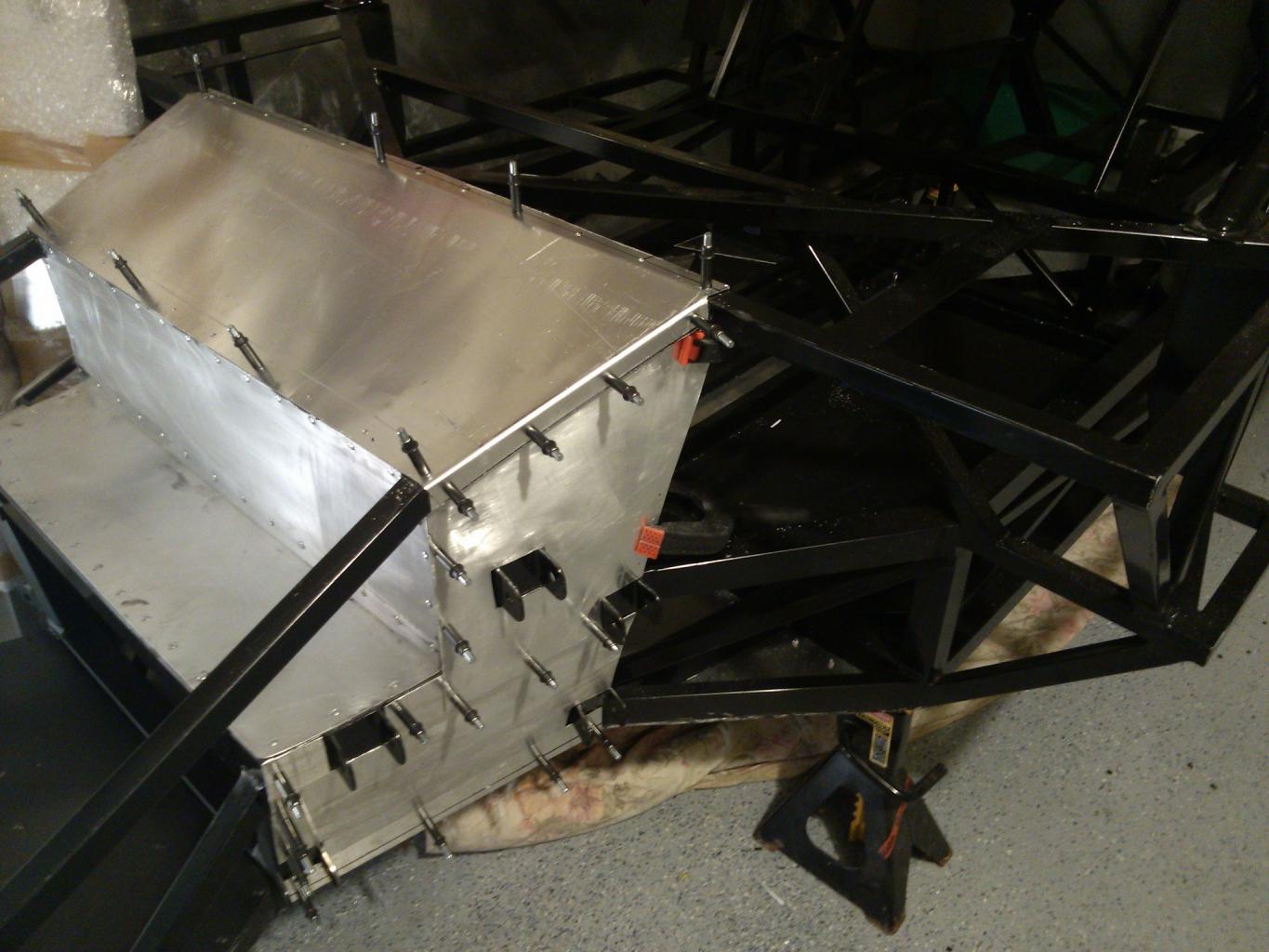

Part of the front done. Got a hard panel to do next...lots of bend in it.

Don't be in too big of a hurry to secure that top and front panel. You will be going in that direction for the pedals, steering, water pipes and wiring. At least to rough them in.
You are making good progress. Steady as she goes
Thanks Bill. Right now I just have the top in with Cleco pins and it will stay that way for now. I plan to rivet in the side pieces now though. The very front I am planning to do later as you say.

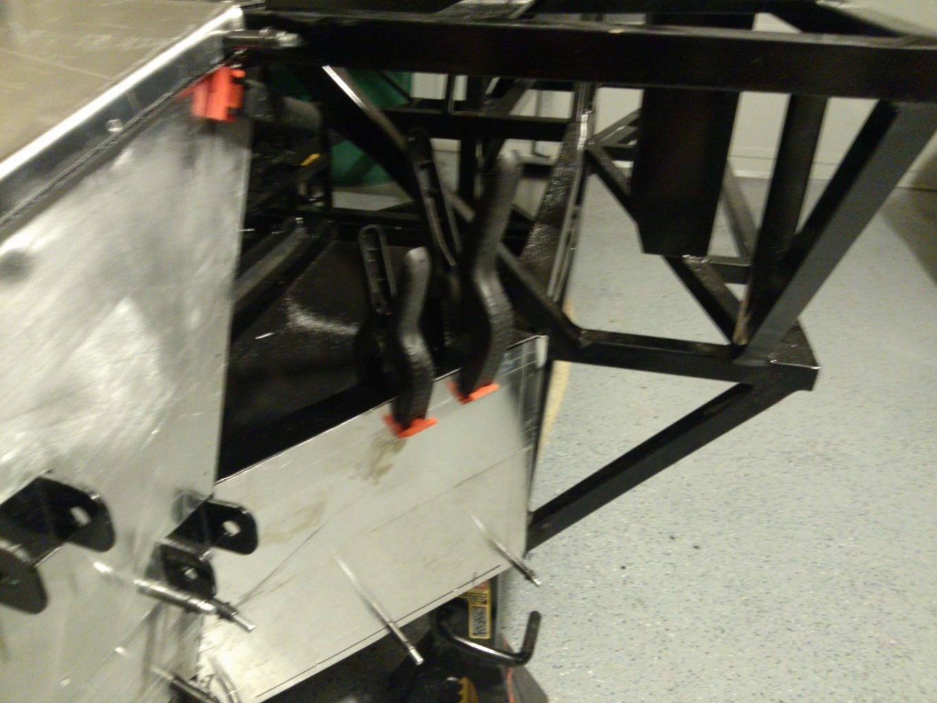

Another day another panel cut. LOL
Really stuck now though. The next panel needs to take a very, very odd shape in my opinion. Looks like it should go across the top (all 14" of it) then back at and angle, then bend of the left side and pull forward to mate up on the left at the vertical bar where the other panel already is.

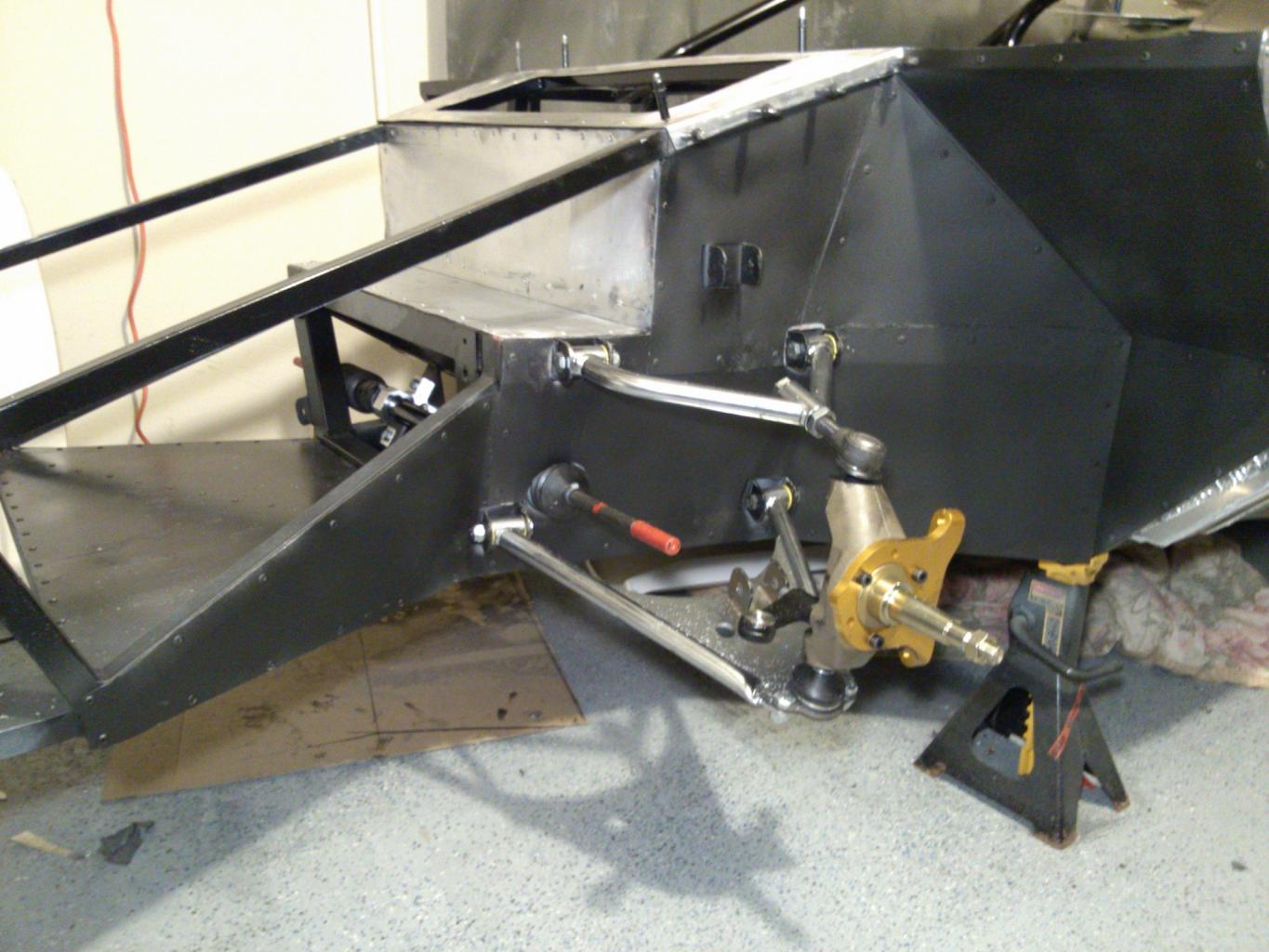

Some progress on my project. Front driver's side paneling riveted, rubberized undercoat applied, and A-arms loose fitted. Also completed driver's side fuel tank and top sill work. Next I will rotate the chassis 180 and finish the passenger side (space limitations) as I wait on some more laser cut panels.
Also think I've decided on the Sparco R100 seats. About the only things low and narrow enough to fit the car with a good reputation.
What do you all think about the rubberized undercoat? Leave it as is, or spray something else over top of it? It's kind of ugly stuff but it sure helps keep the noise down from rocks that hit the panels (I tested it before and after).

I would not have any problems with that rubberised undercoat, if its a plus to keep road-noise and tire noise and gravel stuff down even the better (me thinks)

On the panels try using heavy paper like butchers block to get the lines needed for the paneling. I did that and it made the layout a lot easier. The lines are tough to lay perfectly for algnment so some overlap may be necessary. Here is mine during construction.

Thanks Bill. Most of the panels I have left are laser cut from templates but I do need to fabricate a few more.

On your insulation. The stuff you are using looks awfully thin. I am using DynaPad.
DynaPad
This stuff has 4 layers and is .4" thick. It is heavy at 1 lb./ft.. I can tell you that I don't have AC in my car(yet) and probably won't. This summer will tell. The one long trip I took in it(80 miles over 10 hours time) I didn't even get warm. Some stop and go, but mostly highway. Started out in 40F and it got up to high 60s during the day. All I did was remove the drivers side window for the mid day run. Amaziing how little turbulance there is at highway speed. The trick to it as I see it is to insulate the front firewall(footwell area) really well and isolate the heat from the radiator from getting to the footwells. To accomplish that you have to extend the nostril(s) to the base of the radiator and seal all the sides or do like I did and build a dam to block it off.
The same goes for the firewall infront of the engine. For that I used a combination of Dynamat and then a layer of Dynapad. You can never insulate too well. don't worry about weight. With the power these cars have it won't detract at all.
