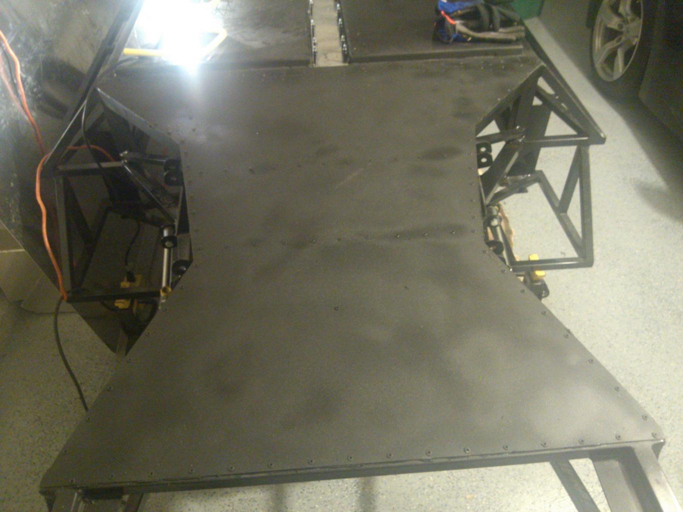

Small update. Got the first parts of aluminum sheet in place. Ended up doing the under foot area in double thickness (just didn't think 1.5 would be quite enough). Set in place with stainless rivets (set about 90 of these by hand manually...just ordered a mechanical riveter after this experience!).
The center area between the lowered seats has been drilled and is ready to be sealed and riveted. Probably do it tomorrow.
The black on the aluminum is rubberized paint. Doesn't look very pretty but it sure helps reduce the noise (I tested it). Second coat goes on tomorrow.

Photo of the underside. Note center piece with cleco's...this is next.

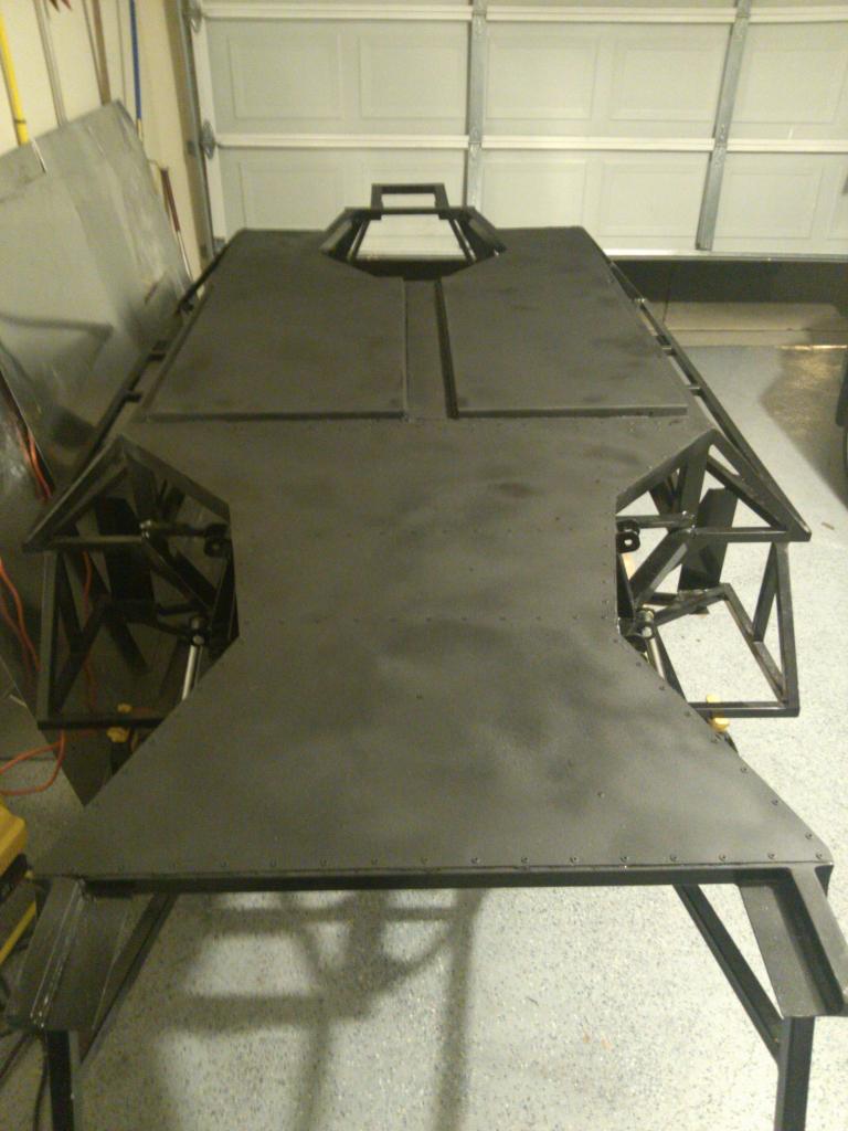

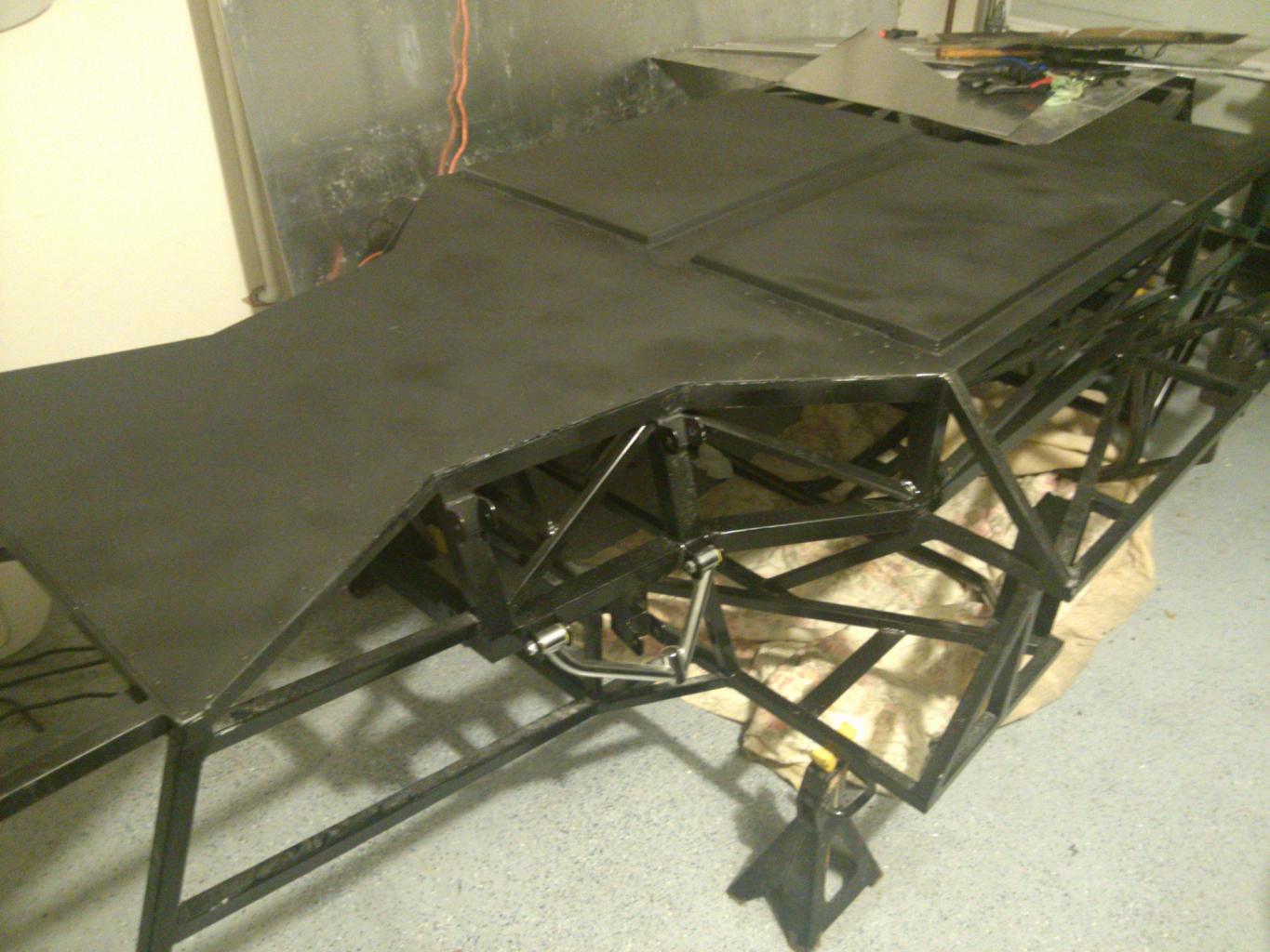

Got the center panel and one back quarter panel installed and the whole thing to that point coated with rubberized undercoat. Really helps deaden the sound.

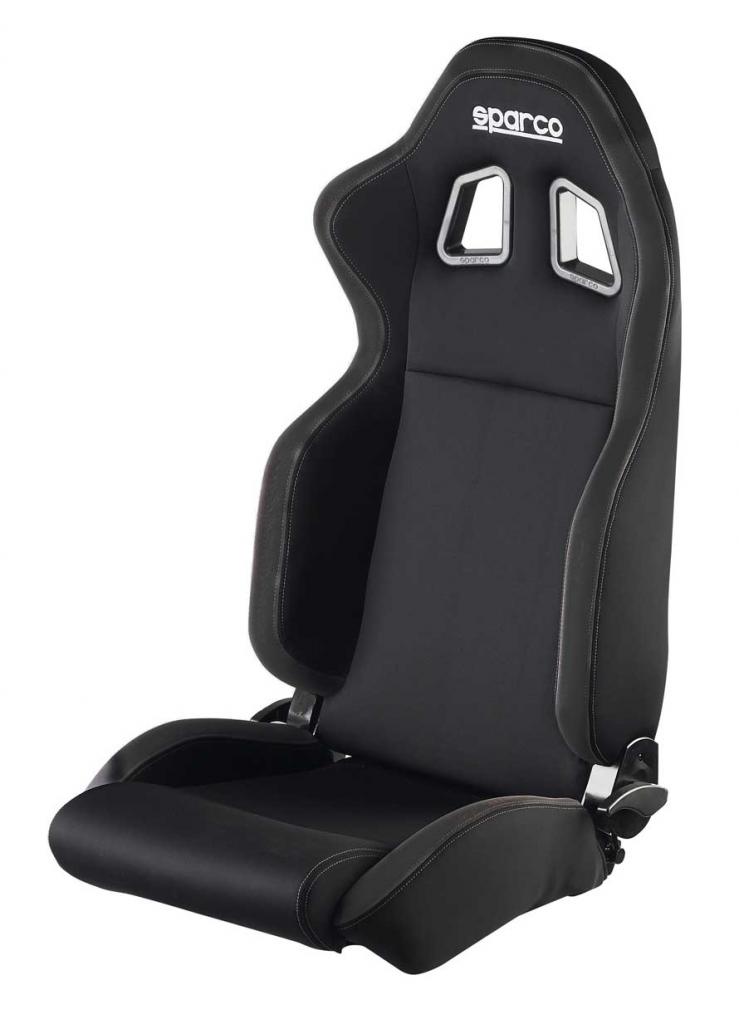

Haven't taken the plunge yet but think I will be going with these seats. They are narrow enough for the driver's side for sure (I measured) and should be able to be made to work with the passenger without much effort. They adjust forward/backward and adjust for tilt.
Thoughts?

Darrin,
I will offer a bit of advice on seats. I am not a fan of the GT40 seats. I wrode in at least 3 different makes before embarking on my build. What I noticed was that the seats that were being produced had no lateral support. Every time they made a turn I felt I needed to hang on to something in order to stay in the seat. Even with a regular lap belt. Sparco makes a good seat. I also would suggest finding a set to sit in and see if they are what you want. A lot of the speed shops carry various brands and have samples in their showrooms. I wanted good support and wound up getting the Racetech seats. The lateral sides come above the hip joint and there are supports for the lap belts. It can be seen here.
Saker : Racetech USA, Racing Seats
It was made for the early Sakers which utilized the laid back seat design. It fits the reclined firewall of the 40 perfectly. The dimensions are at the bottom of the page.
You can't have too wide a butt to get in them. Probably their only drawback. The support/mounting brackets can be shaped/cut to get around any protruding hardware at the rear of the cabin(shifter cables, seatbelt mountings etc. They sit right on the floor pan. If you have any cables or wiring runs that would go under the seat you will need spacers. My DRB has the washboard floor so it helps with that problem Hope this adds to your knowlege base.
They are Sparco R100 David. About the only ones that fit that are sturdy enough to me and are actually very reasonably priced!
I like those seats you have Bill! I just want something that will tilt. Primarily for the passenger side and resale (I am already thinking about my next build...LOL). Very good advice about trying them out first. I think I will do just that!
Bottom is done except for the drying of the rubberized undercoat. Not planning to cover the engine area as I have read conflicting things about that.
Tomorrow I'll flip it over and start measuring the top to compare against my schematics before I get the panels cut.
