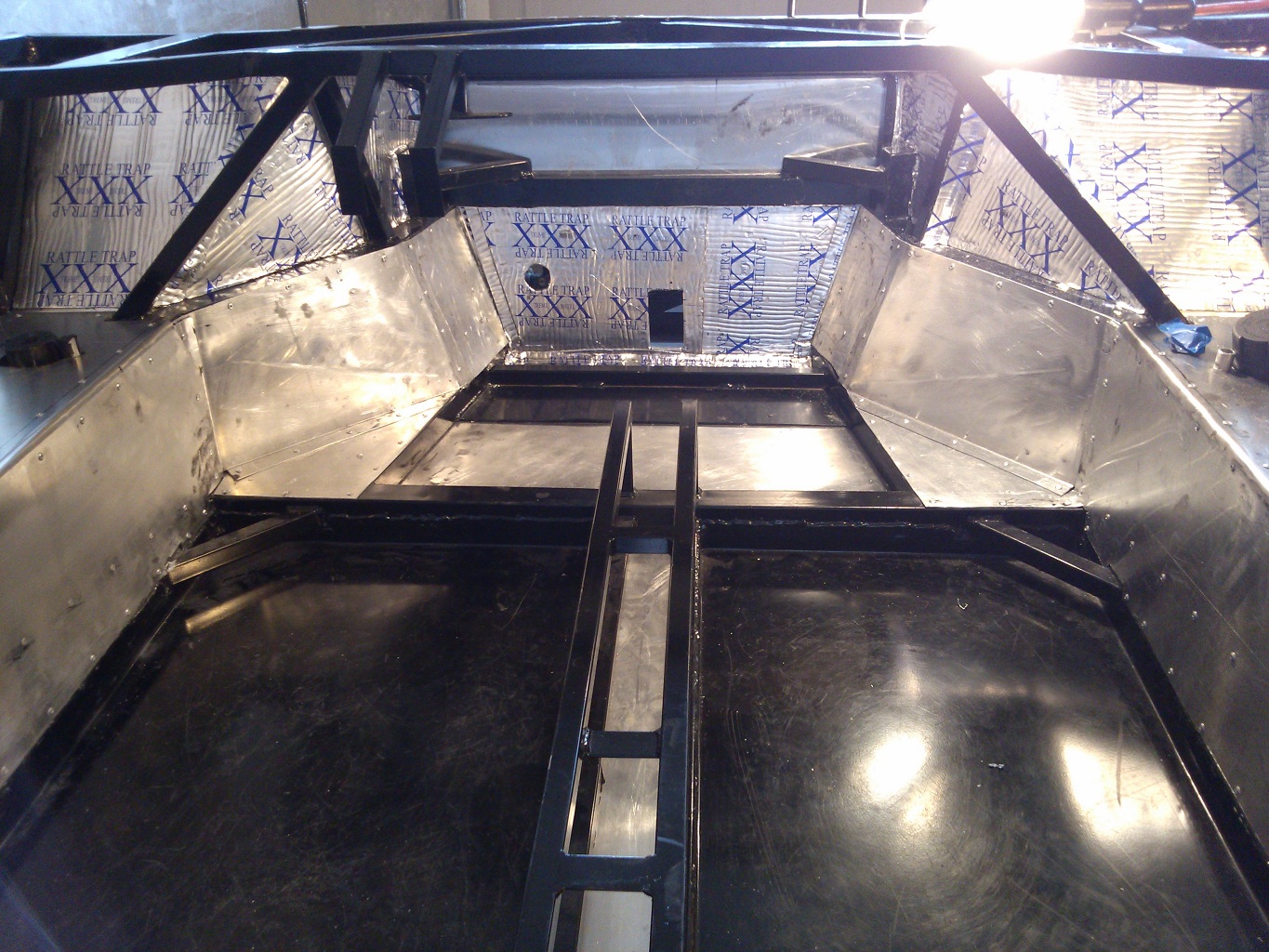

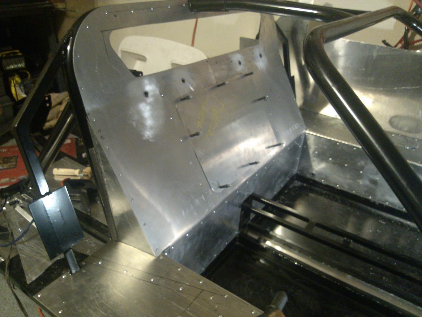

A little bit of progress.

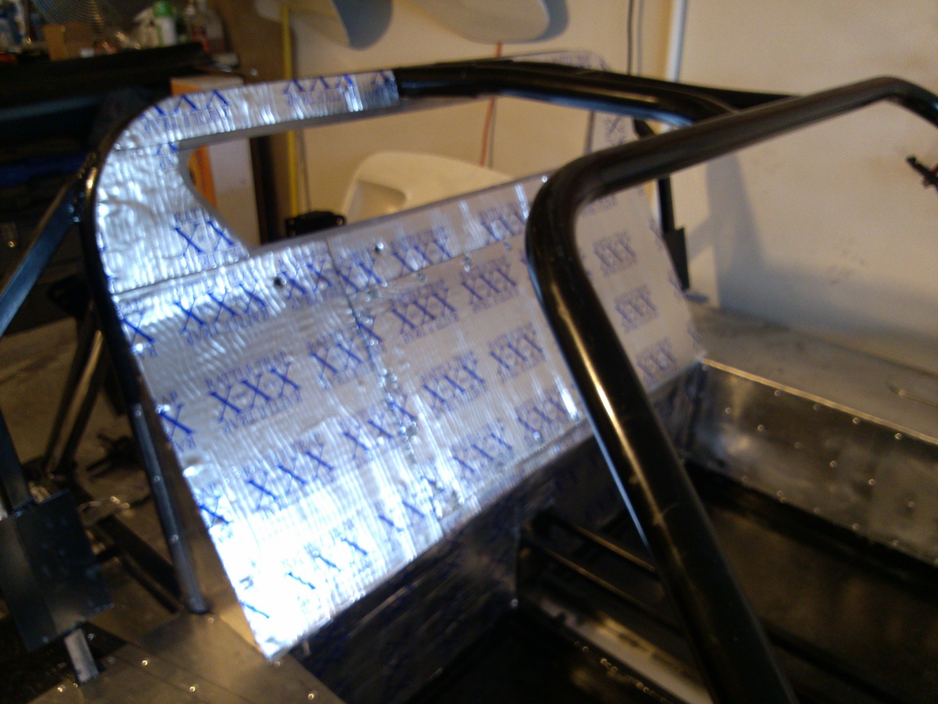

Foot well area just about done. I have some more sound deadening material to add. I have it on the inside of the panels and plan to add a layer to the outside as well. Dynapad to go over that then carpet.
The rear bulkhead will get the same treatment...Dynapad then carpet.

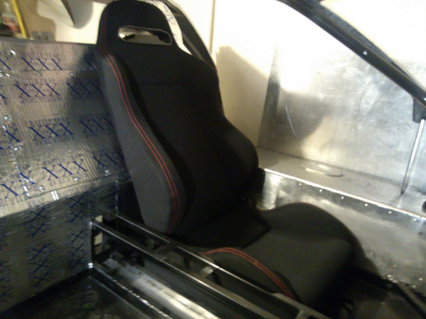

Bought this to set steering wheel positioning and such but it's not a bad fit. Might just keep it if I can get some lower profile seat runners.
I presume that's out of something rather than aftermarket? What's it out of? While we probably don't have the car it came out of here I'm after a temp seat atm for the same reasons.
No it's aftermarket.
I was about to buy a set of Sparco seats but kept thinking it would be a real hassle if they didn't fit when I just happened upon this one made by NRG (same company that I and so many folks here get their quick release steering hubs from). The measurements were about the same and the price was such that it made it worth it to me to use it as a "test mule" that I didn't have to worry about tearing or getting sealant on, etc. Looking at the thing and sitting in it though I am strongly considering keeping the thing and getting another for the passenger side. The fit is almost perfect except that it does sit a little higher than I want (comes with sliders which aren't low profile). The reviews I saw on the NRG seats are very good as well and I see why now.

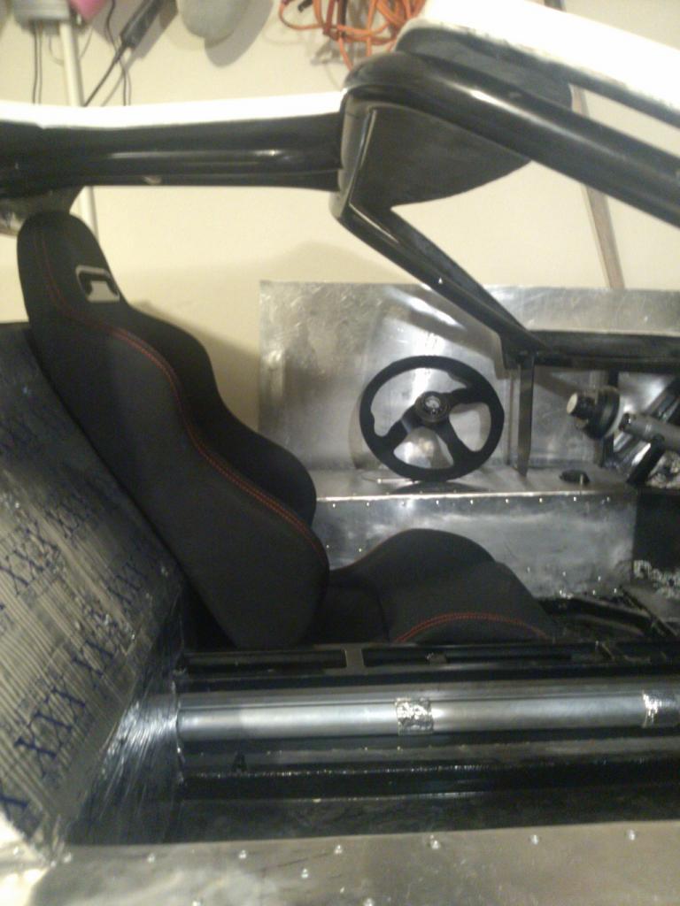

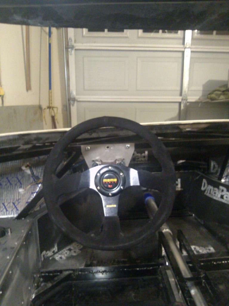

Following the path Renato did using Toyota electric powered steering. We need to work out some space issues with the pedals though. Note that the wheel is just a test mule. Have the one I will use in the car on order. Steering feels very solid and am happy with it. Seat too. Going to get some cushion taken out (it is very dense and thick) to lower the seating area 1 or 2 inches though.

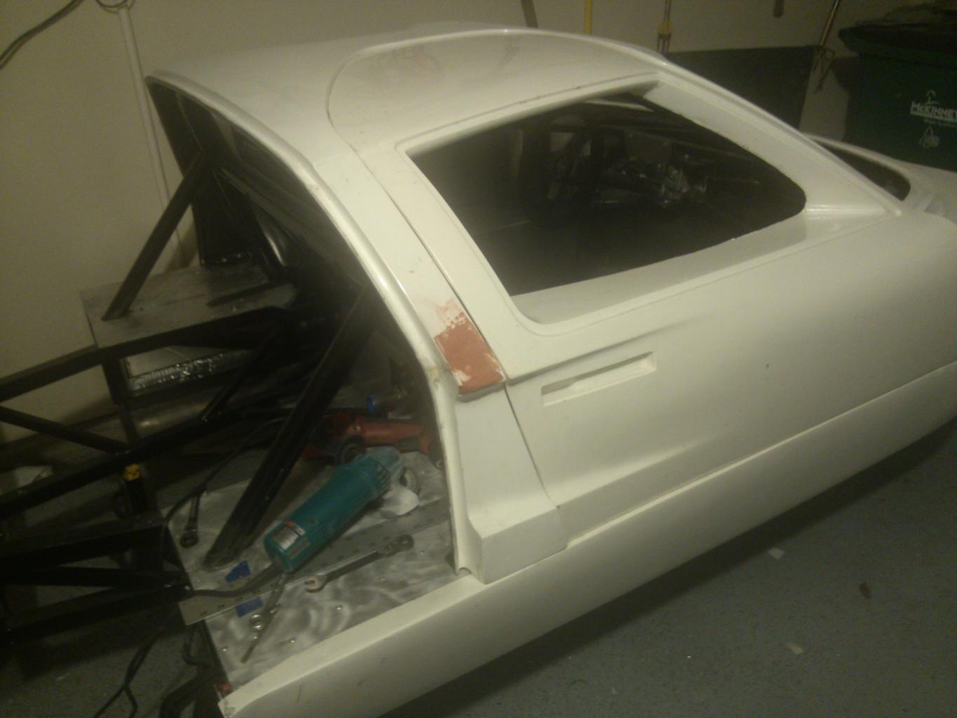

Loose fit one door this evening. Having heard all of the horror stories I guess I am fairly happy with the fit but figure it is still going to be a pain to get it just right. It's off by maybe 3/8" at the worst spot.

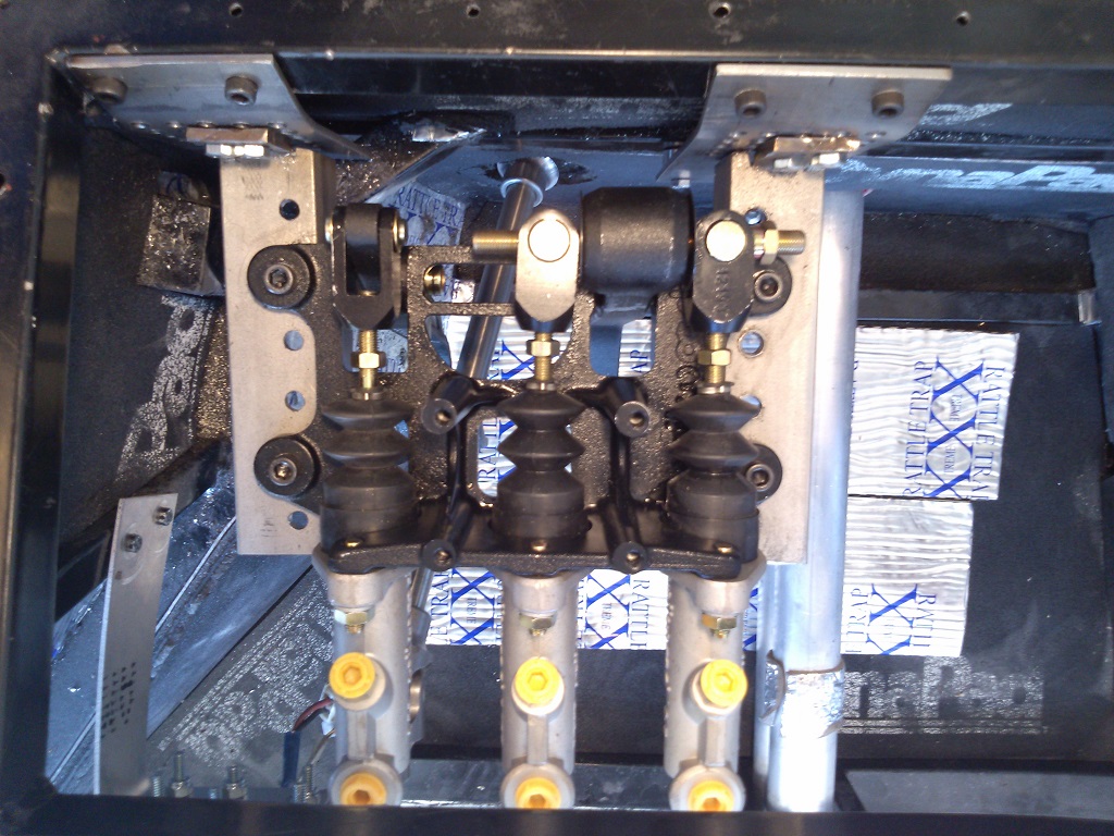

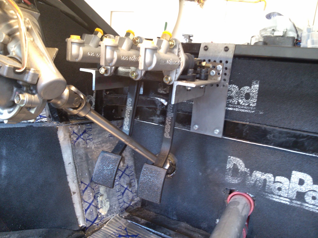

Made four brackets for my top mounted pedals (other pedal comes from Ford with the PCM kit for the engine). Two that mount to the chassis and two that mount to the other two that the pedal assembly mounts to. Took about four hours to drill all of the holes (over 50) and get it placed just right. The bracket that fits furthest outboard had to be narrowed at the bottom to allow me to retain the cross member that goes from the top of the driver's side shock. The chassis brackets are 3"x8" angled in at the top and are made of regular carbon steel but the other two are 3/16" thick 1.5" angle stainless (tough to drill through) with one end opened up and flipped up to form the mounting surface (giving about a 3" linear area to resist downward movement...it's pretty solid to say the least and not all of the bolts are even in place yet).
The setup is made to allow you to adjust the pedal assembly with about 1,5" in the X axis, 2" in the Y and 2" in the Z although I doubt if I adjust them from the current spot, it would be nice for anyone else who might drive the car in the future.

Could I suggest you fit a dead pedal to rest your clutch foot on when not using the clutch?
Easier to fit at this time than once it starts closing up down there!
I agree...but I don't think there is room for one unfortunately. :(
If I shift the pedals to the right (LHD remember) to make room for one then the angle is such that it will be odd driving. I may play with it a bit as not having one would feel odd to me.
