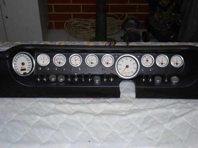

I took a couple of photos of my dash a couple of days ago and thought I’d post one. My car is a contemporary version of a GT40, rather than a strict replica, and so the dash is a bit of a cross between the original GT40 and the current GT. To me, dashes are the biggest letdown in homebuilt cars. I reviewed various car dashboard layouts and decided that the dash needed to be ‘busy’. Race cars are usually busy and messy. Mine had to be busy and neat.
I’ve gone with Smiths Telemetrix gauges. They were the only ones that did what I wanted in white. I still had a couple custom faces printed. I’m using an ‘engine start’ button sourced from Demon Tweeks, UK and I’ve purchased knobs to match for the other non-toggle switches. I’ll have to machine them down a bit to match the proportions correctly. I’m replacing the standard toggle switch blades with the ones from a MkII Jaguar. I’m making labels for the switches and dash lights in silver plastic, to match the instrument bezels, with the engraved lettering showing through in black. All dash items should then come together visually. That’s the theory anyway.

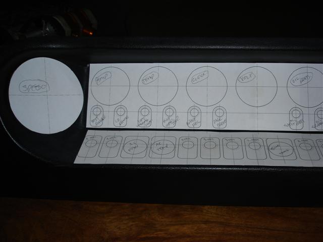

I drew the dash setout up in CAD, then stuck it to the dash to review the look (refer attached). The crosshairs were then drilled out with a pilot hole before the final holes were drilled.
It’s working out well. A bit different, but I like it.

Now that is one loaded dash.
You can see the time & effort spent planning, very well laid out.
Certainly a credit to you lance, it looks fantastic.
Have you got some closer shots so we can see detail.
My dash also uses white guages, just plain VDO ones, it looks sick & pale in comparison to your beauty.
Nice one Lance. I agree with your summation that the Dash often lets the cars down. IT was one thing I really liked about the Roaring Forties cars (and I am sure will like again) is they had a classy looking dash. When I dream of my GT40 the intrior is something I will be paying extra attention to. Your dash looks great by the way. I second Craigs motion for a bit more detail as to what all those switches and knobs do. Based on your dash, I can't wait to see your whole car!

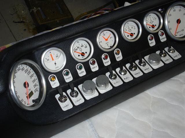

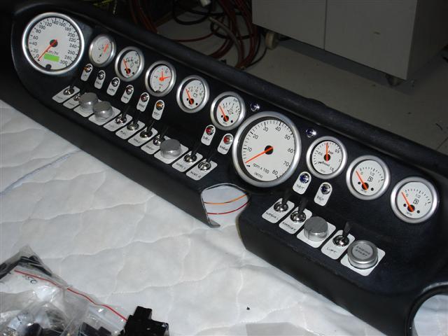

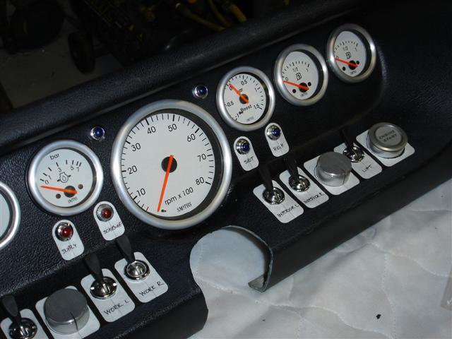

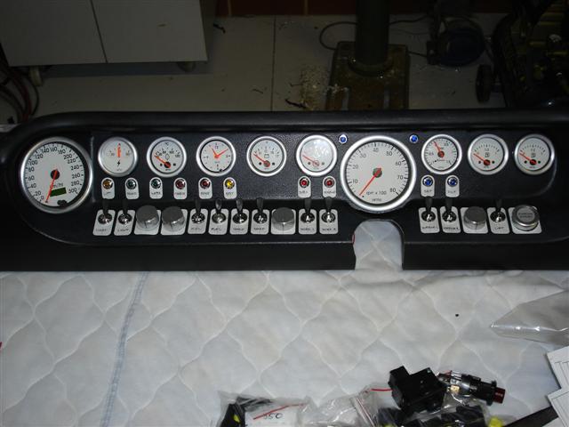

Further to my previous posts, I've mocked up the labels to check the look before I went to the expense of having the plastic final versions cut and engraved. I was worried it might look a bit 'toothy'. I wanted the instruments across the top to present a 'band' of white / silver and similarly with the switches across the bottom.
The photos don't do it complete justice, but it looks OK to me. It not the traditional look, of course, but what are the opinions from out there? Not too much?

Lance, I think it looks fabulous! Kudos for a really fine and well-thought-out gauge layout. I also am considering a "contemporary" look rather than strict replication(when I actually get a kit in my hands and start the build). I was even thinking round gauges from Dakota Digital(although that may be too cheesy for some purists). As others have stated....your entire build must be something to see! More Pictures!
Sam
I think it looks great.
The lucas switches look great with the white/silver dials too, much better than a rocker style alternative.
