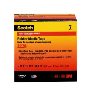

3M also makes a closed cell 1/8" rubberized foam tape that works great for gaskets and can be used to pervent rubbing on close contacting panels.
