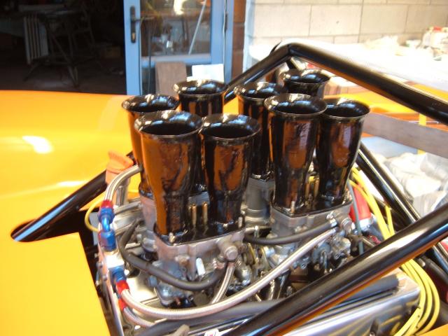

I am running 4 twin choke 40mm on my Rover, ex Alfa 33 1800`s and the jetting is almost correct with no changes. And yes they do make a great sound, I ended up making my own manifolds as the only ones I could find were moon beams.
