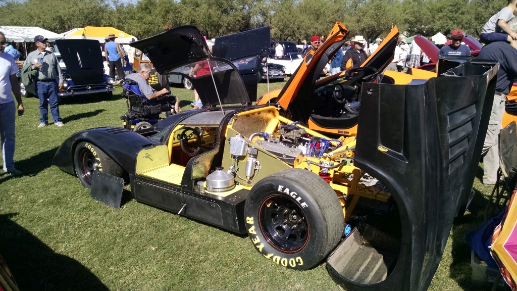

I hope that "Hemi" was not an original iron-block street hemi engine- those things weighed 765 lbs. I remember McKee building a 426 Hemi-engined Can-Am car. That 426 "only" weighed 613 pounds with the help of some magnesium components.
Regards, Neil Tucson, AZ

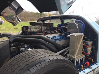

In response to some of the questions, the exhaust is a custom stainless steel design that is ceramic coated due to heat issues. The firewall backwards needed to be reinforced with a billet upper cross member, lower trans support, reinforced shock towers, electric air conditioning, and several electrical/mechanical modifications and improvements over the stock roller. It took a long time and was a very difficult build. Not for the faint of heart or anyone hoping to build something like this on a budget.
#17
I forgot to mention that it is an aluminum Shelby block with original cast iron heads. The internals are primarily billet and the engine was designed and built by Ernie Elliott.

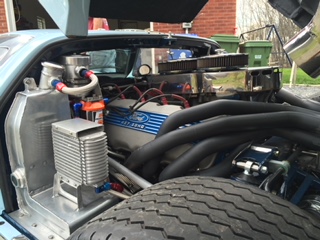

Hi, I am using the Ford Mustang Modular engine. 4.6, it's a bit big but Mick at Southern GT made me a chassis round the engine. Certainly fill the rear of the car.
