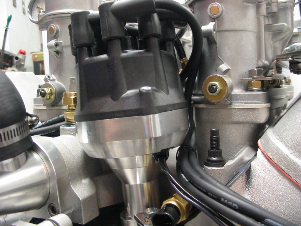

My actual Distributor will not clear the new Weber intake.
it still needs about 10mm to fully sit. So a distributor with a 1/2" taller lower housing would be ideal.
My disszy is MSD# 8579 and runs perfect. Called MSD an they say they do have taller ones but not with the small diameter disszy cap.

Can you not trim the intake manifold &/ or dizzy body to allow fitment[ be careful around intake front coolant passage ], might require reposition of plug leads in cap to find a 'sweet' spot for cap retainer lugs, I am not sure if you have manifold in correct position as no bolts appear to be fitted. MSD do make stand alone -'Ready To Run ' dizzys , these dont require the 6AL box, these are smaller diameter in body & cap, just remember to get it with the gear to match the camshaft material type.

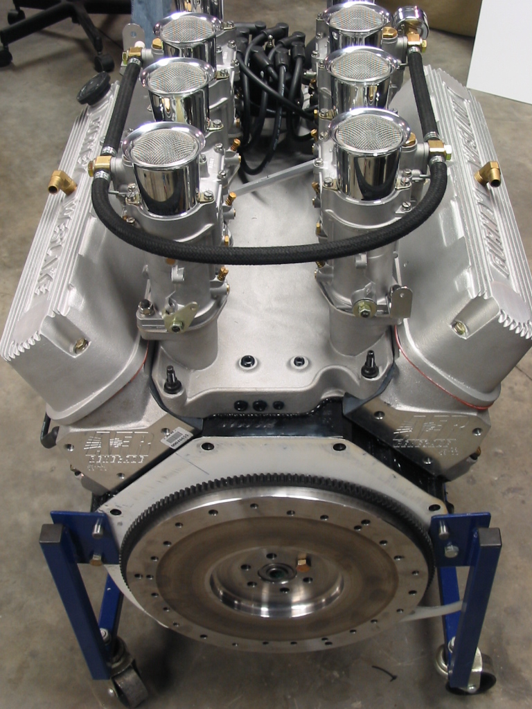

Tom,
I took some pictures for you.
I have the MSD 8579 as well.. We did have to polish off about 1/8" of material on the intake, but it fits well now..
Comparing pics, I suspect we have different manifolds. The weber seem to be spaced slightly wider on mine, which may be why the dizzy fits. Snug, but fits. No grinding was needed.

Manifold is in correct position, four of the center bolts are fitted to glue on the gaskets for portmatching at that stage.
Intake is from PROCOMPELECTRONICS with a vacuum plenum connecting all runners into that plenum.
Just grinding of some material of both parts would no get enough clearance, only a severe cut and reweld of the waterpassage would do.

Yes caps are same , but bodys are different-see attached pics....re the pro comp comments, yes I agree, wont use anything of theirs, just too much hassle & hopeless to get satisfaction from them in my part of the world.
Finally got my 8579 fit. Thanks to Randy and Mike. Mike you made me aware that basically what i have has the same shape as an Inlese/Pierce intake ( thats also the reason i bought the procomp because it looked so similar) and if Randy made his one fit with a bit filing here and there, i figured why not trying the same. So out the grinder comes and i have a nice 2mm gap now with the disszy fully seated.
