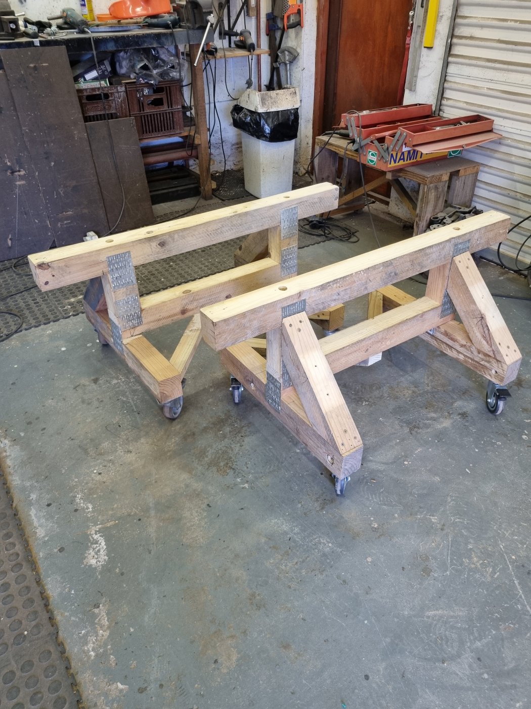

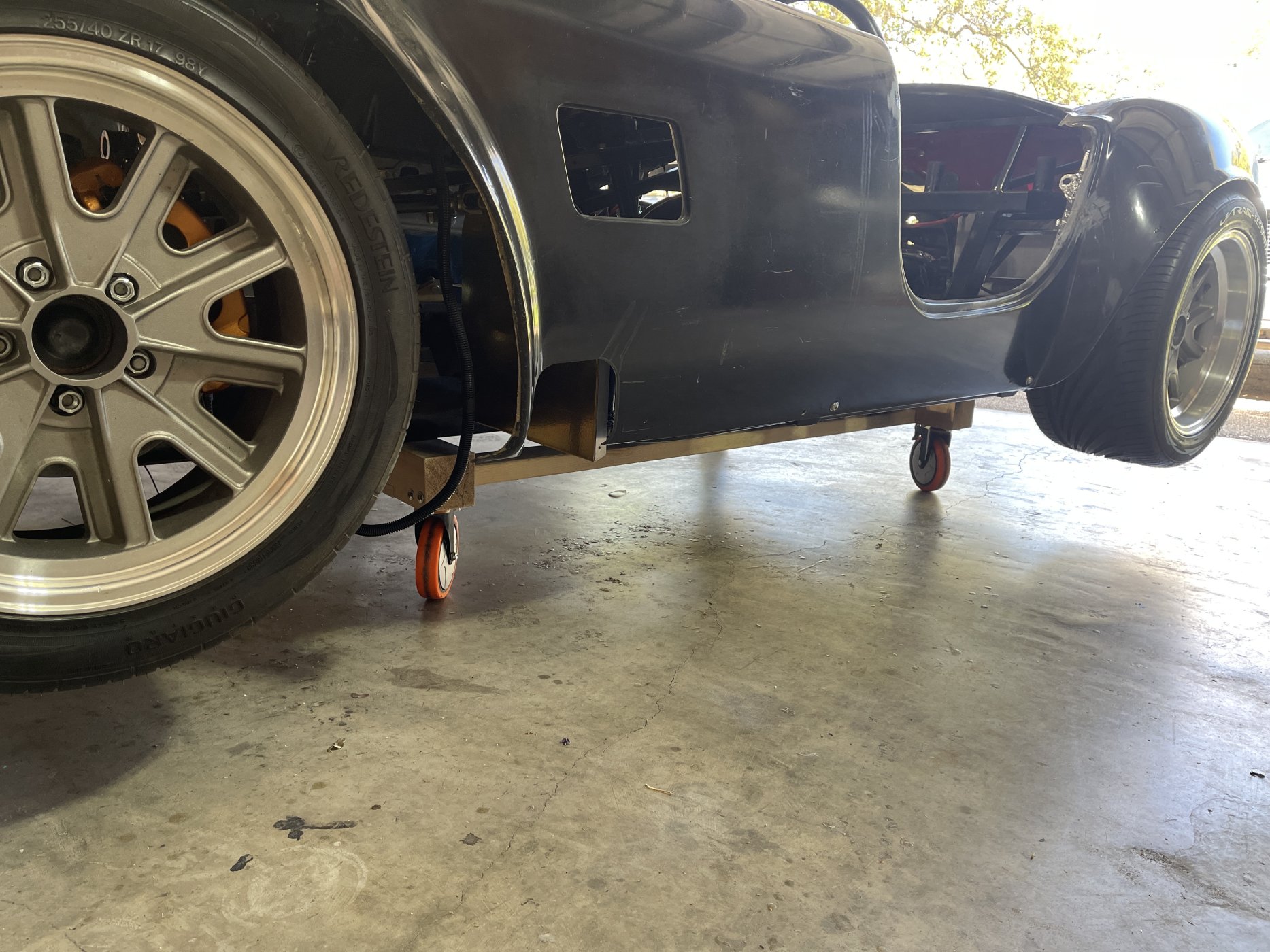

RCR informed me that my order is nearing delivery :) In anticipation, I want make a chassis dolly like the one pictured under my basket case FFR Cobra replica.
Can someone please provide the dimensions of the main tub? Thx much.
The dolly is made up of 4X4s with 6” castors. It works out to be a convenient height of 10” off the floor.
I can't give you exact dimensions, but will tell you that the type of dolly you have under the Cobra will not work under the GT - once you have the engine and transaxle in it. The GT becomes very tail-heavy. I'll see if I can find photos of the dolly we made and post them later. There was a support that went to the back of the car to the transaxle.
Randy Folsom
Randy, thx much for the guidance. Looking forward to seeing the photos. I was thinking I could place another, small footprint, dolly underneath the engine/transaxle when they are installed. That will also provide more wheels to share the load.

I made one the same as Randy's but out of steel but 14 inches high but still a bit tight using a creeper, a couple more inches would be better. It worked very well for the GT40 as well as the Cobra

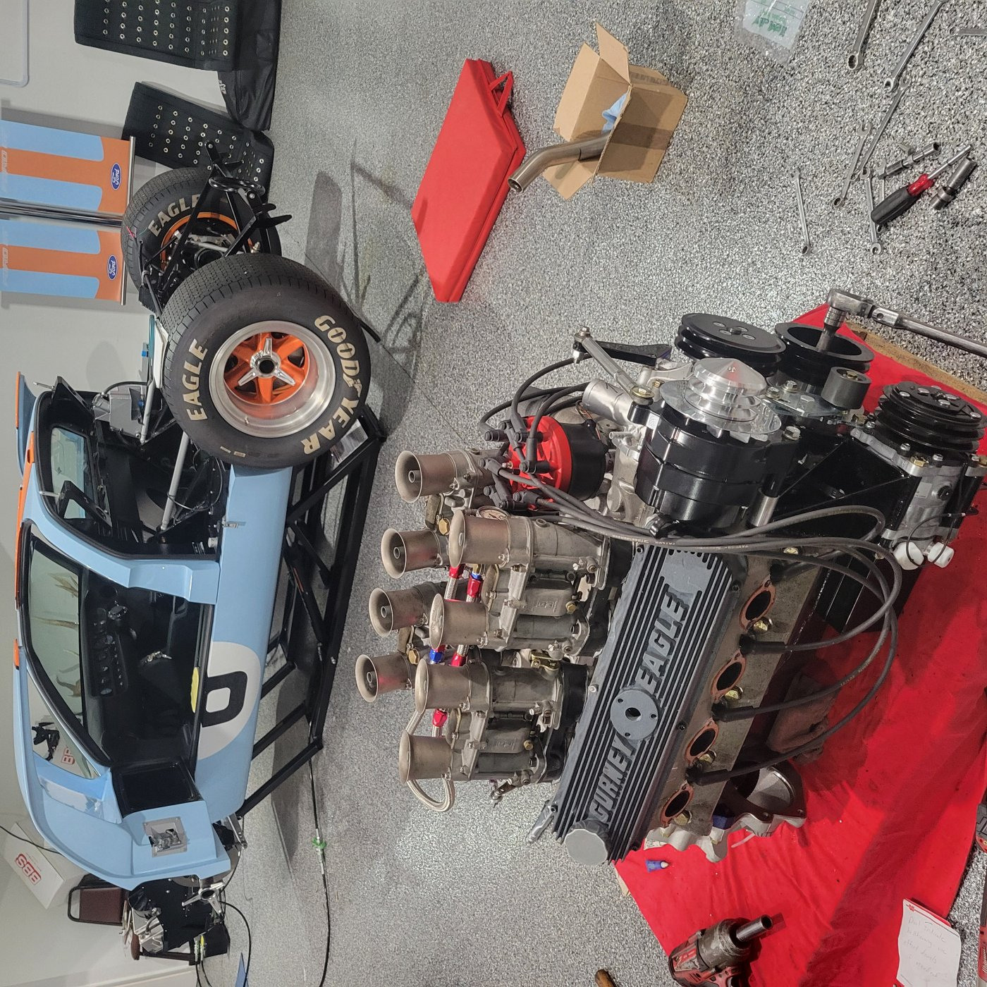

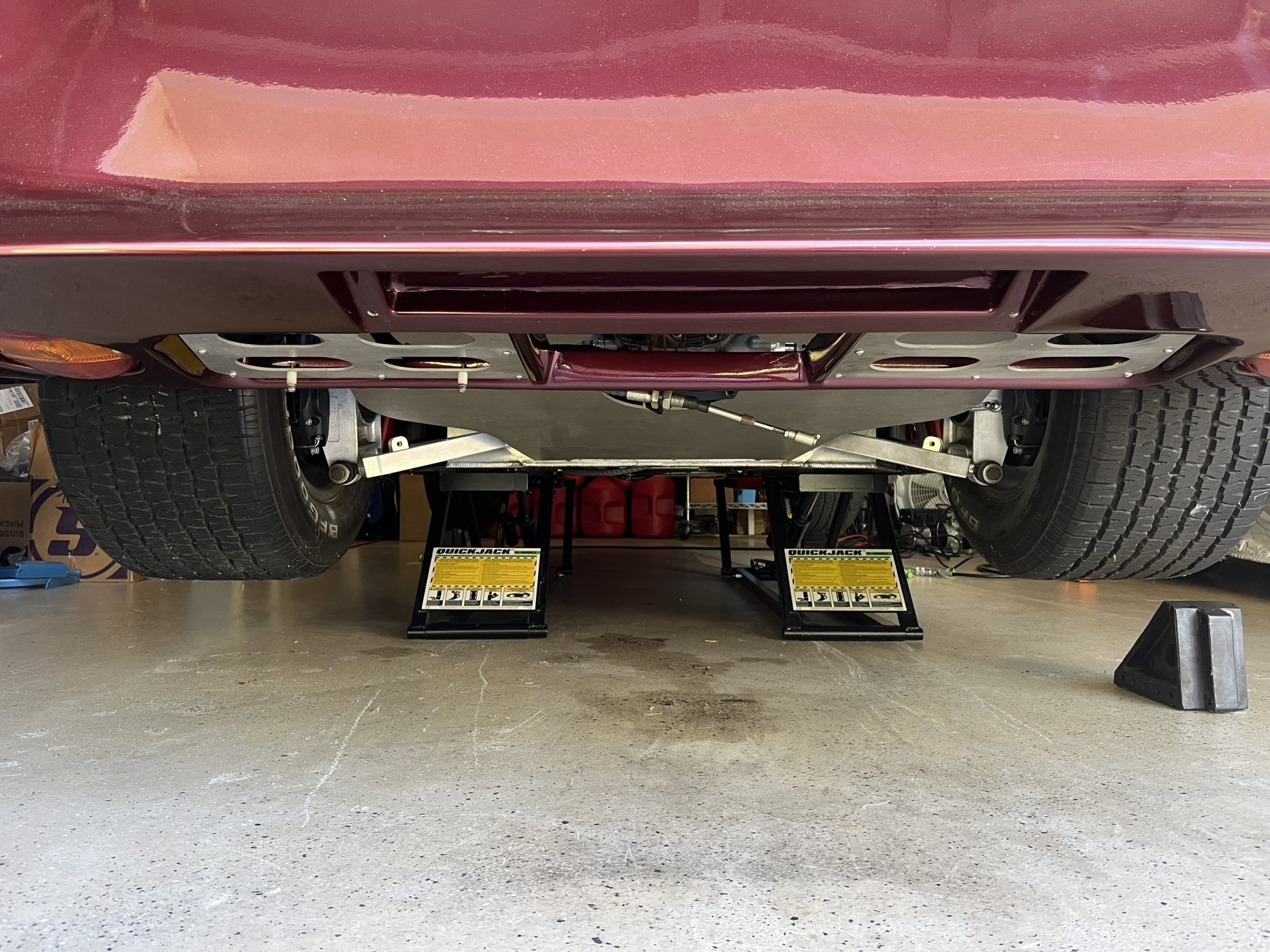

Randy, FWIW, l currently have my car up on Quick Jacks. They measure 5’ long and they are spaced approx 38” apart to the outer edges. You can get an idea how the car is positioned from the photos.
I removed the engine and transaxle while it was up on the QJs, and it’s very stable either way.
Being able to get under the Cobra with a creeper would be helpful, but, there’s nothings under the RCR40. That being said, I might opt for four more inches using additional 4x4 blocks to make it more comfortable to work on.

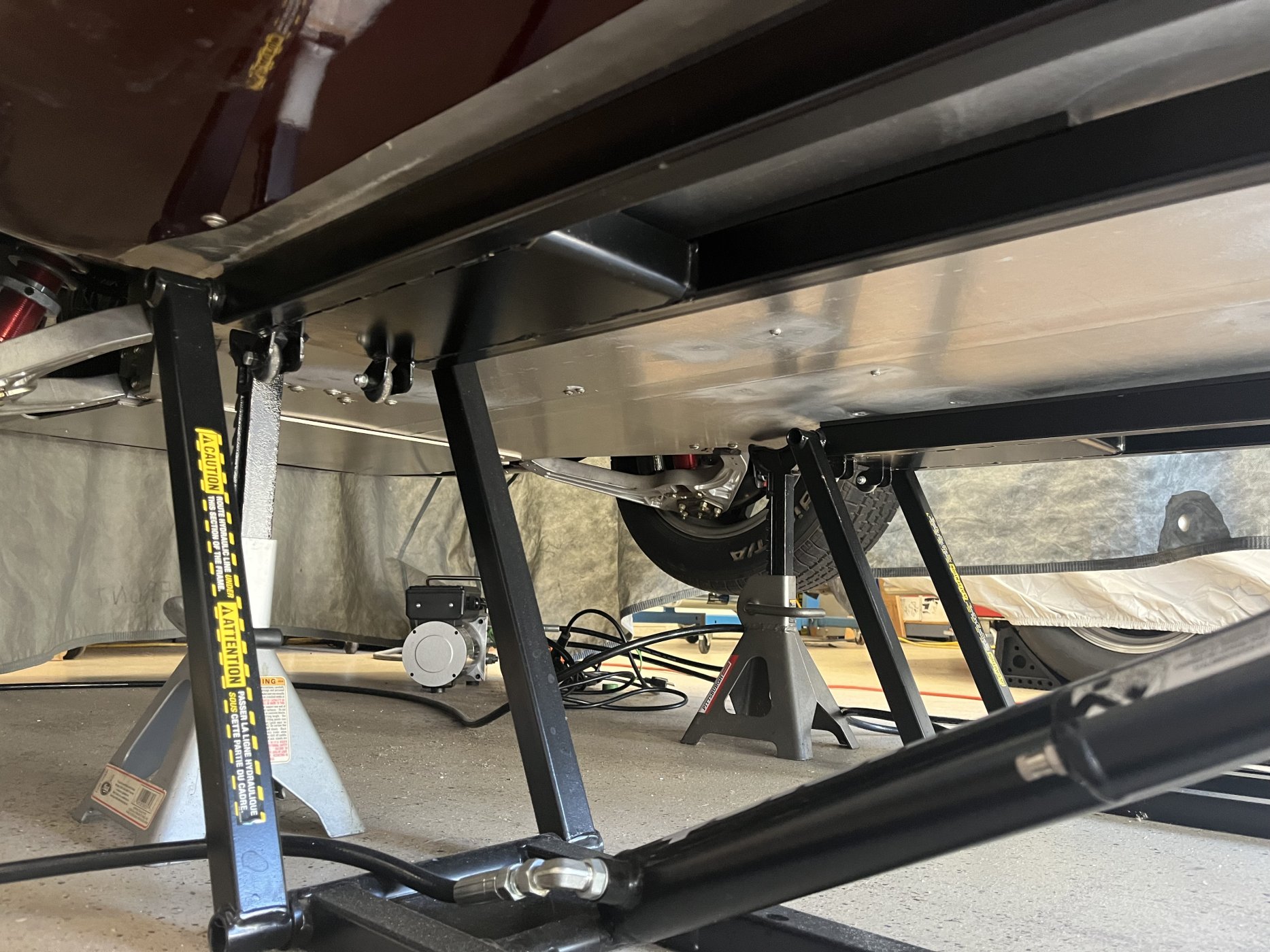

Love My 6K ones and this is it setting on first notch. Perfect for this set up and can set it up anywhere in the shop. Black Friday sale saved 20%.

Btw Randy, the only reason I mentioned the QJs was to provide you with workable dimensions for a dolly. 5’ L x 38” W should be perfect dolly dimensions when positioned as shown in photos.

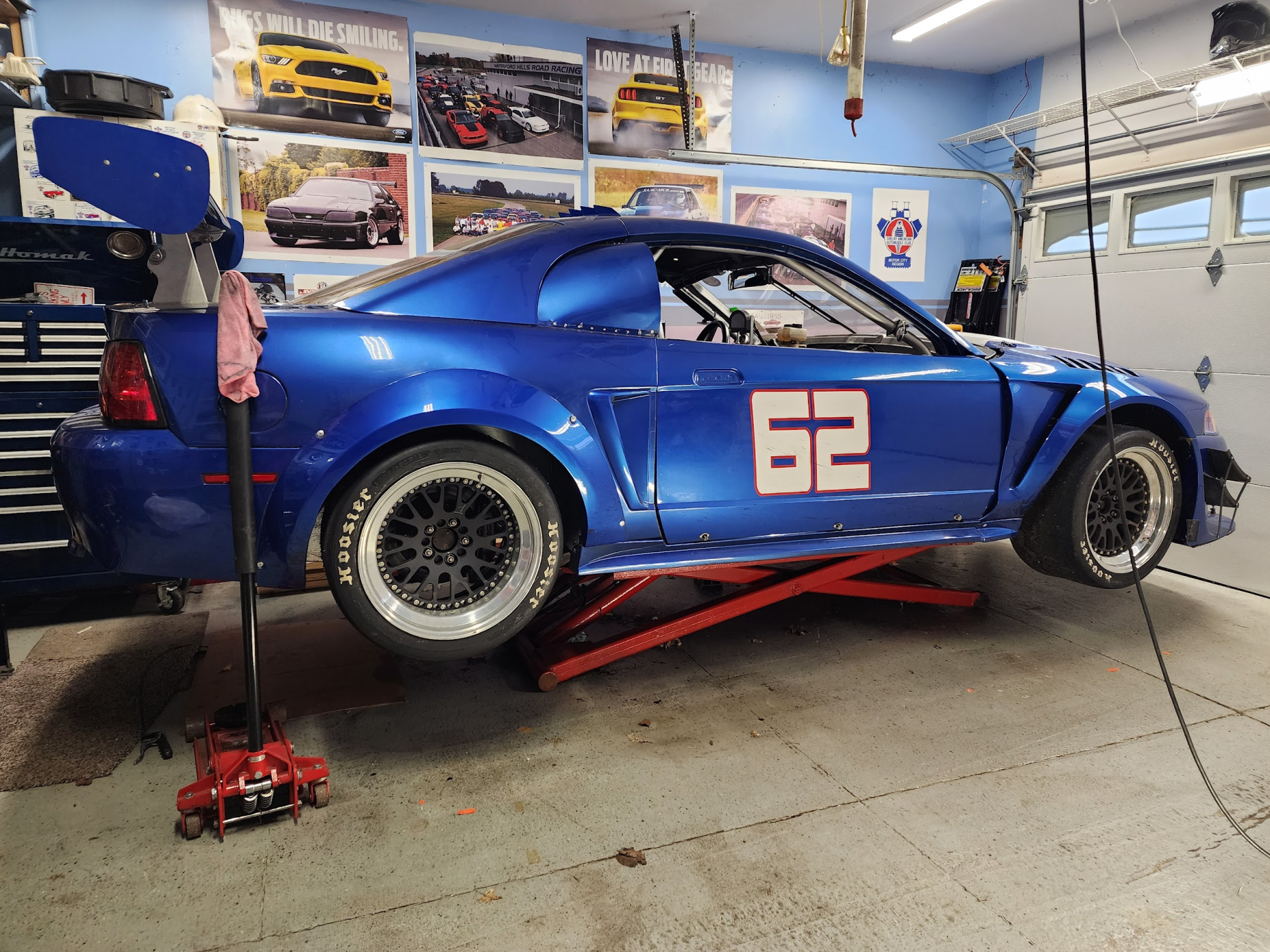

I have a Scizzor-Lift FOR SALE (you can see the QuickJacks in the corner - Dont need both).
VERY heavy and local to Metro-Detroit only. ASKING $600...

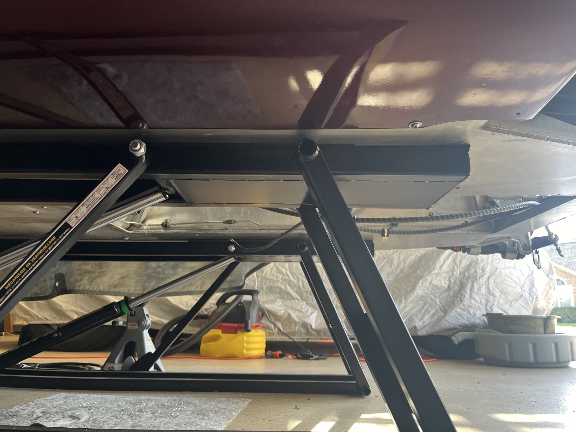

Photo of it raised about 25% of total lift:
