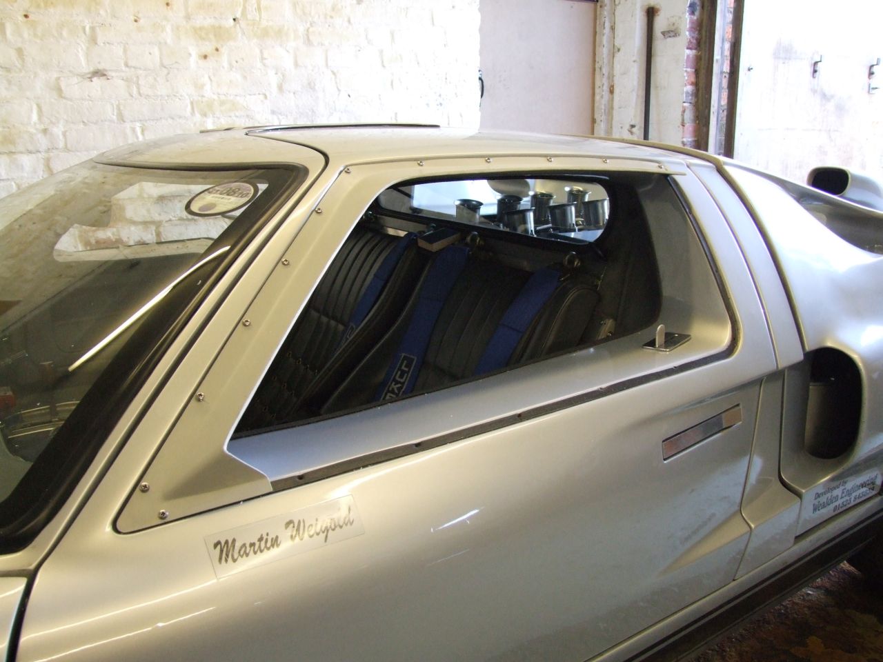

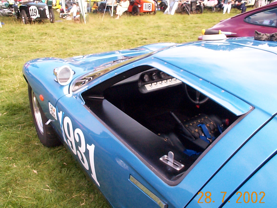

Hi FR&ank
Id this not Martin s car ?
Long time ago
Any chance to buy homemades ?
Grtz and happy new year to you and Barbara !
Best regards
Fred
Hi Fred, I expect I can squeeze one out for you. You will enjoy Spa with that set up, I know I did.
