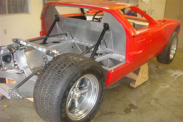

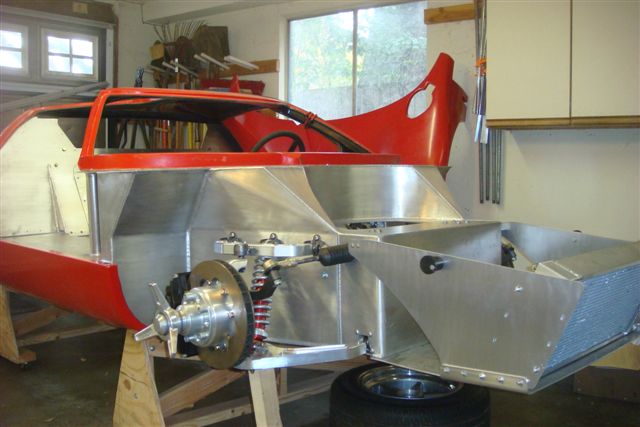

Got my RCR delivered this weekend! (Sort of). It's a deluxe kit+ that was purchased by a gentleman who decided not to complete the project. So, after a Banzai run to California and back, it's now my project!
I need input on one item. The chassis and aluminum panels have all been Scotch-Brited. I'm thinking I want a different type of chassis finish. What's the consensus on re-finishing the aluminum?
The pictures are very kind and do not show the real finish.
My first order of business will be to fit the body panels and make ready for paint. This will include all perforations in the fiberglas, window trimming/fitement, etc. Once done, on to the chassis.
Thanks.

Do you just not like the look of brushed aluminum, or is the issue it was done quite poorly? I find that if you wetsand up to 400 (so 150, 220, 320, 400), then finish with a red (maroon) scotchbrite pad it looks killer. Of course you want to make certain all your grain lines are even, otherwise, well, it looks like crap :laugh:
I like powder coat (satin black, or a very dark blue similar to the original's)...
Brushed does look killer, but it's a pita to keep up. Try going over a section with the red scotchbrite using mineral spirits, like you would use water when wet sanding...
Here's the problem with the chassis the way it stands right now; the Scotch-Brite finish looks more like it is a scrubbing vs. a finish that would be permanent.
I'm not against the brushed aluminum finish, just this one.
At this point I would not even be happy painting over it as is; I think there would be a lot of the marks showing through the paint finish.
At minimum I have to DA the entire chassis before painting, or DA it all to remove scratches, then work my way to a polished finish with increasingly finer abraisives.
Suggestions.
fyi, you can seal it with Sharkhide - it's a rub-on clear-coat type product (dissolved with acetone/MEK) that keeps it looking like new for (supposedly) 8-10yrs if it's out of a marine environment (2-3 in a marine (salt water) environment)
I've got several brushed pieces I'm playing with right now. Sharkhide is invisible; now the problem I'm running into is my brushed pieces arn't even (sometimes deeper sanding scratches, etc...), but once I get it right, it looks killer.

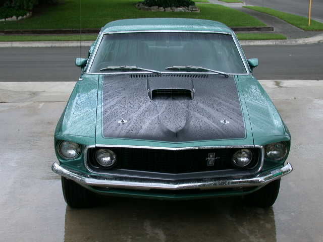

Hey....how about some pics of the stang...!! :thumbsup:
Rob, I am considering the brushed look - took a scuff wheel to an area today to see what it would look like - no decisions yet.
Tell me, on the sequence; A/C, duct plenum, roll cage, dash, spider, then body panels? I'm a little freaked about the initial fitment of the front & rear clips, the spider, and rockers.... jitters I suppose.
Here's a few of the '69.

Beautiful '69 Fastback!!! I want one of those so bad I can taste it. Absolutely my favorite model Mustang Ever! Congrats on the new acquisition of the GT40. You'll enjoy building it I'm sure. Oh and welcome to the forum.
