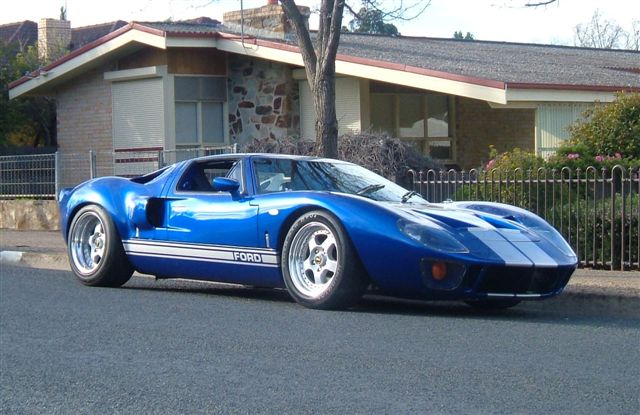

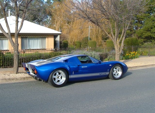

Well here's another DRB on the road. Finally registered in South Australia. I think the first one here.
Registered here with standard 5.0L HO 1989 Mustang motor and EEC-IV.
Its taken me a while but finally the project is finished.
You can see in the attached pics that its sitting a little high - this was to keep the minimum 100mm ground clearance, so i pushed it up to about 110mm just to make sure.

Great accomplishment and beautiful color - well done!
Hi C
Looks beeaauutiful. what wheels did you get as they look like the ones i have been chasing for my drb17 although in a different colour.

To answer some of your questions. The wheels are Simmons, F90 - and I matched the silver stripes over the body to the centre colour of the wheels. A small touch but makes a difference. The colour is from the Nissan 350Z. Simmons have the specs required for the DRB setup. ie required offsets etc.
