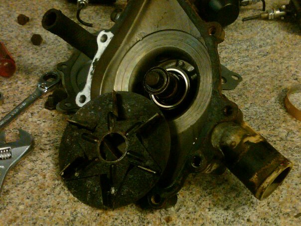

Second one spun the impeller on the shaft. DO NOT BUY EDELBROCK ALUM WATERPUMPS.
This kind of stuff just pisses me off. I don't rev my motor above 6K and usually shift at about 5500. That's two pumps in about 15000 miles with about 20 track days at about 3000 miles at the track total.
I would say that each was good for about half of the total run time.
Pump in question Edelbrock # 8842
Alum Victor Series short R/H inlet 5/8" shaft BLA BLA BLA.
If you have one WATCH you temp gauge!!! Better yet take it out and pitch it in the garbage!!!!!
Got home OK, no other damage. But here's goes a wasted weekend and a couple of hundred dollars.

That won't do it. Mine didn't just slip and come off, it sheared off at the stamping where it bends and gets pressed on the shaft. The part of the impeller that fits on the shaft is still secured attached to the shaft.

The problem is the interference fit on the shaft isn't tight enough and with time the impeller just turns. Simple but that's it. It should be splines or keyed, simple again, but they must think that it would cost too much money per unit. Fuckin bean counters again.
Welding the impeller onto the shaft would work but the impeller is made of cast iron and the shaft is a really hard tool steel. Cast iron can be welded in the book but not so much by me. I tried to weld the first one and had a little success but oped for a new unit instead. Not this time.
It is just a bad design. The thing is, the rest of the unit is nicely made. Even the impeller is a curved vane thing that looks the part. Not the stamped sheet-metal piece that screwed Ron. It's too bad really. One more step, either splines or keyed shaft and it would be fine.
When I get the piece out of the car I'll post pictures AGAIN!

To be clear, my failure was not the Edelbrock pump but the Ford pump that is commonly used in hot rods and GT40s. Stamped steel "impeller", definitely a POS.

I should also say that there is no cracking in my impeller. It just spins on the shaft and doesn't pump water.
