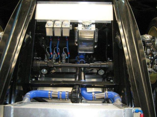

I am using a Meziere pump up front in my car, and I have been trying to be sure I have done things OK, so I think I will ask here:
(1) I have the pump up front, low pressure side of the radiator, and I have an in-line Nascar style thermostat that I put back by the engine thinking it would open faster. It has a -6 AN bypass line that is 6 feet long and comes through the center tunnel to dump in right behind the pump.
I am thinking about moving the thermostat to the front of the car. If I do that, I will have a -6AN bypass line that is about 1 foot instead, but the thermostat will be 6 feet from the engine (doesn't seem to bother anyone here).
Meziere had just said to run it without a thermostat.
(2) I am running a bleed line from the upper corner of the radiator back to the tank. I already have a similar bleed line from the top of the motor to the tank. Can I use a T-fitting at the tank, so that these will essentially connect as they go into the tank (easier packaging in a tight space) or do they have to go into separate inlets on the tank? I am using Meziere expansion and recovery tanks.
(3) Lastly, as I mentioned, Meziere tanks. Both are 28 oz. Is that going to be enough volume for this cooling system?
Thanks a bunch gentlemen.

Just a comment on your thermostat placement. If you're trying to control outlet temperature from the engine in the conventional way, I would place it as close to the sensing point (engine outlet) as possible. There's already so much "thermal inertia" or lag in engines that coolant temperature control is difficult enough as it is without introducing more.
The variable speed pump control goes a long way toward addressing this, but it's still a new concept, much like variable speed electric fans were 5-10 years ago.
That was my thought in putting the thermostat at the back. But it means a long small bypass line if the pump is up front. Can't do a bigger line, not enough room in the tunnel.
Why bother with a mechanical thermosate and all the plumbing when you can just use the Digi controller for the waterpump? Mine keeps the car cool and I set what temp I want the engine to run at from 75 deg C to 95 deg C. It also cycles the thermo fans aswell.
JohnC
Missing a few cylinders
Ditto, I'd be tempted to eliminate the 'stat and bypass line and go with full variable speed control of the pump. You've already made one "pioneering" choice by eliminating the mechanical pump and going electric; why not go all the way :thumbsup:
BTW, I think your choice of pump placement is great. Putting it at the radiator, or actually "in" the radiator helps ensure it has flooded suction, and centrifugal pumps always prefer to push fluid than have to pull it.
Can the digital controllers handle the current load requirements of the larger pumps like mine (55 GPM) ??
Also - I'm not sure that all pump motors are capable of running at lower voltages without burning out due to the higher current then required to make them operate..
I put my pump up front so I could make my bypass hose the same size as my other hoses (1.5" and -16)..
