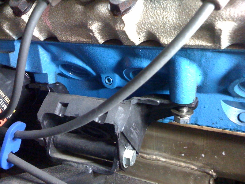

Here's a pic of the mounts in my CAV. I believe they're standard Ford Mustang engine mounts, but I'm not positive.
Speaking of that, does anybody know what kind of mounts these are for sure? Mustang? Sorry for the thread drift here....
ps. please ignore the mount bolt....which was about to finally drop out....
