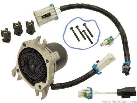

Well that sucks or blows or neither ;)
Then maybe plan B: 2000 Cobra R Mustang electric air pump plumbed to aforementioned header tubes. Ford Part Number F6ZZ-9A486-DA or Motorcraft equivalent Part Number CX1567.They seem to be small enough to put lots of places and for $81 is may be worth a go.
Again, this is so far out of my knowledge base but the idea that somebody gets this far in a build to hit a wall with the bureaucracy has to be maddening.
