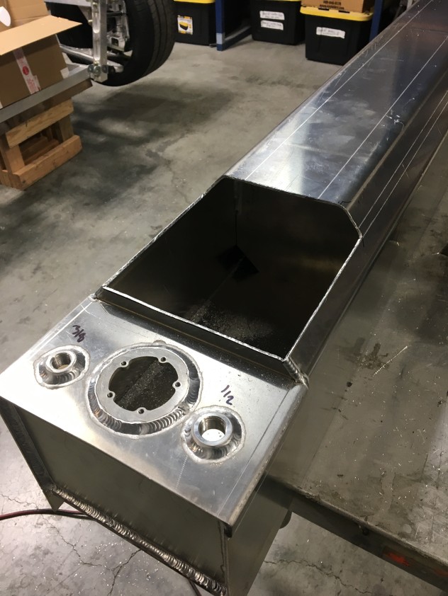

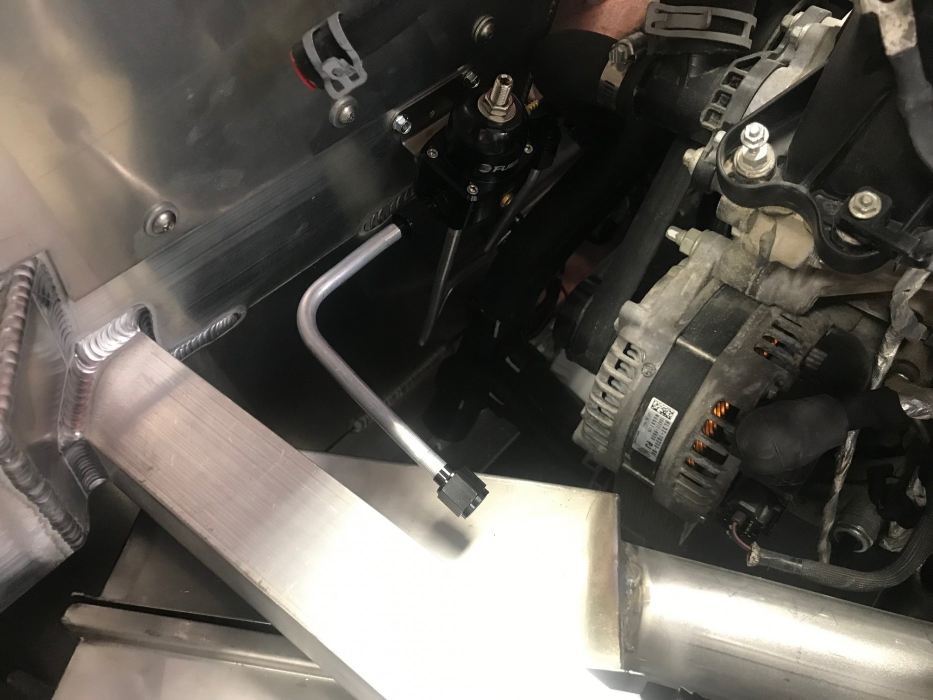

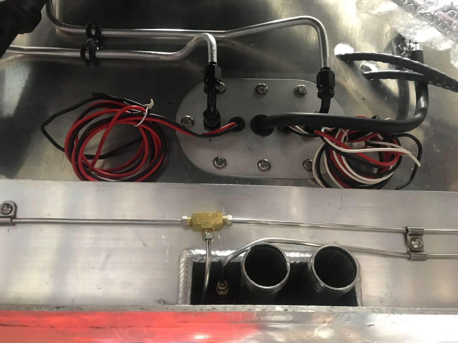

Update Fuel System complete less the back ordered inline fuel filter I had to modify the tank to install an in tank fuel pump, and then everything else fell into place. I installed the Tank's Company in tank fuel pump because of it's reliability and quiet running nature just like OEM. Next onto the Coolant system.

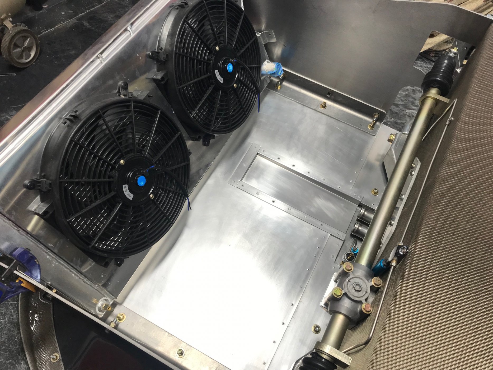

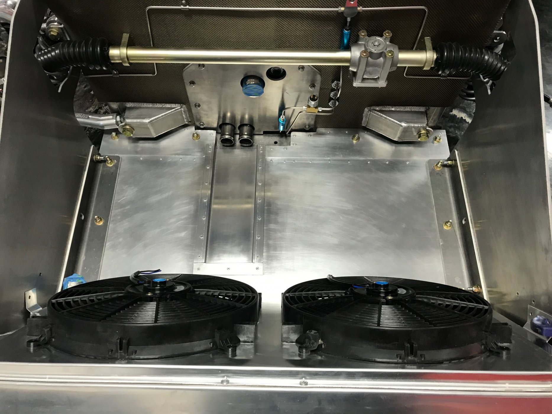

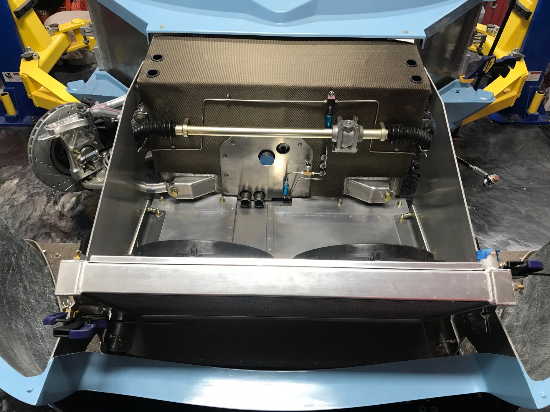

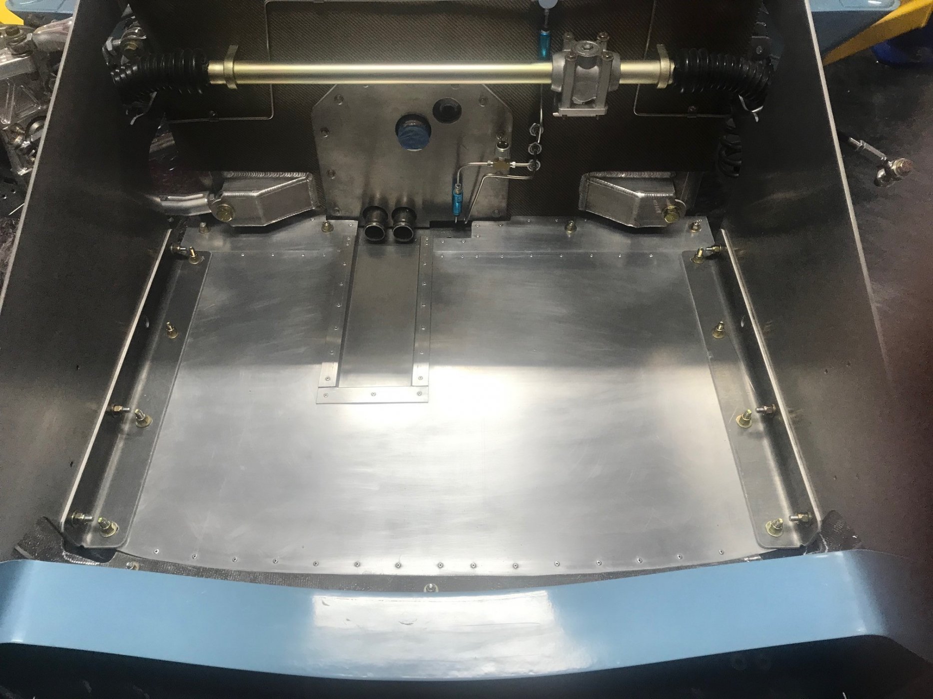

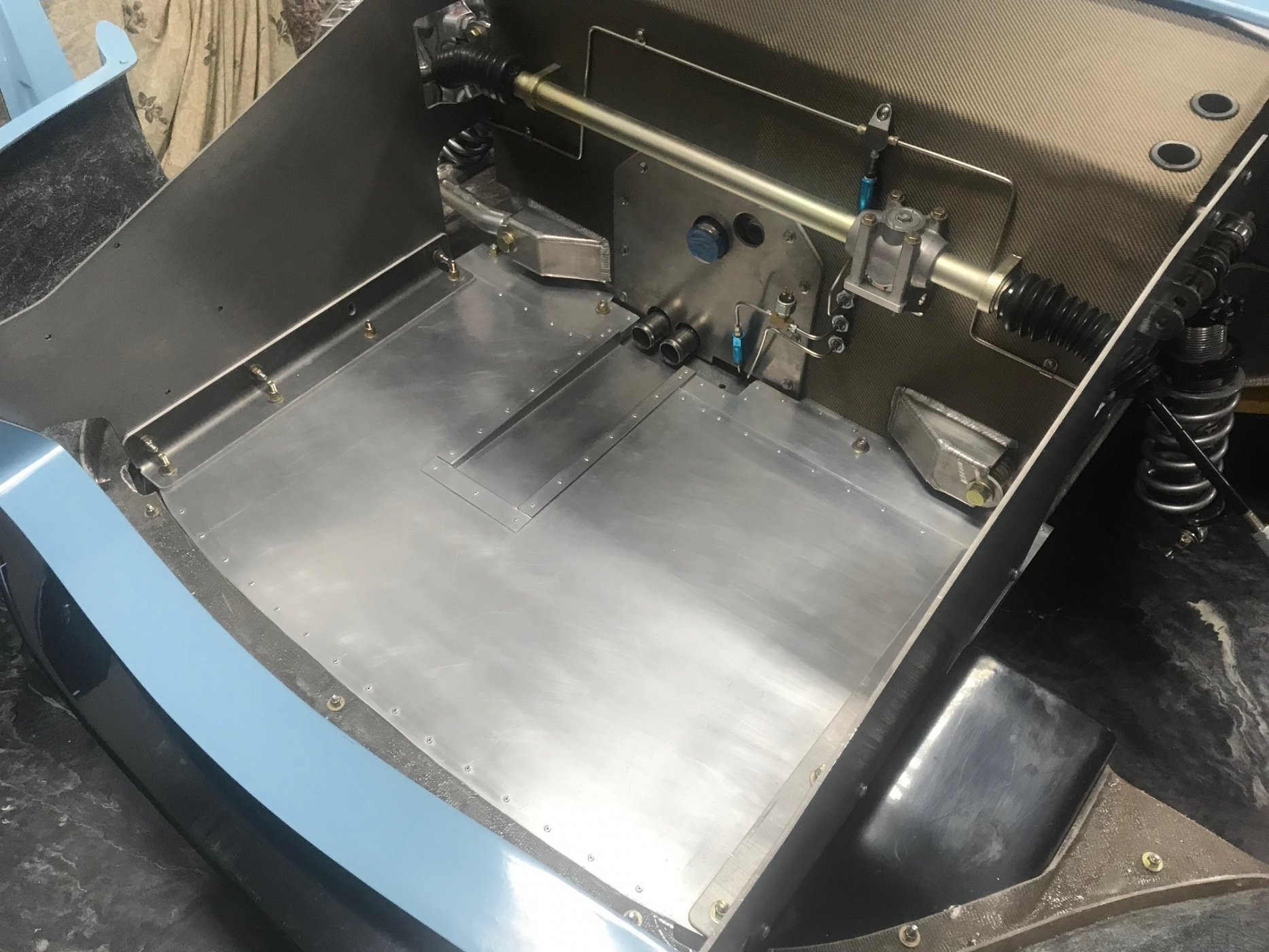

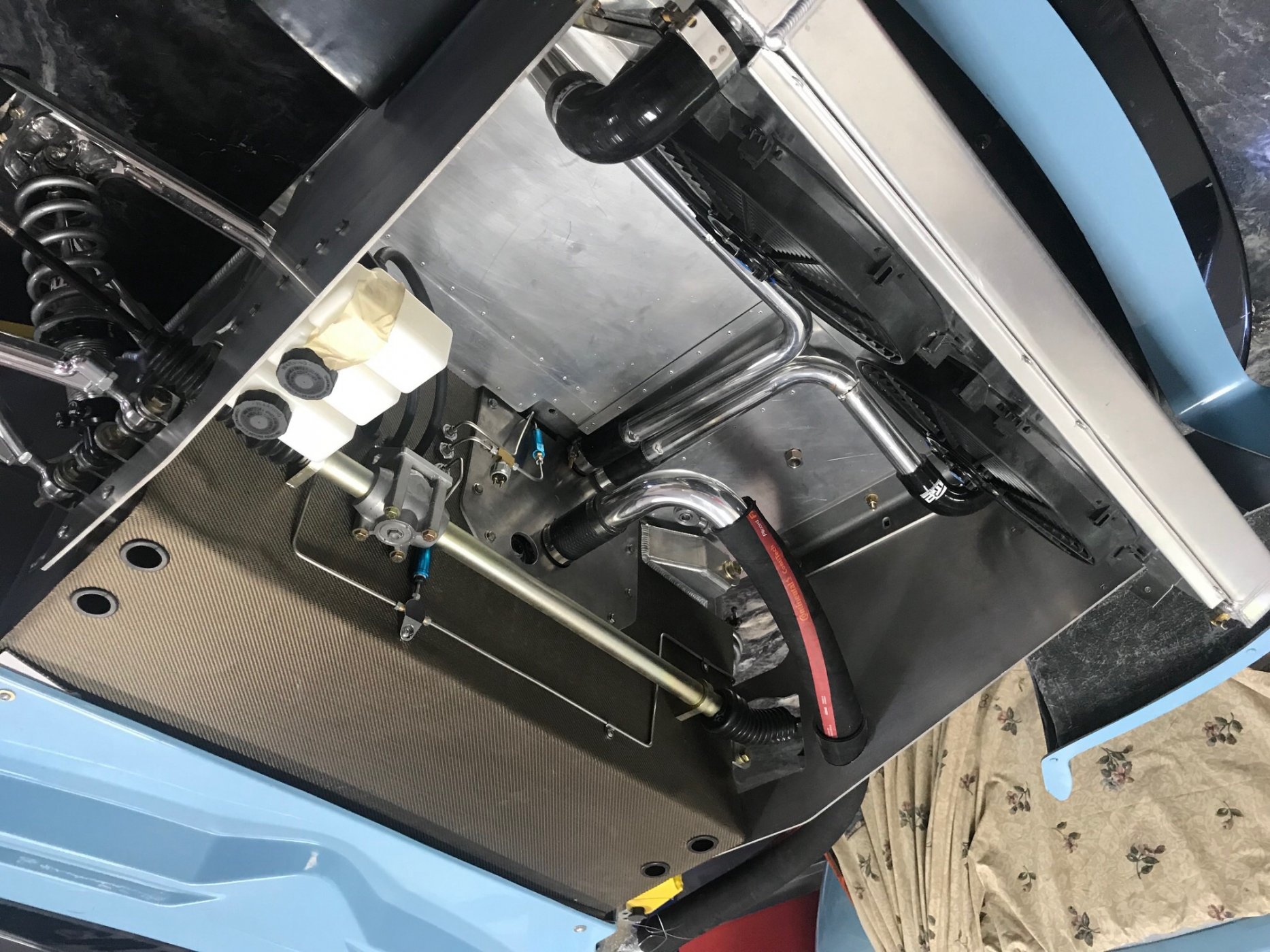

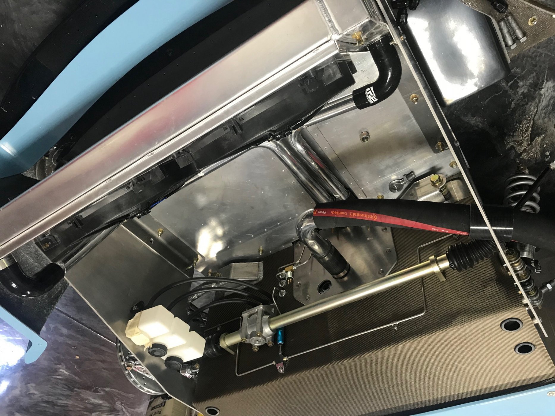

So my weekend was spent fabricating an aluminum look to the front splitter, I wanted to keep the alum look through out the interior front bay of the car. Now I can set the radiator.

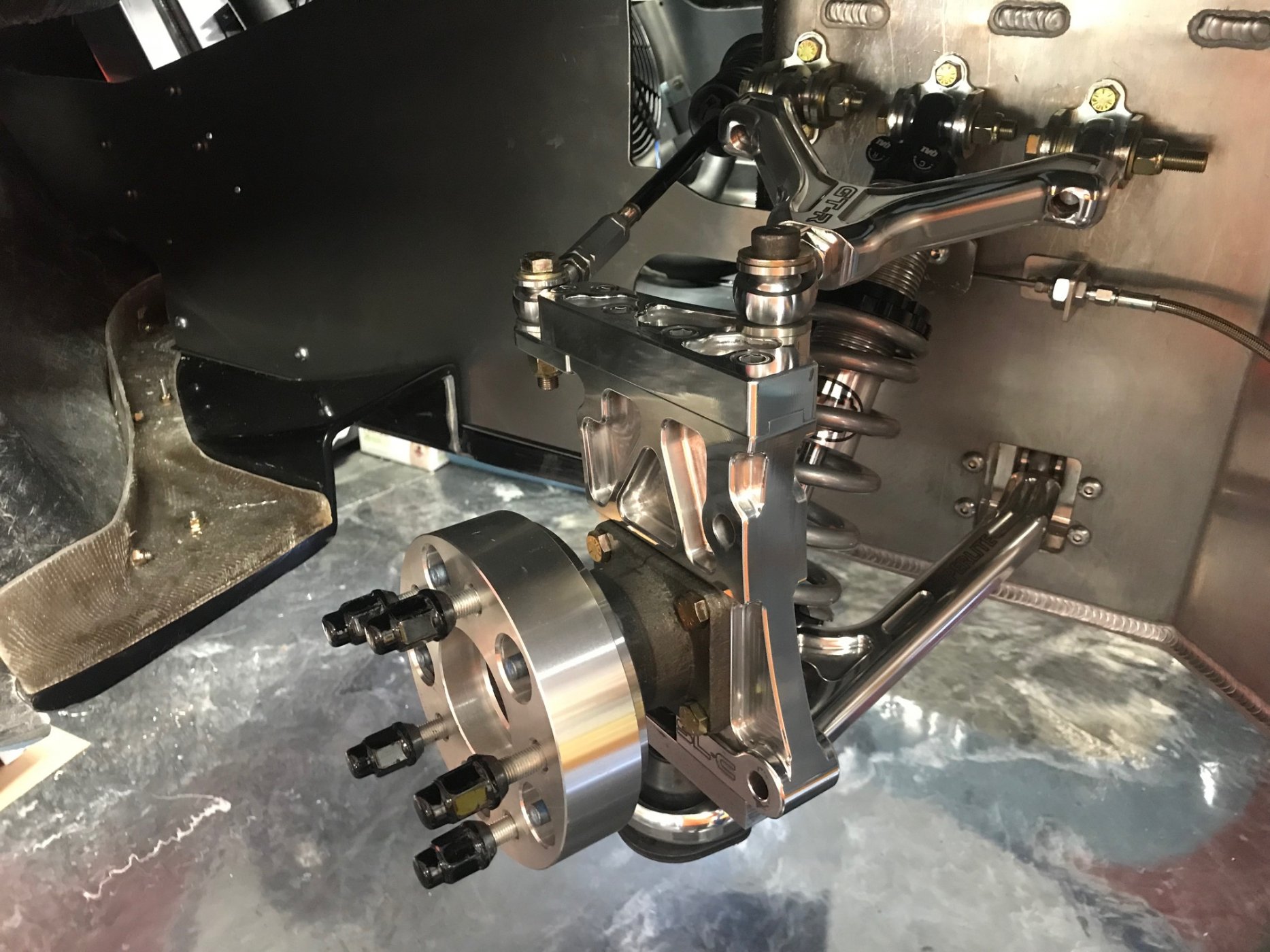

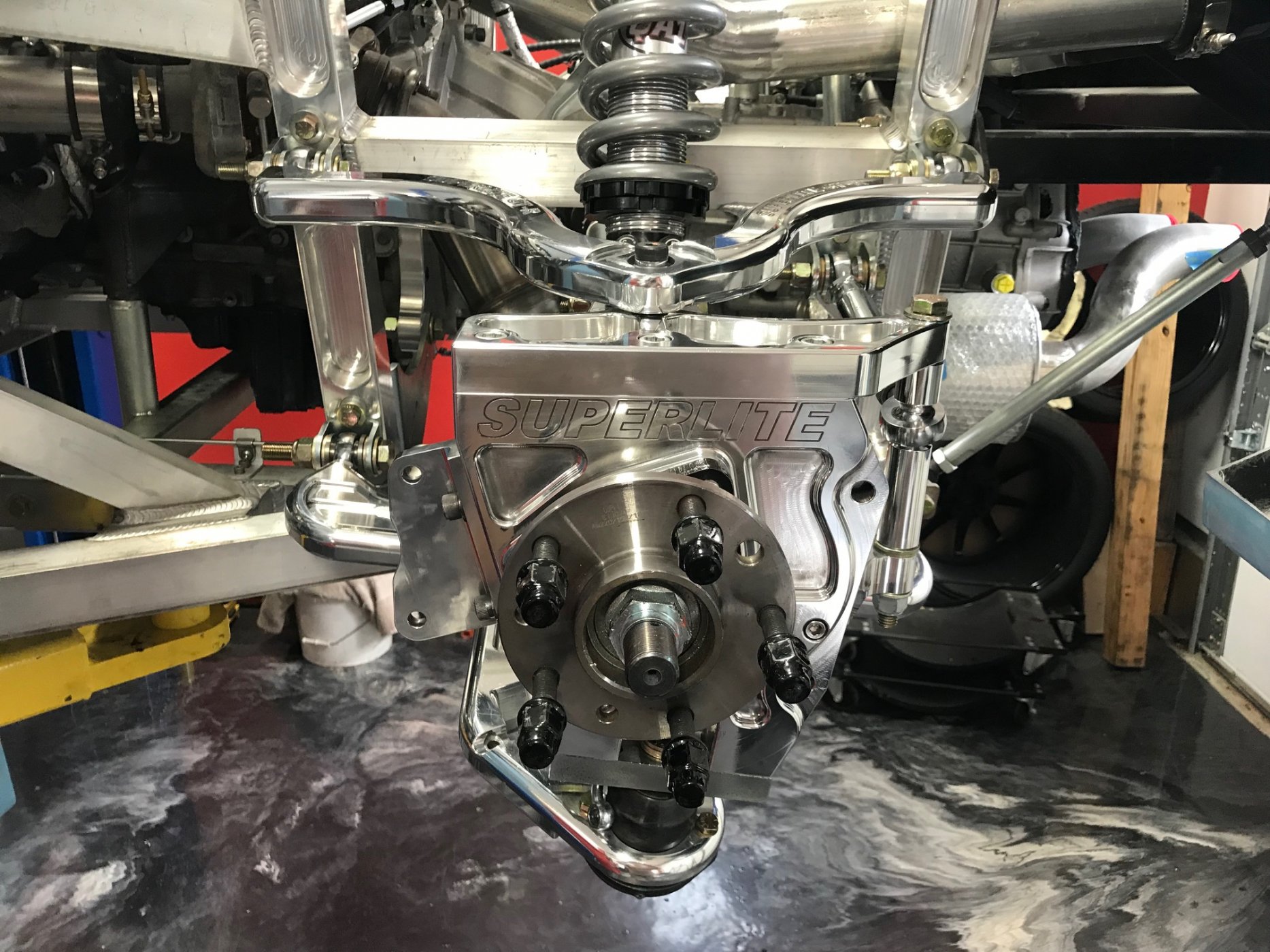

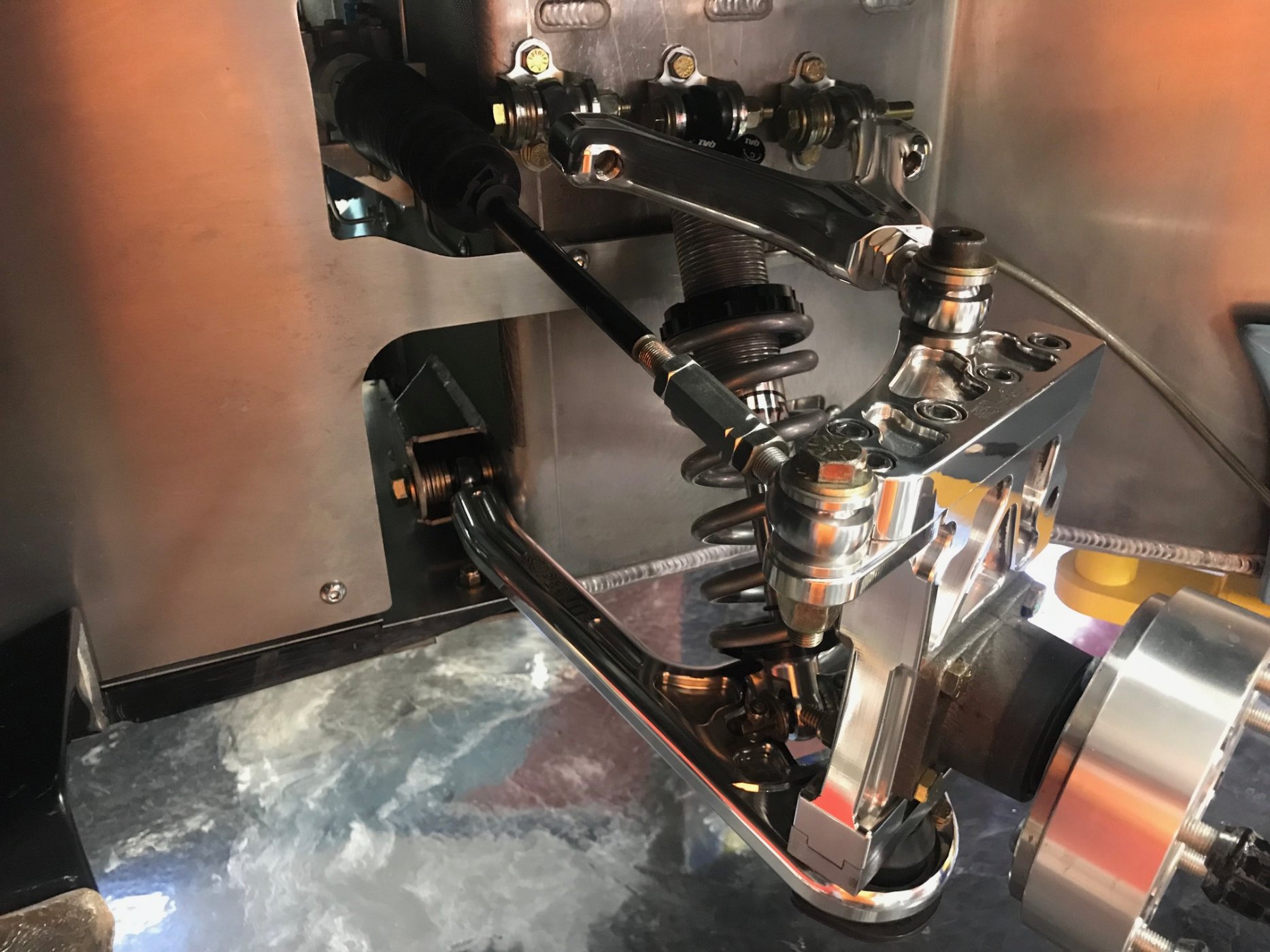

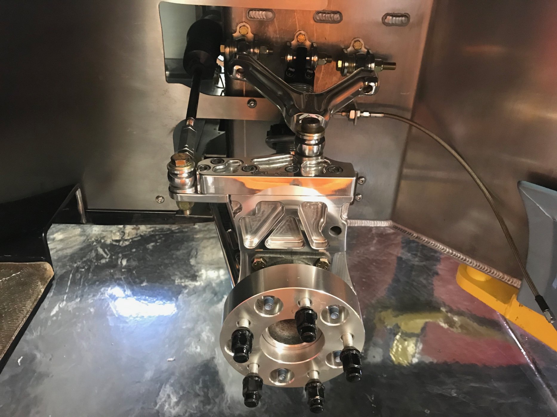

Ok front suspension polished and working on the rear and then powder coat the calipers

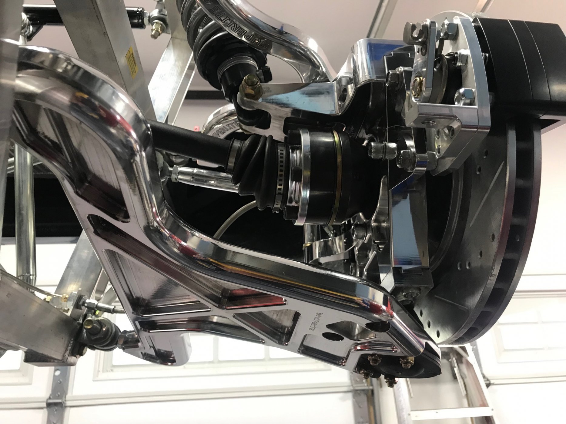

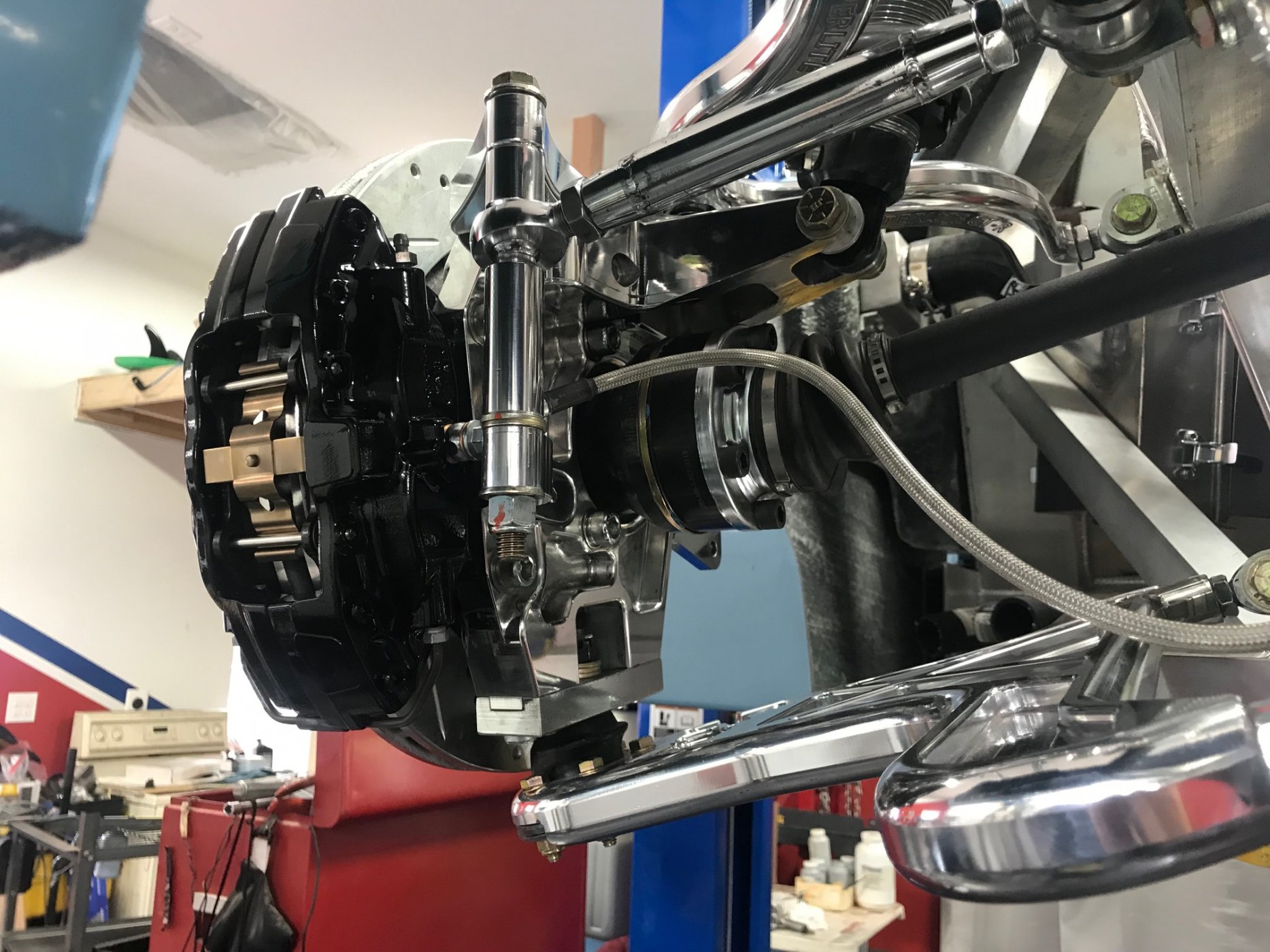

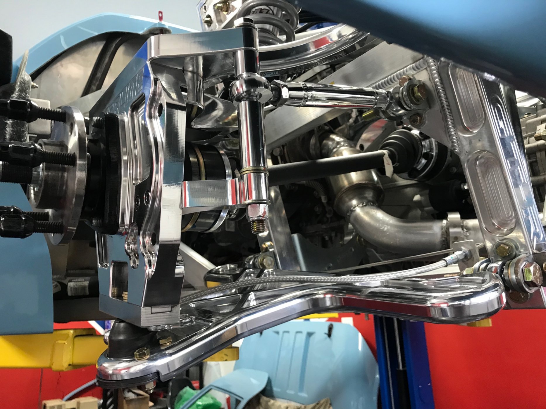

Here is the rear suspension polished now working on powder coating the calipers stay tuned

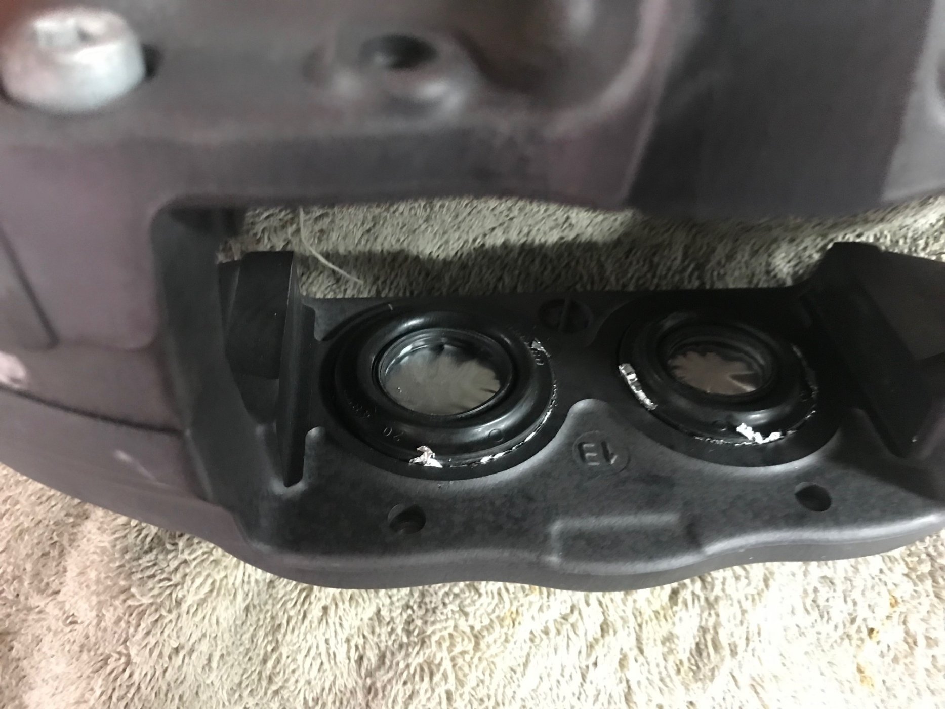

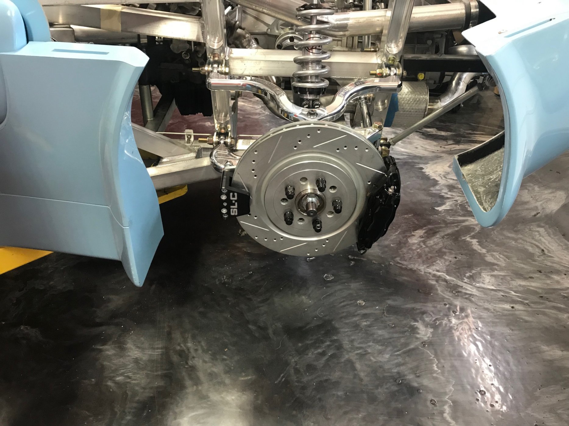

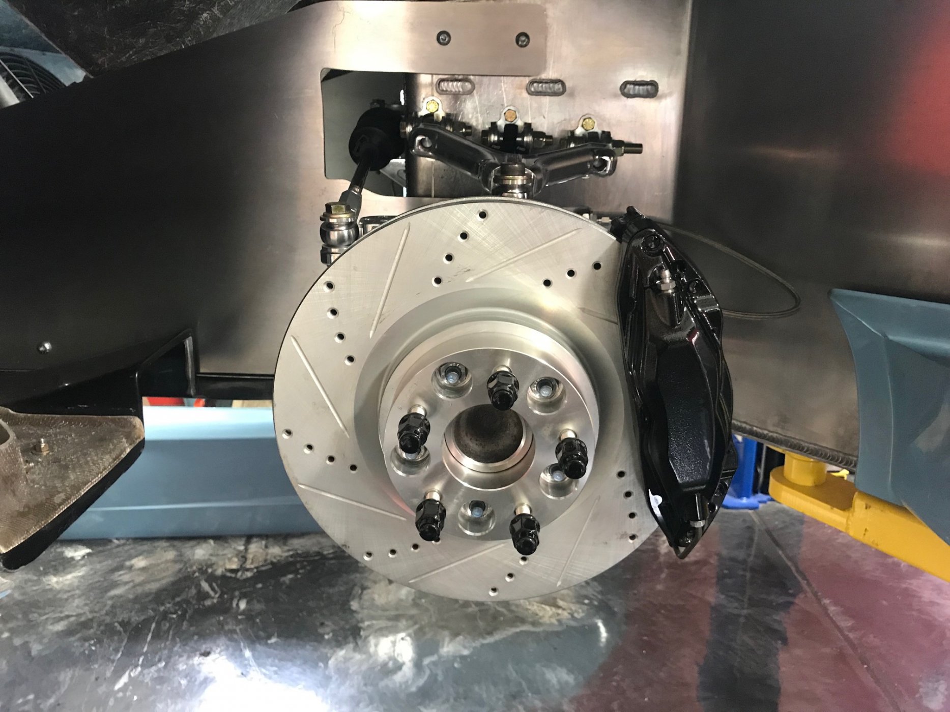

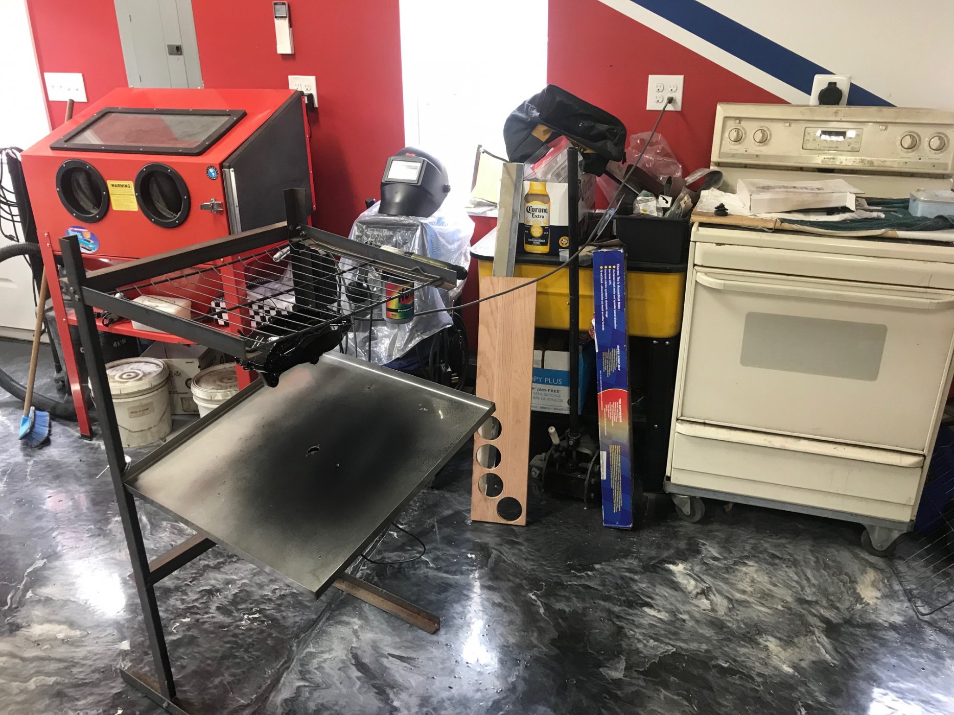

Ok drivers side done now onto the passenger side. Joel I kept the calipers together for powder coating and I used alum foil and the dust boots to block sand and powder from entering the cylinder bores if any sand happens to find it's way in I vacuum it out. I have used the Eastwood powder coating equipment since it came out and as long as your surface prep is done correctly it works great. Now I am just waiting for new Brembo Stickers to come in the mail. I built a small angle iron support fixture to hold the oven tray and the powder coating equipment and to also capture the powder it works great

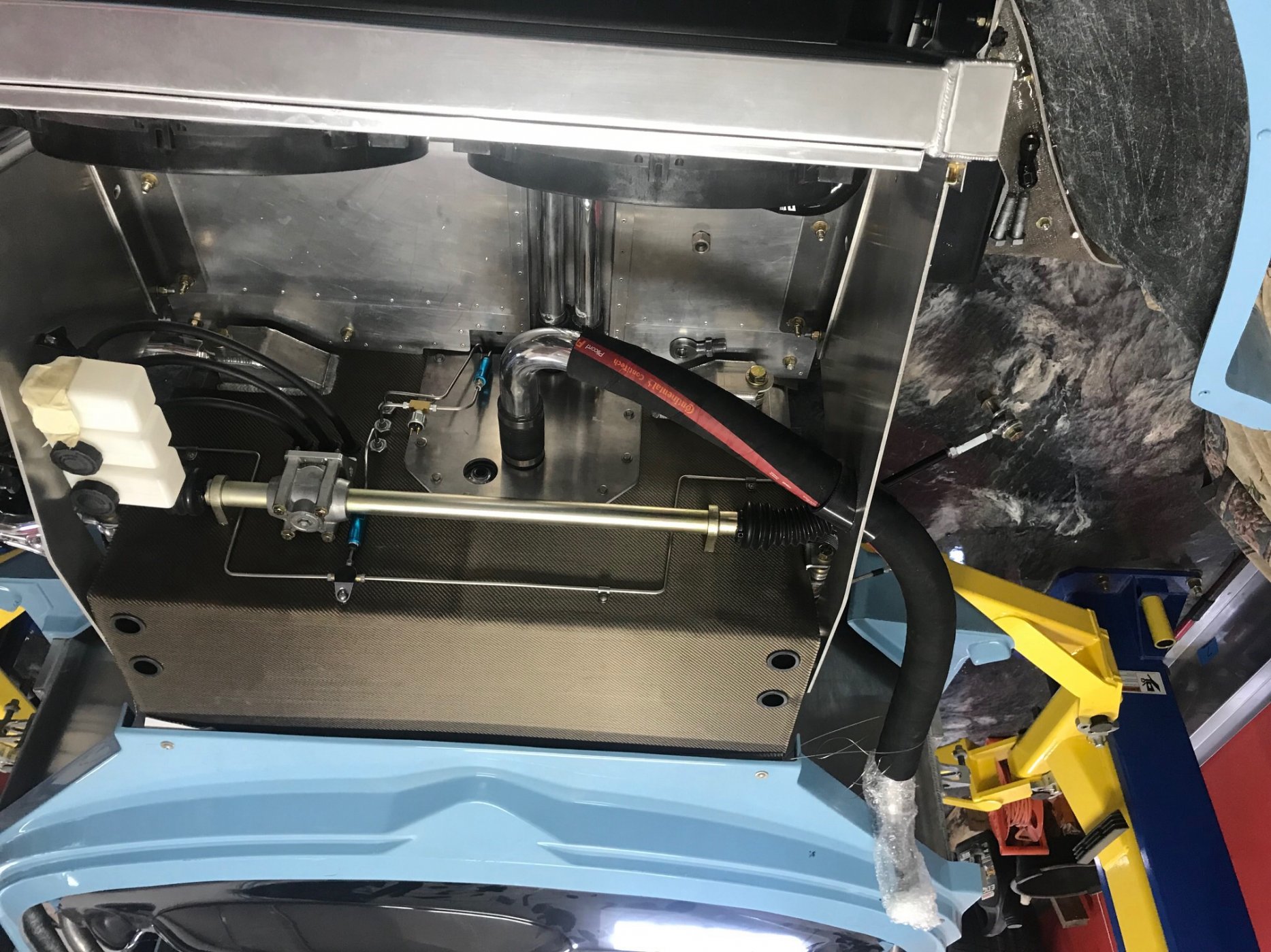

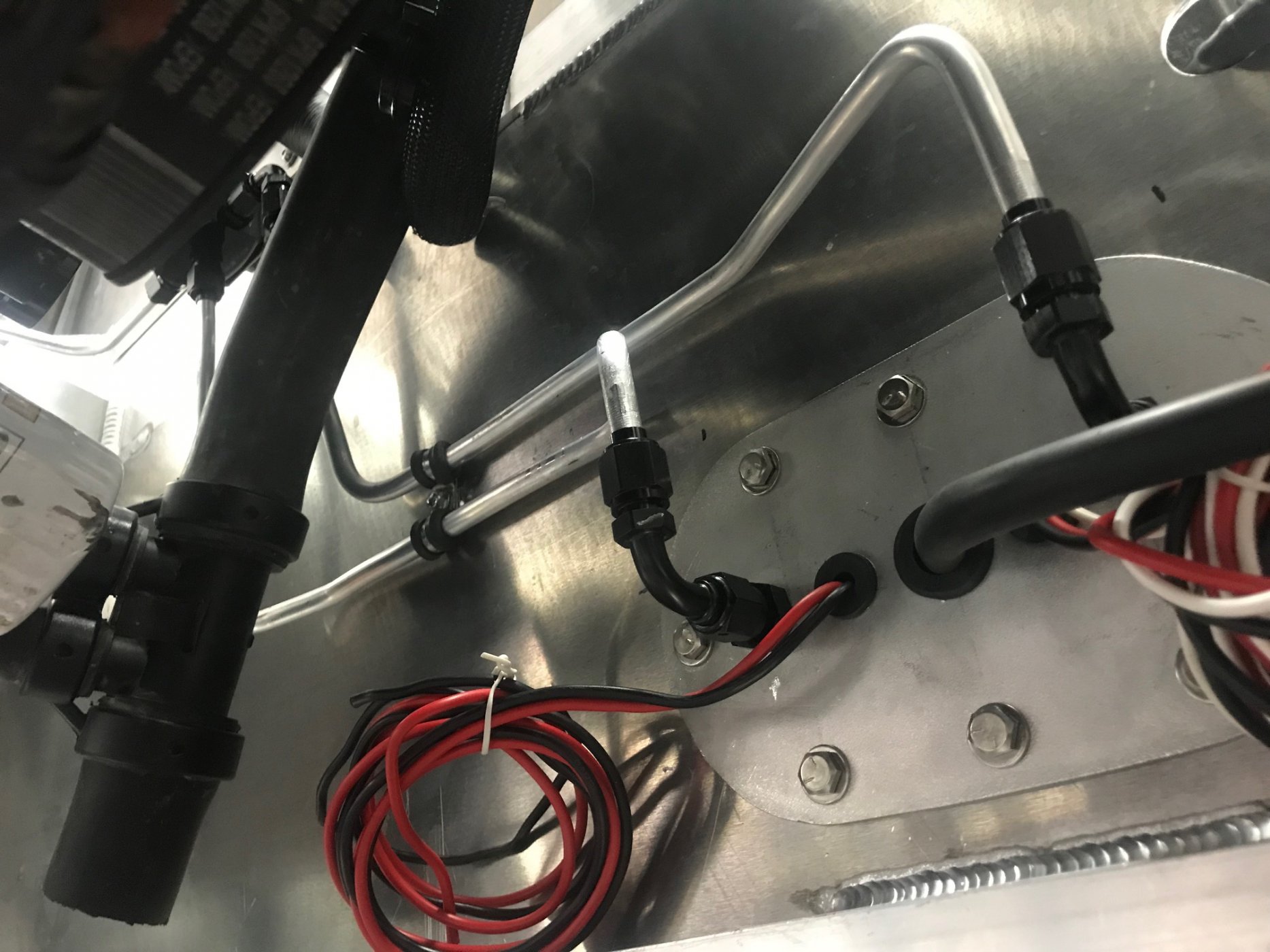

Working on coolant and fuel piping front of car I plan on putting the gas tank fill on passenger side of car. I have a question to the guys who have installed the gas fill did you keep the fuel flapper door from RCR in your system I would think it would cut down on fume odors while in a garage

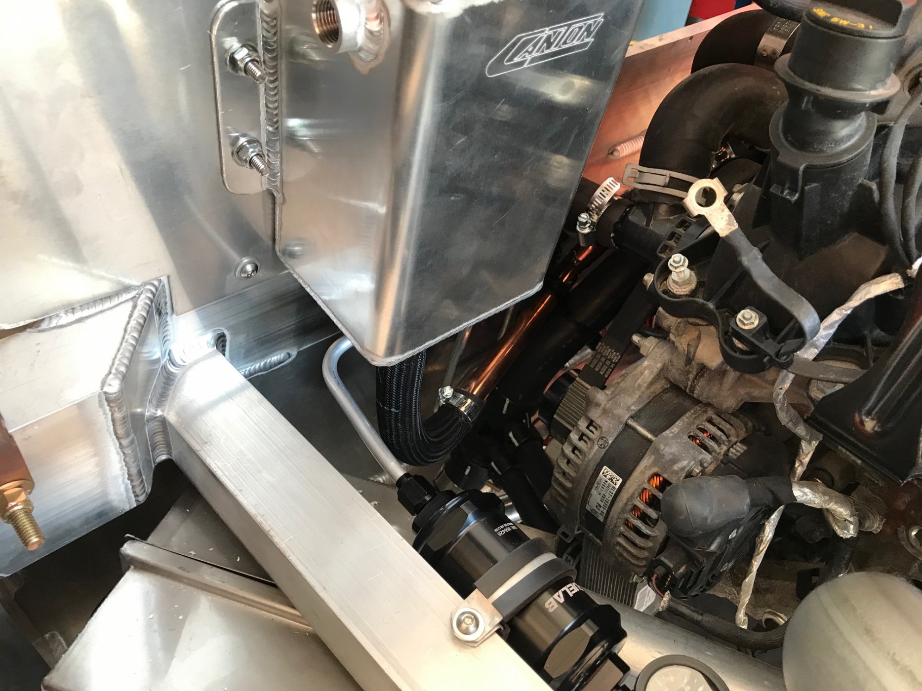

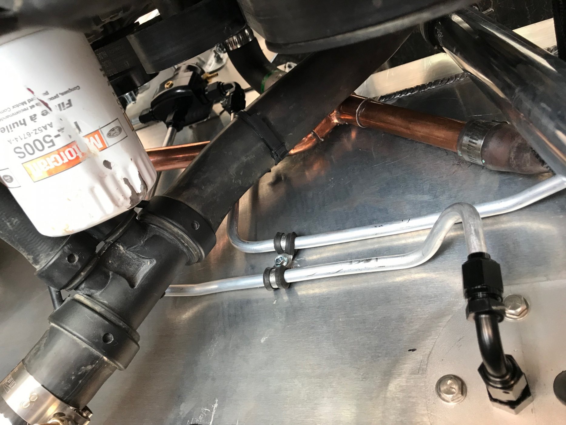

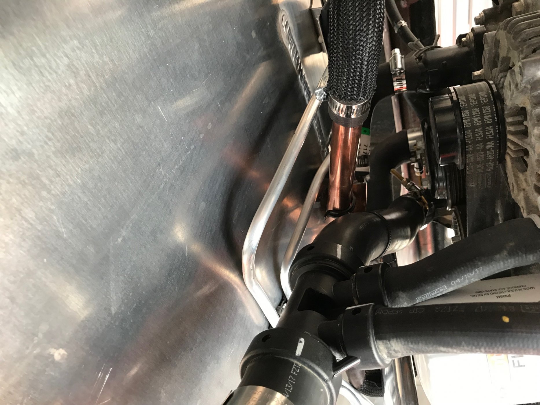

So yesterday I had to make a fitting that excepted all of the different sizes of the coolant piping so I turned to copper it worked out perfect and to the AC and Heat

Steven Lobel
Copper scares me in cars. Heat cycle and vibration might lead to fragility of the pipe. Unsure if true, but have not seen copper on race car.
Neil
You won't find copper in aircraft, either. Pressure cycling or vibration is a killer for copper, it work hardens and then fractures. In quasi-static pressure applications such as Larry mentions, it is OK. Another reason not to use copper for fuel lines is that it is catalytic to gasoline. Copper accelerates the deterioration of fuel.
