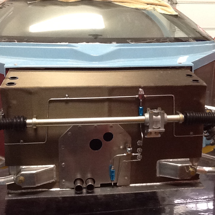

Your front brake line plumbing looks nice and neat but think about where the air bubbles in your brake fluid are going to migrate to. It will make bleeding your brakes more difficult.

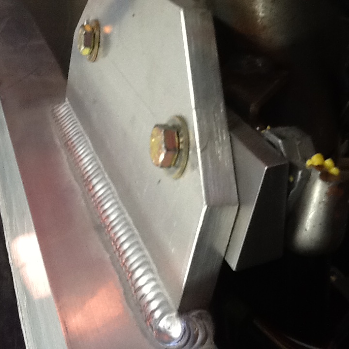

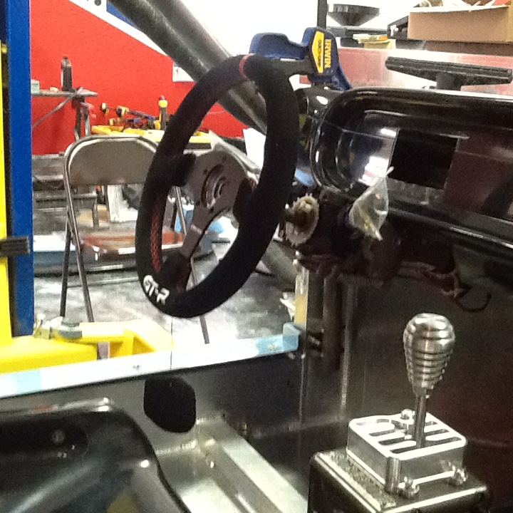

I have been at it for a while all of the brake lines are done the foot pedal assembly are in an the shifter and cables are done I just purchased a Tig Welder so now it's on to completing all of the welding. One thing I thought I would share is the tilt steering wheel I modified by moving the mounting location over one inch to the left and center the column and I added a 15 degree shim to allow the column to be more upright and use the tilt function with more up and down motion

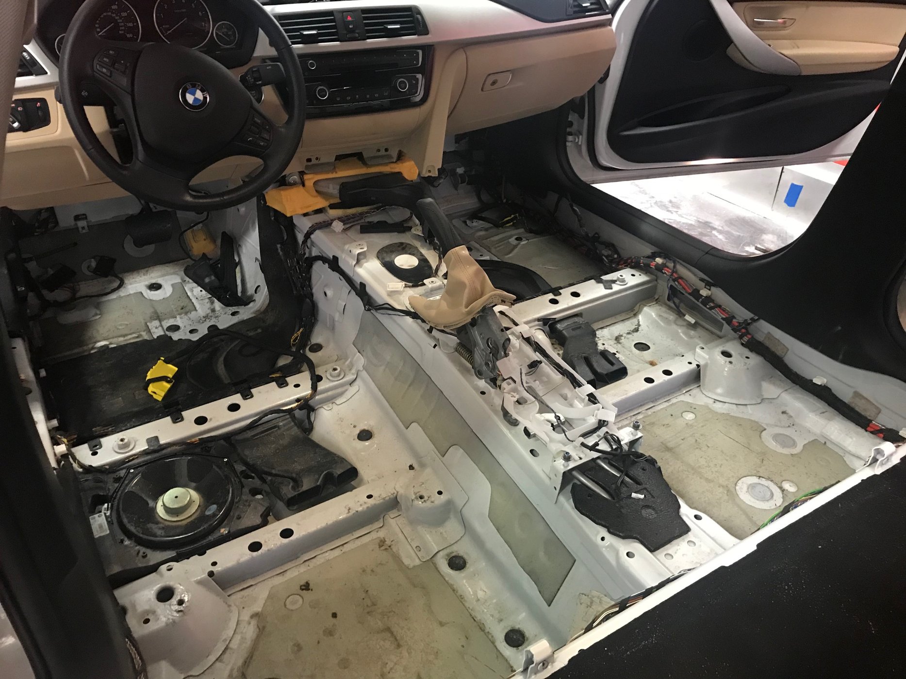

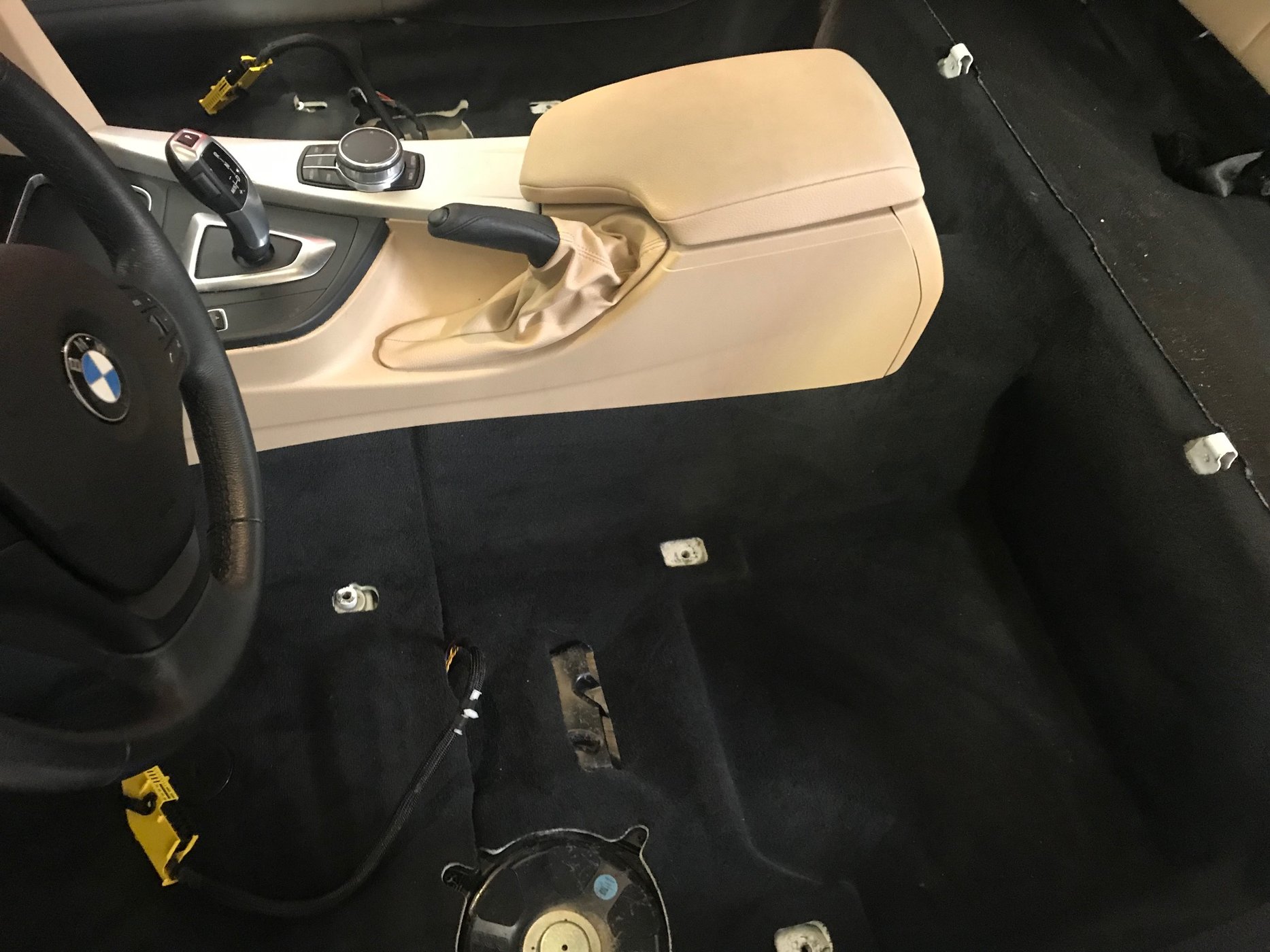

Had to take a break in the GTR Build and replace the carpets in my daughters 2017 BMW 320 I i won at auction a yr ago knock on wood the car is perfect.
