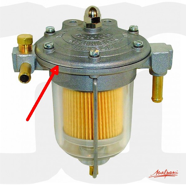

This is the type of filter that burned up my Porsche 911. The gasket in the joint indicated by the red arrow failed and gasoline sprayed all over the engine and caught fire. Bystanders noticed the flames and smoke coming out of the vents and I pulled over to a spot that wouldn't set anything else on fire, got my briefcase and documents out of the car before trying to beat the fire out with my shirt. Now I carry a 5 lb Halon extinguisher in my cars- If it is needed I'm not going to worry about the ozone hole. Doesn't the Latin root of the name "Malpassi" mean "bad filter"? :rolleyes:
This is why I keep saying that in a rear or mid-engine, you are the last to know that you're on fire.
