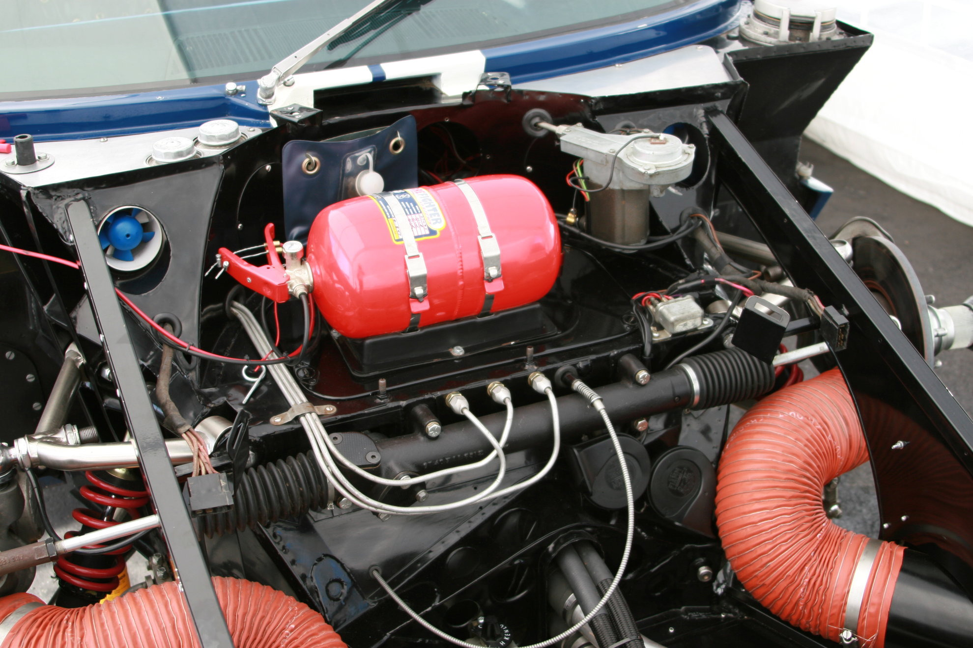

The most popular location is on the scuttle.
It will mean using a screen wash bladder unless you want to keep the Lucas plastic bottle/pump and fit it somewhere else.
View attachment 93643[/QUOTE
Just to remind anyone using their car for racing that the bottles must be bolted down, and not of the over clip down type as shown in the old picture. They are now outlawed by the MSA/FIA.
