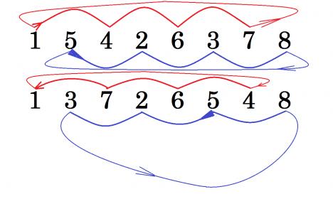

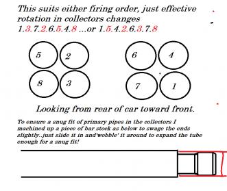

I want to keep the 302 sound as much as possible. Does it make a big difference? Do I need to keep the 302 firing order for the closest GT40 sound?
I had similar goals and chose a flat tappet le mans grind from Cobra Automotive. Having adjusted valves regularly on my Cummins hotrod, I would not be afraid of doing it a couple times a year on a 302. If you have a GT40 it seems you've already accepted your role as chief mechanic and tinkerer.
Does not really matter.

Nope, not with 180° headers as per dwg in other post.... It does make a difference in 'normal' side for side headers as fitted to damn near everything else since the uneven firing pulse pattern swaps from bank to bank with the firing order change.
You can grind the same profile of the cam on either firing order.
