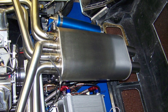

Just wanted to post to let you know how pleased I am with the services of Frank Catt. I have a 'slightly' modified 396 engine and am concerned about how to get under the 99dBA noise limit for IVA. I decided Frank's experience of building repackable silencers for GT40 race car's was what I needed, so the car was shipped down to Hailsham and Frank worked his magic. While the car was there he (and his colleague Geoff) did a few other smaller pieces of work on the car, all of which I am very pleased with.
Unfortunately we were unable to start the car to check the noise level because we had a problem with the starter motor while we were trying to start it. All being well the starter will be fixed later this week so I hope to start it soon. I will post video if it is successful.
Here is photo of Frank's exhaust on the car.

That's a neat looking exhaust.
I've been to frank a couple of times and it's always a pleasure to talk to someone who's as driven as myself and also is trying to improve himself.
can't wait to see the video and hear the sound
keep us posted Lee

Sounds nice. Interesting approach as well. Sure would like to see the lay out inside that muffler. Is there still something that approximates a colllector that maintains similar scavenging/extraction to 180s?
Best,
Kelly

Another small update on the exhaust. I got the car out onto the driveway and did some noise measurements. Frank still has some work to do, but he is already on the case.
0.5m from exit at 45 degrees at 3500rpm we measured 108dB. Needs to be down to around 95dB for most track days! (99dB for IVA registration test).

Guys, beside the noise issues, be cautious about temparatures in the system as well, we have measured in excess of 900C in the collectors, 1018 exceeded 1000C in 2 laps at Goodwood, so not running an insulated silencer box means you need plenty of air space around the pipes and any part close to the bodywork. Frank
