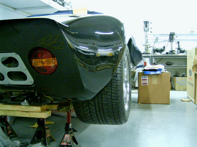

About the Pirelli PZero 345/50/15s. They are smaller yes, but fit well and are seriously wide. Here's a pic of one in our shop. The fronts will be 225/50/15 PZero to keep it all in the family.
The black CAV GT with the 345s has a 347 Ford Racing crate engine, Webers and RBT 6speed. Mathmatical top speed over 230mph at 6000rpm so comfortable highway cruising will be no problem:).

The Cav with the 345 pirellis looks a beast. I really wanted to see what the 345's would look like on a GT40 so thank you for that.

How does the reduced height of the tyre (Pirelli 345's) affect geometry, steering, anything else I haven't thought of ?
Are there any issues at all with running a tyre with a diameter of 625mm rather than 670mm ? I am refering to the matching front pirelli 225/50's as well.

Just a point of clarification--the rear tire size is actually 345/35-15, not 345/50-15. They are a good match size-wise with a 225 or 245/50-15 for the front.
Last time I checked only Dunlop was making the 245/50-15 in their SP8000 line.

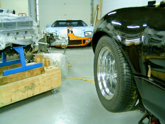

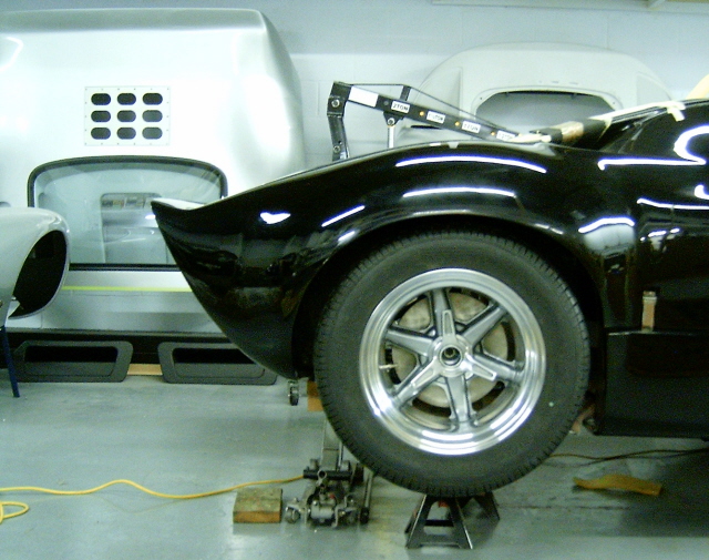

Here's a couple more pics of the 345 PZero on our customer Gulf body CAV GT. We were checking fit with revised lower control arms incorporating new geometry to suit the rubber.
The front suspension will be done shortly, does not change the wheelbase or track, just everything else, it will be a "must have mod" for anyone looking to track a pre 100 CAV. Stay tuned:)

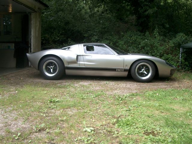

Good call, I made the same decision, altho at the time the widest rear tyre available from Avon was the 245, which I s-t-r-e-c-hed onto an 11 inch rim. As soon as these are worn I'll be getting the 295's.
I also have the 215's on the front on 8.5 inch rims. Enc picture of my car wearing the Avons, showing the tall sidewall which IMHO looks better, allows a bit more 'pliance' in the tyre & obviously helps with the gearing. FWIW I haven't finished sorting the rideheight yet but am pleased with the way the car sits.
