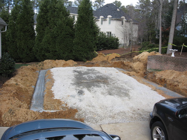

Finally!!!! Some progress. The builders have started with the footings being dug and shored up, hopefully next week the foundation will start. Maybe this thing will actually come to pass!!

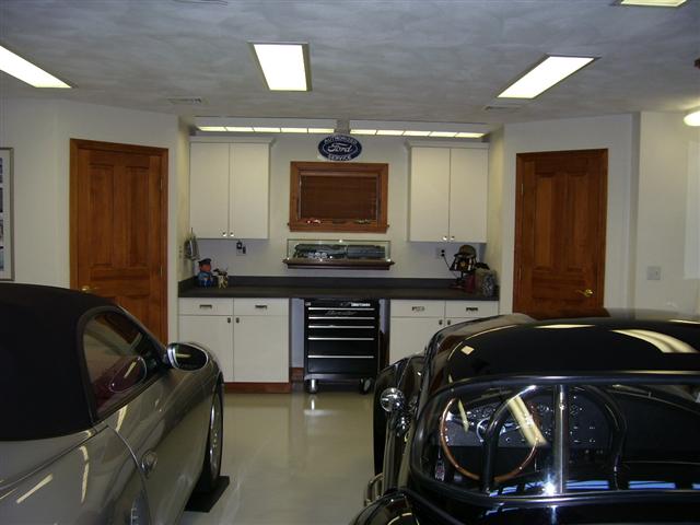

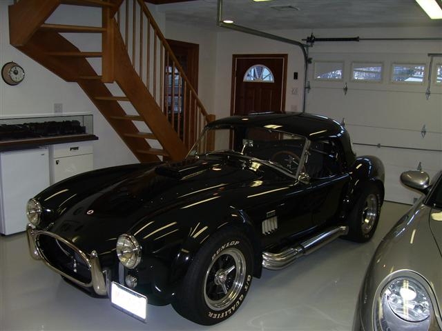

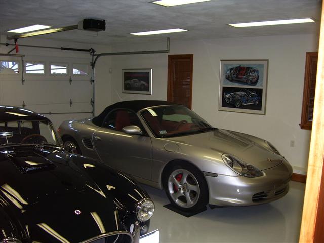

I don't understand how the tiles can work out but, many use them ( doesn't water run off from wet car or even condensate drain from A/C ,oil, ect seep between the cracks or into the open mesh of some types and accumulate under the tiles causing dirt and mildew build up?
Well due to that concern when I built the new garage 8 yrs ago went with Benj Moore industrial epoxy and as you can see from pics below after lots of engine, tranny, suspension work to the Cobra over the yrs the floor just needs a sweep or quick wash and it's clean. I do use plywood under jack stands and cardboard if a major job but, no real day to day precautions.

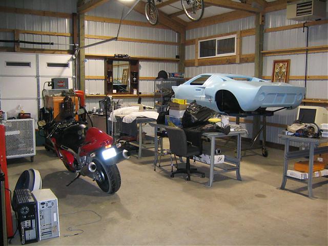

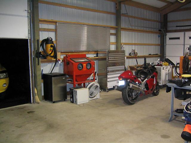

Ron,

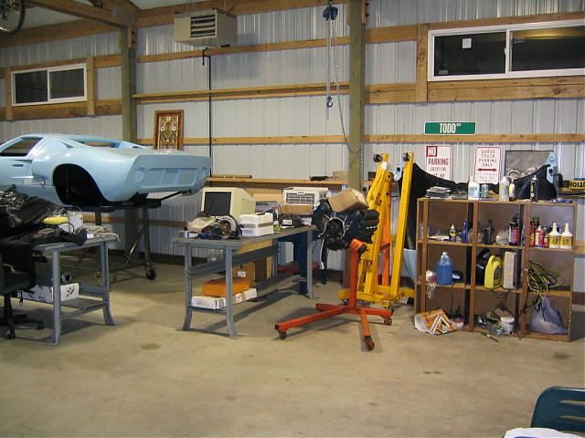

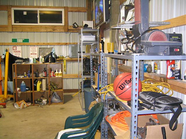

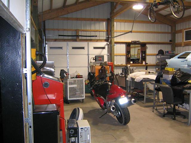

My shop is 24 x 36 x 14 ceiling. These pics should give you an idea of space usage. I can still get a 21 foot boat and trailer in the door where the bike is and my truck in the other. I put a lot of things on wheels to help move things around if needed. I'm right in the middle of shifting things around as these pictures were taken.
Pete

Economan that garage size is about right on what I'll end up with I think. Your ceiling is higher though for sure and that is quite nice. No garage is complete without a motorcycle - see you've got one there!
