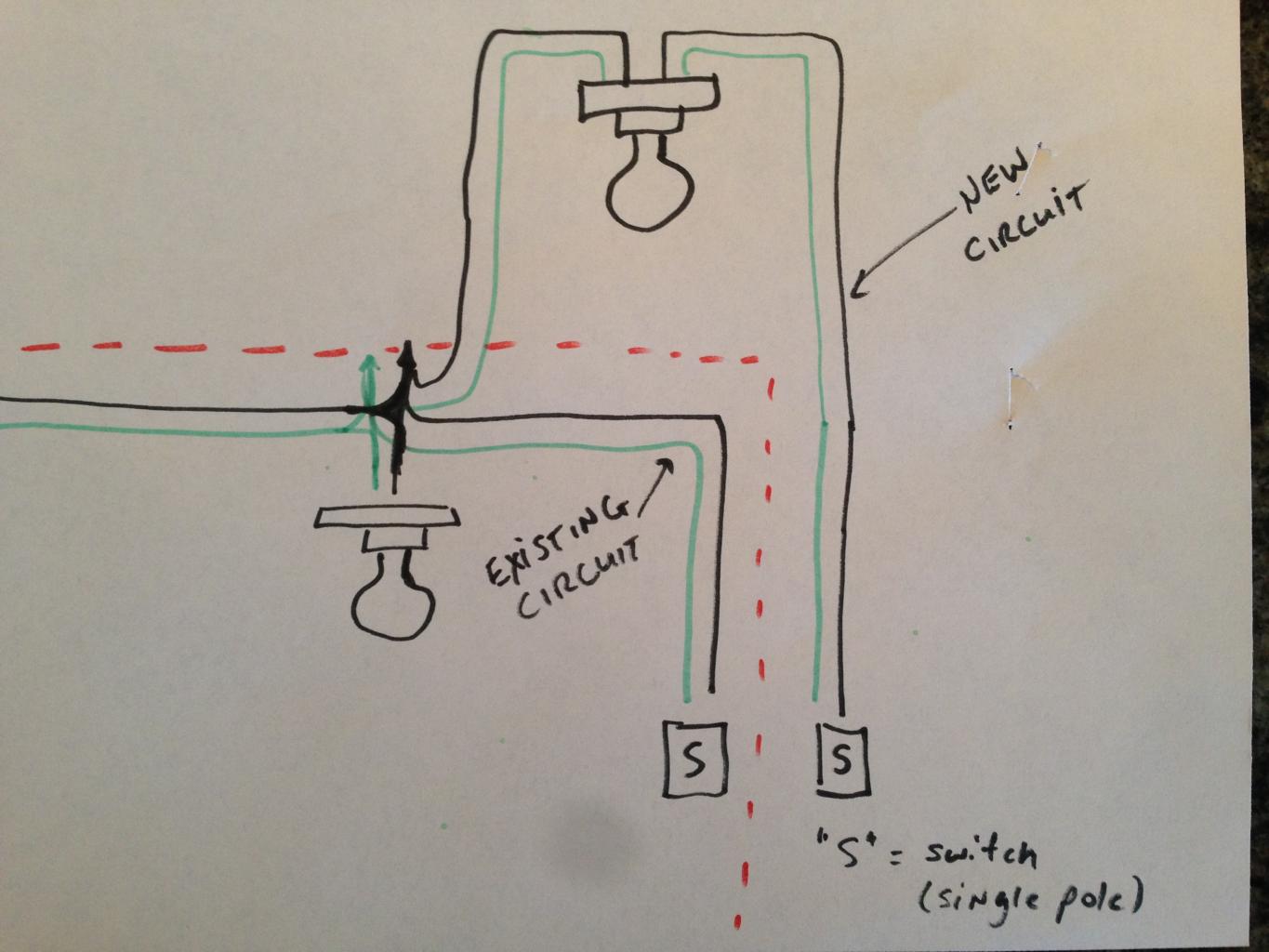

Here's the background. I'd like to add more lighting in my garage (who doesn't want more light in their garage??). There's an existing circuit with a single overhead light with the switch (single pole) on the end of the run - see diagram, everything inside of the red dashes. I'd like to add another circuit with another overhead light (maybe two) off this existing circuit, separately switched in a new double gang switch box in place of the existing single, preferably with the switch at the end of the new run.
Will the wiring configuration in my hand-made diagram work? Hot wire is black, white/neutral is the light green, ground not shown (but will be included obviously).

I smell smoke.... :eek:
I'll try to draw you a diagram of what you have and what you want later tonight. There is no way it is wired as you have drawn...

from your drawing I would suggest you get someone to help you.:laugh:

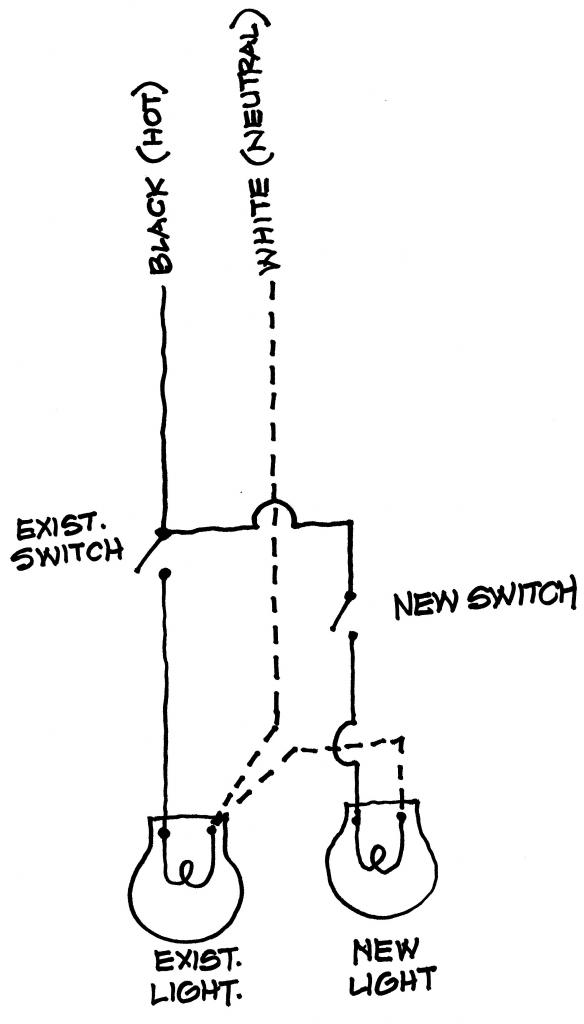

Dwight's correct, so long as you are talking about adding an additional switched light to the existing circuit. Here's a diagram showing another way to look at it. However, you need to be careful about the total load. Depending on your local electrical code, #14 wire is only allowed to carry 15 amps. Allowable current for #12 wire is 20 amps. You need to total up all the wattage that will be supplied by the circuit breaker and divide it by the voltage to get the amps. (For example, 1,100 watts of stuff at 110 volts will produce 10 amps of current.) If your existing circuit is getting maxed out, you may need to make a new, separate circuit back to the panel with a new breaker. Also, you always switch only the "hot" wire, and never use a white wire as "hot". Be sure of the code and be sure of the load, and if you are not totally comfortable get some qualified help. It's not difficult, but you have to think it through or you can zap yourself or burn down your crib!

Thank you gents, I understand the logic now of the circuits.....very helpful. I'll install the cans/lights as a slow-paced winter project (being careful of the total wattage/load on the circuit - thank you). Thank you for the circuit diagrams.

sorry Charlie
I assumed from Cliff drawing that he was using keyless light bases and just drew my picture to show them as keyless lights. My drawing is not an electrical schematic but a simple picture to help Cliff.
