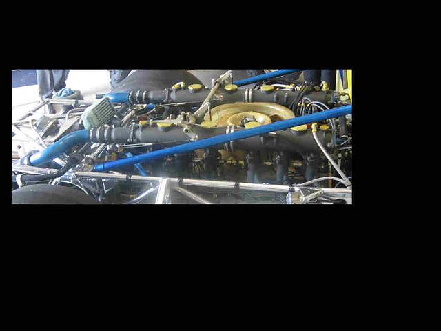

In this picture of the 956/962 you can see the fan in the normal loctation and being ducted from the top. This is the easyest way to go. Maybe pull the air in from the area over the engine and use a nice cleanly made grill would look good.

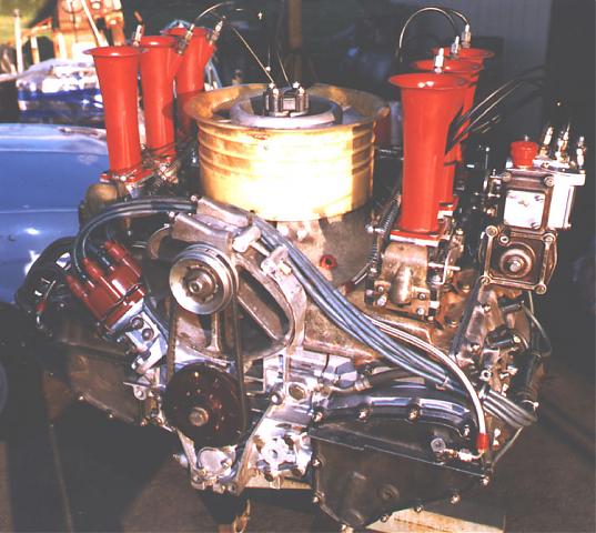

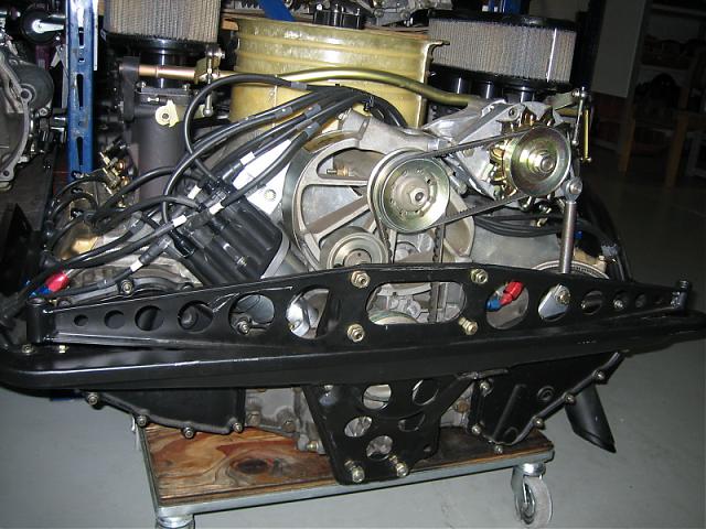

Saw a real 917 once and WOW! Have fun building it, It's totally worth it! - Have a great time! Here is the pic of the engine I took!

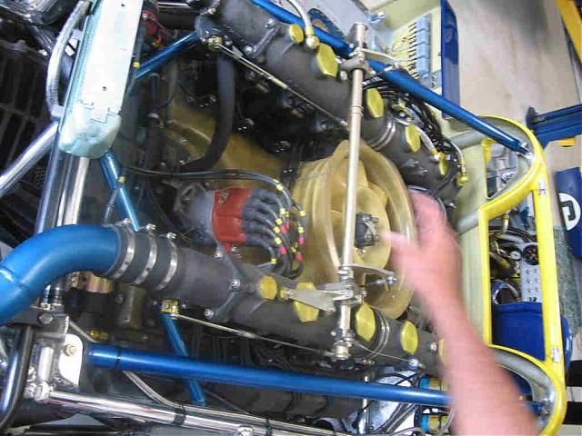

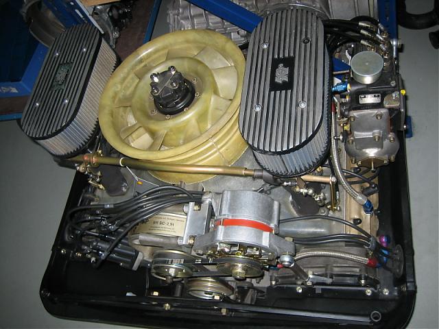

The one change I will make to the 993 is to have a horizontally mounted cooling fan like the original 912 engine. I'd appreciate any thoughts on how to do this. I have seen some photos of more contemporary flat-6 Porsche racing motors with a horizontal fan - anyone know how this is driven, and what shrouds might be available?

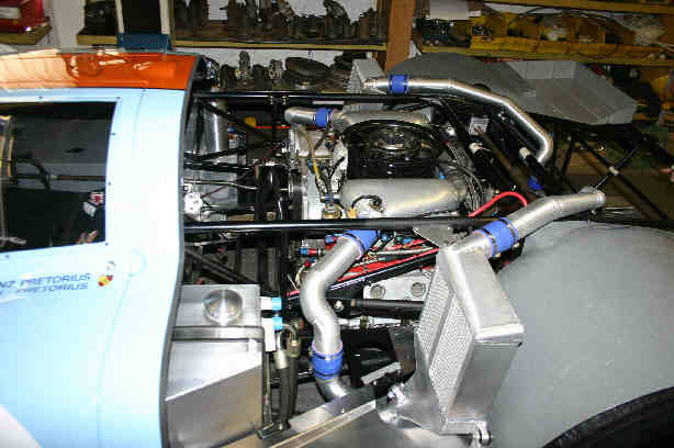

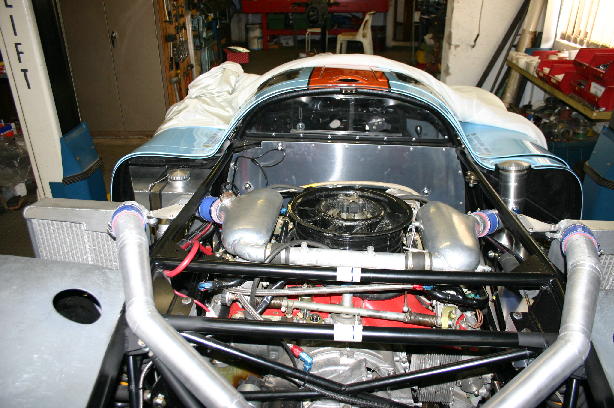

Craig, here are some pictures of a 917 with a 935 twin turbo 6 cyclinder. Note location of twin intercoolers. I would have moved the turbos closer, seems like they are to far back.
Enjoy, Mark

Mark, do you have any other pictures of this car? I am probably going to be doing a similar motor set-up with my car. do the intercoolers or anything else for that matter interfere with the bodywork? Whose car is this and can I get a contact number?

Howard, in response to your post - yes, this is an aluminium tub, but only from the firewall forward. The rear of the car is still a tubular space frame, approximately fitting the original 917 chassis, but designed to exactly match the original car's dimensions.

I've seen the openness of the 962/956 engine bay but can't confess to having seen that of a 917. I'd imagine it's a bit tighter around all the tubes...
Interesting. It looks like the transaxle is right side up, but isn't this trans normally pointed forwards? did they reverse the rotation of the engine?
Or is this something other than a G50 trans?
