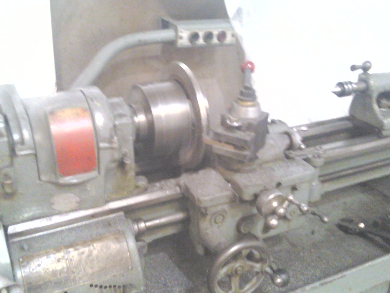

Just like many the economy has hit me a bit harder than I would have liked. So in the inertest of trying to save where I can. I decide to try and make my own brake disc mounting bells oy of the Merkur Scorpio solid rear discs. Here a couple of pics while machining one this weekend

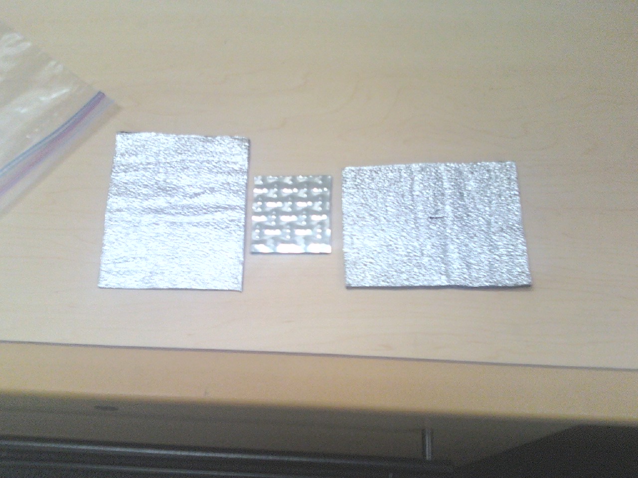

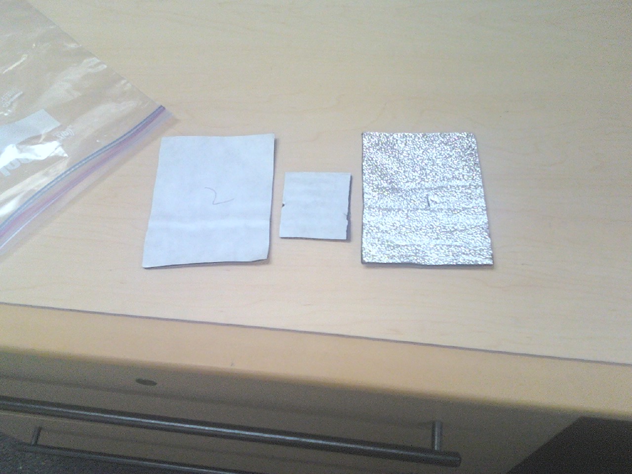

The one thing nice about being inside racing is that once in a while you find products to help your project. I am going to use this on my rear bulkhead. It is called Teknofibra. I think it will help in a couple different other areas also. It has an adhesive backing which will work nicely for my application.

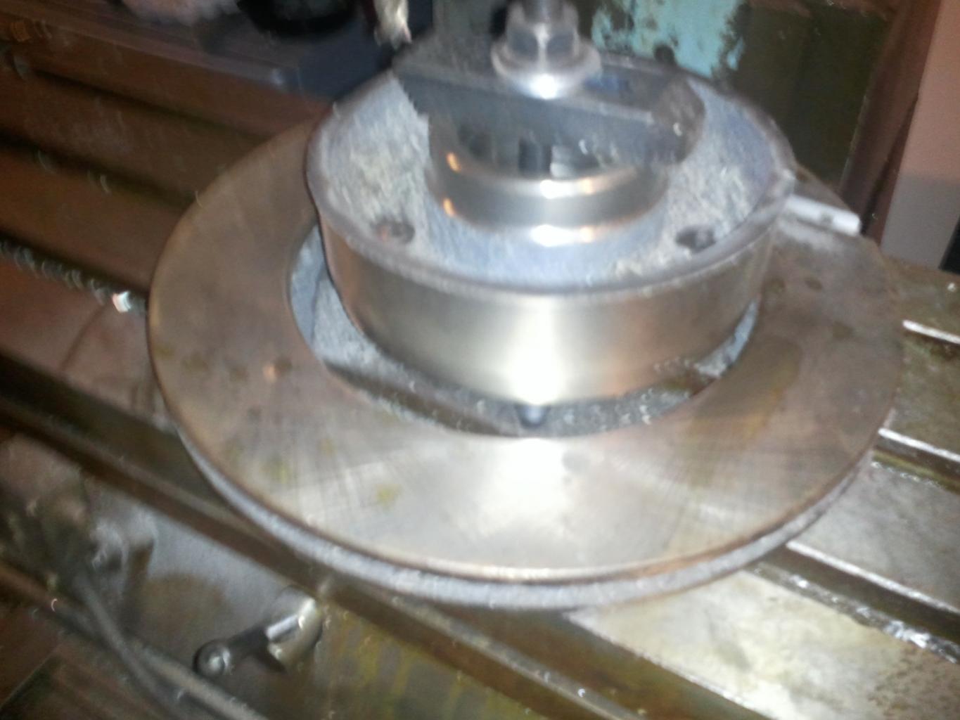

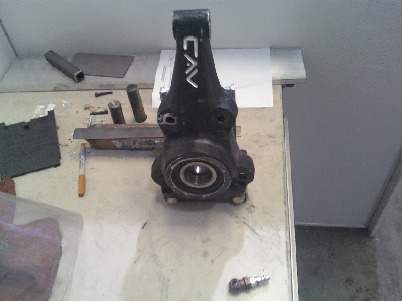

Spent some time working in the garage this evening. I removed the the Ford Granada hubs from the front of the chassis. I needed to remove the brake discs from the hub. The Hub and discs were one piece castings. Clamped the hubs to the bridgeport mill fired up the phase converter and machined the brake discs off. Now I can take the hubs to the lathe at work and finish the job. The bonus is I will lose a bit of weight on each hub.

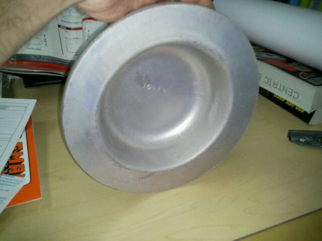

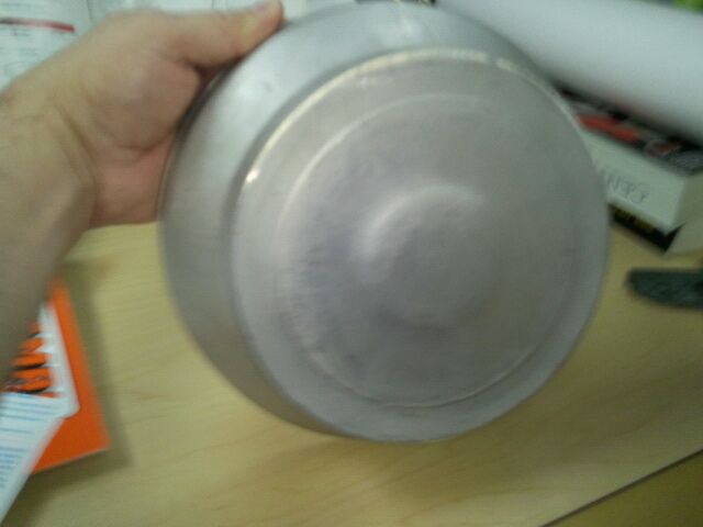

A couple photos of front Brake Hat blank forgings I am starting with to make front brake disc hats.

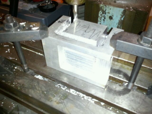

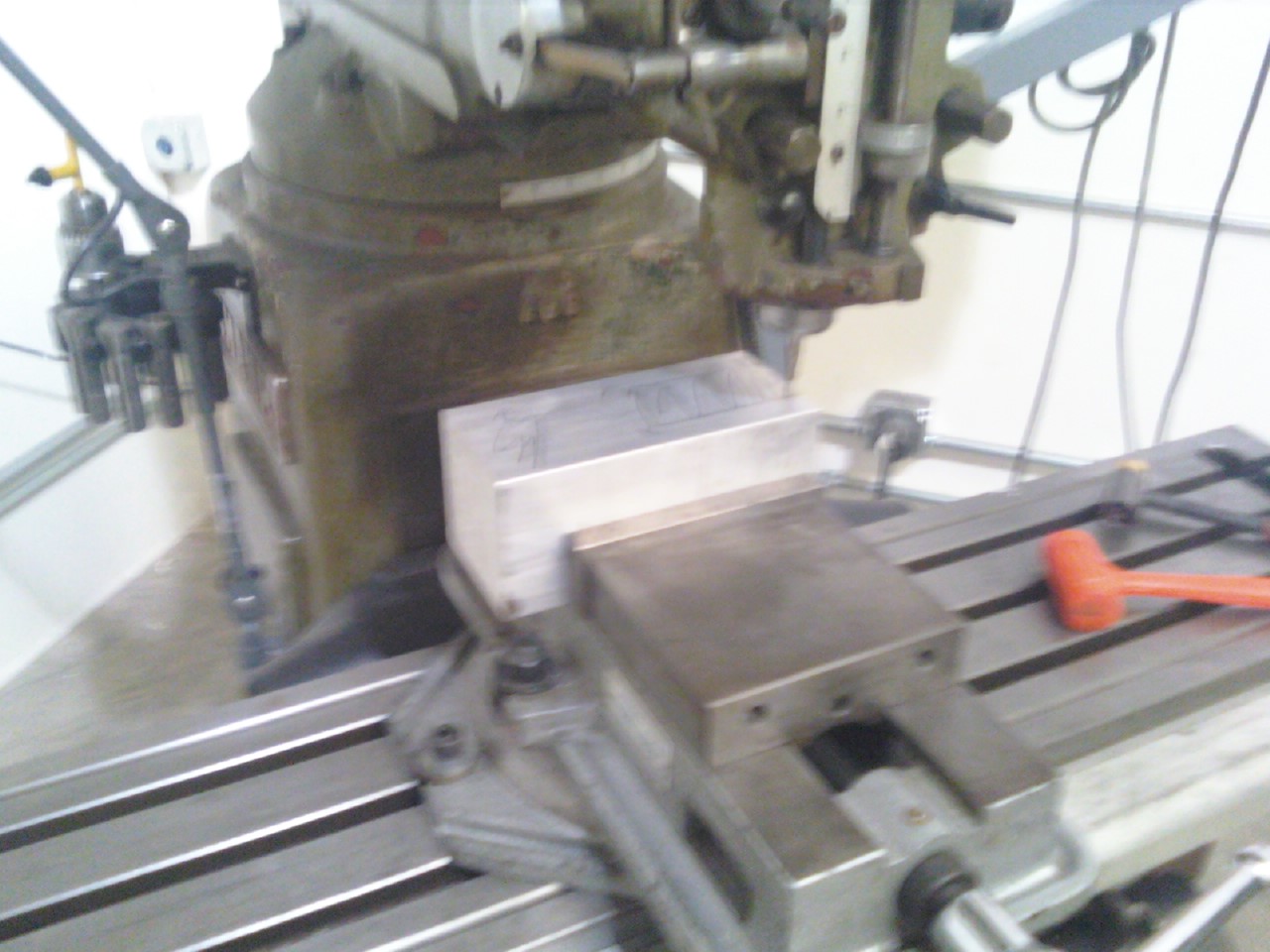

I got the center of the shifter mounting bracket machined the rest of the way out today. I am going to have to invest in a machine vise. It was a real pain to do with out one. I may finish it up at work on my lunch breaks. But at least we have progress.

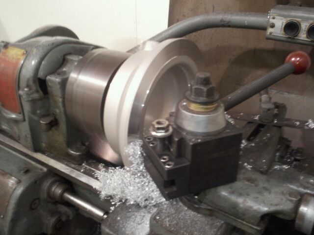

Since being in the racing parts business starting in 1995. The most common material I have seen used is a 6061-T6 aluminum. Some high end hats are made from aircraft grade 7075.The old grand national style hats (nascar) were just castings. Availability and cost are always issues in production parts. I personally think 6061 will work fine for my application. I quit reading engineering books years ago they put me to sleep;-)

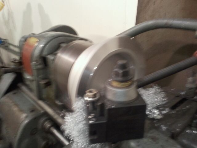

Started machining front brake hats today. Nice to be making progress.

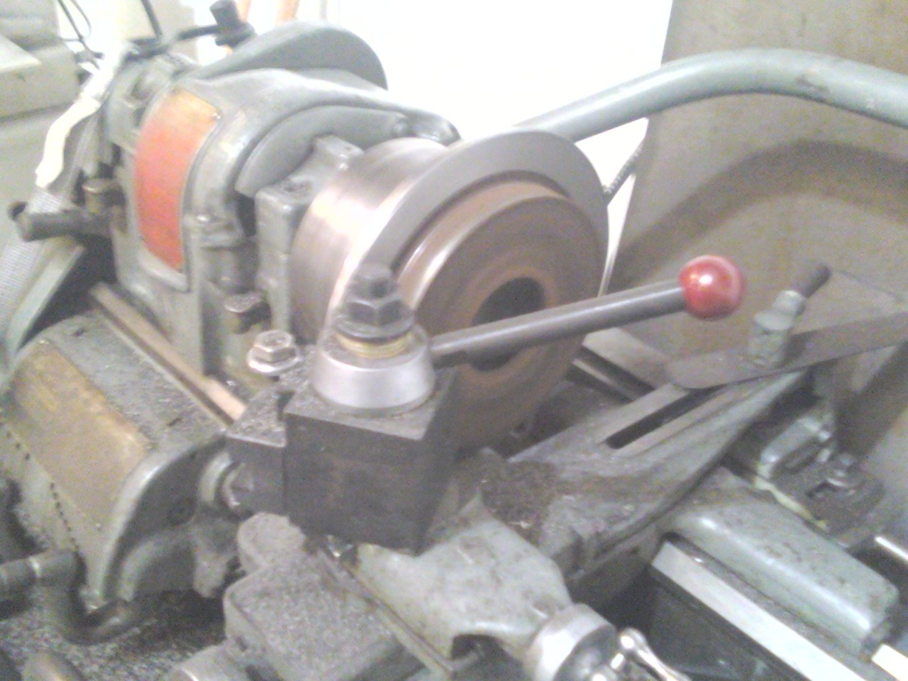

Interesting that you are using 6061. DBA use this grade of aluminium for their mass produced hats - part of the reason being it is easily anodised.
I was tossing up between 2011 (free machining bar) and 7000 series
