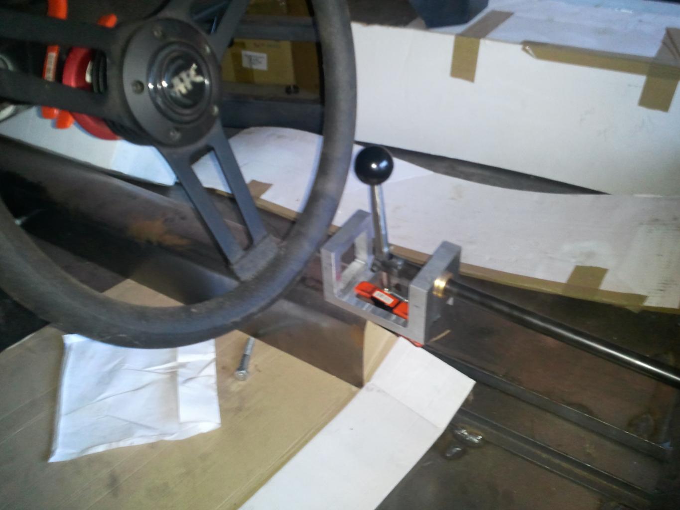

Working on shifter handle.

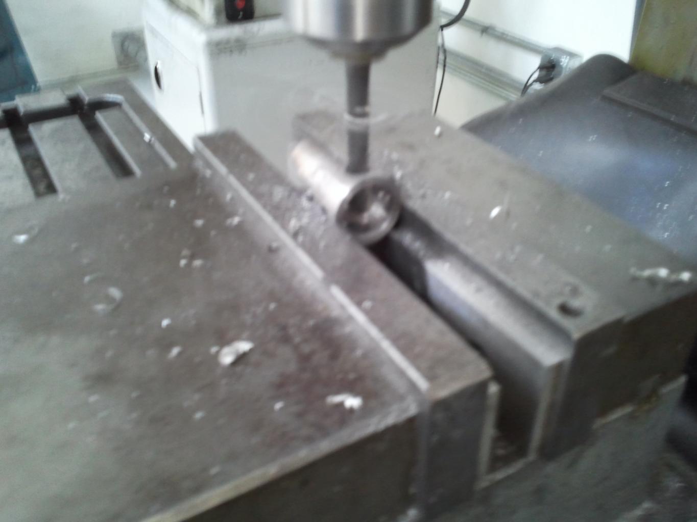

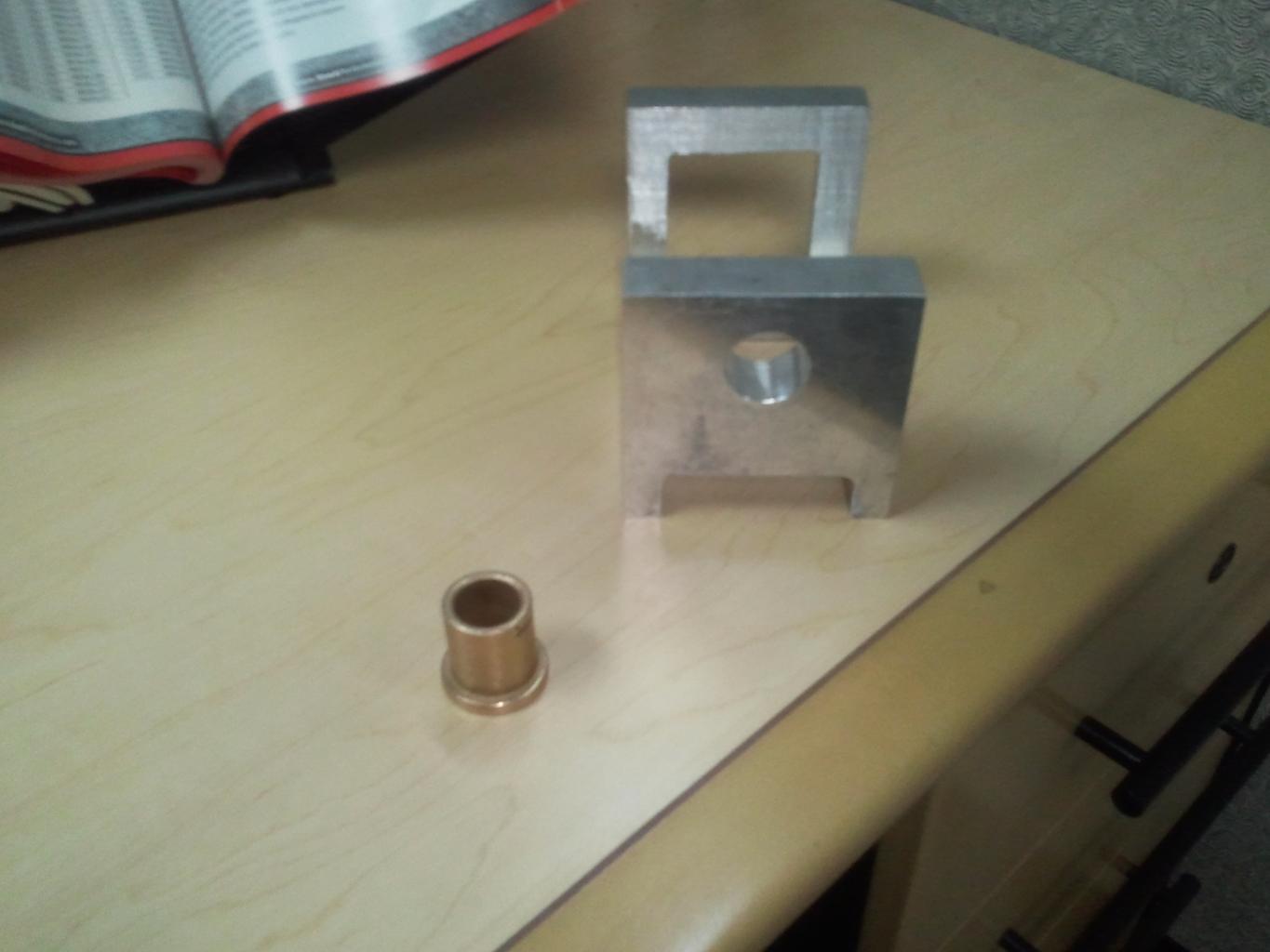

Shifter rod bushing arrived from McMaster Carr Bored a 1" hole in bracket for bushing.

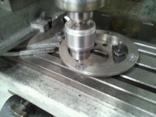

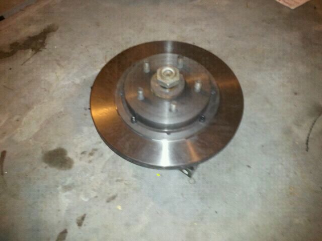

It has been a constructive day. Drilled the bolt circle on one of the rear rotor hats. It fits nicely on the upright for the rear.

Well I just figured out that I have to throw away my rear wheels or my rear uprights. The uprights I purchased position the radius arms about 3inches inside my wheel. Problem being the wheels only come in one rear offset.

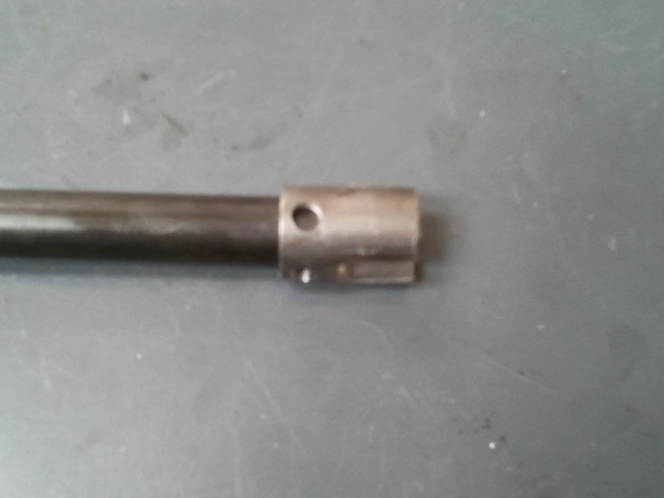

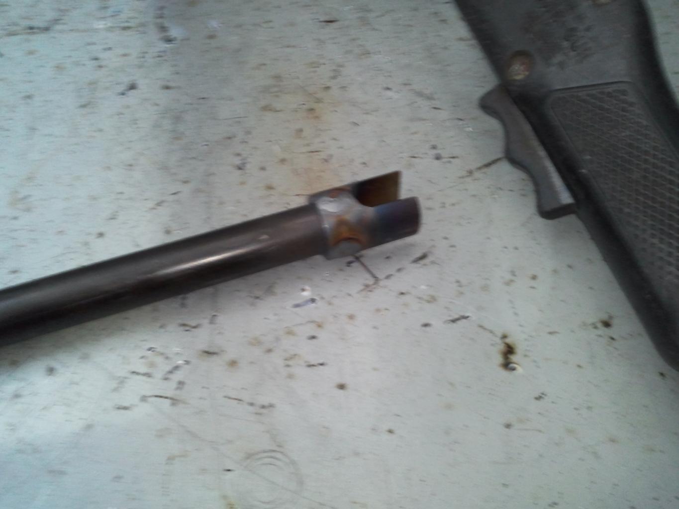

Spent a little time on the shifter today. Opted to do plug welds in attaching shifter tube to yoke
This week has been one step forward two back finally the shifter is complete. On to another piece of the puzzle.

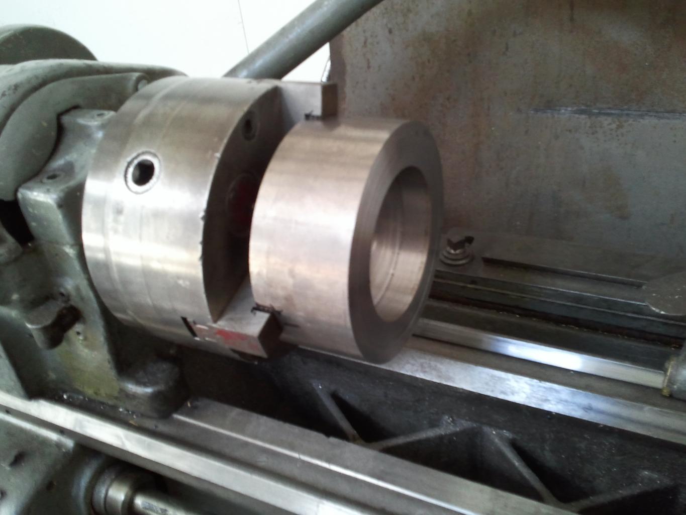

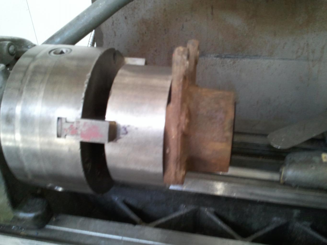

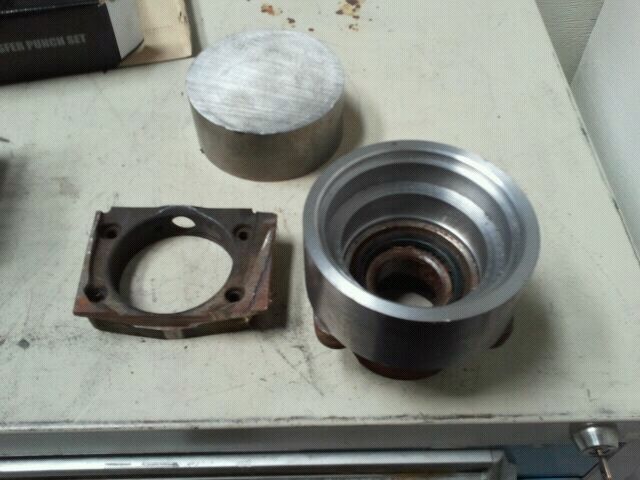

I found out a couple weeks ago my rear uprights I had purchased from a CAV would not work with my wheels. The radius rods mounts were 3" inside the rear wheel.:sad: So building rear uprights was back on the list. Went to pull a part years ago and purchased the drive shafts,stub shafts, hubs, bearing brackets off a 1989 Merkur Scorpio. So I have the bits to get this done. In a couple of lunch hours the register hole is complete in one upright center.

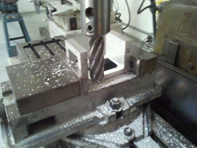

Working the lathe at work pretty hard. Machined out the backside of the upright center.
Completed it and test fit it on Bearing assembly.
The Merkur Scorpio hub assembly is the same as the Granada parts the U.K builders are using.
