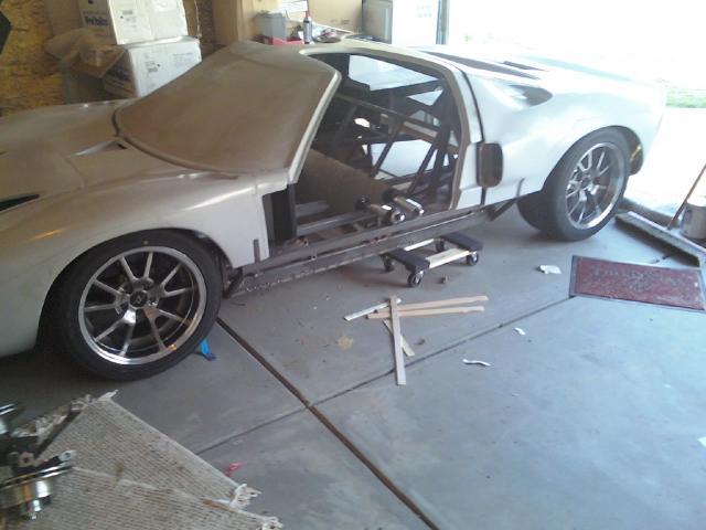

The tires arrived for the rear of the GT. I had them mounted on Friday.
I rolled them under the chassis to see how they look. What do you think?
Looks Great
I always liked those wheels ever since I saw them on the Ford GT Prototype...
Soldier on! :thumbsup:
Dave,
Look's good and not bad for a Walmart Tire. Your lucky to run 17" rim. The Nexen in 13" which is the rim size I am running are a bit limited. I may have to go to a Toyo Proxes or Khumo Esta. Twice the money.
Dave
Thank's Guys. I am happy with it so far . The main thing is I am still in my budget window. It is a bit of incentive to keep working when you see what it going to look like.

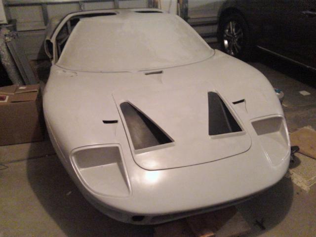

Have been doing a bit of filling and sanding on the body parts over the last few days. Hoping to get a bit done more over the weekend

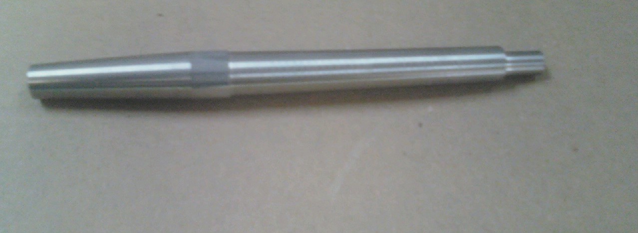

Hey Guys know it has been a while. I am working on a rod style shifter at the moment. Does anyone have a measurment of how tall the shifter lever is?

Here is the blank of the shifter handle I have been working on. It will be a rod stlye shifter when done.
