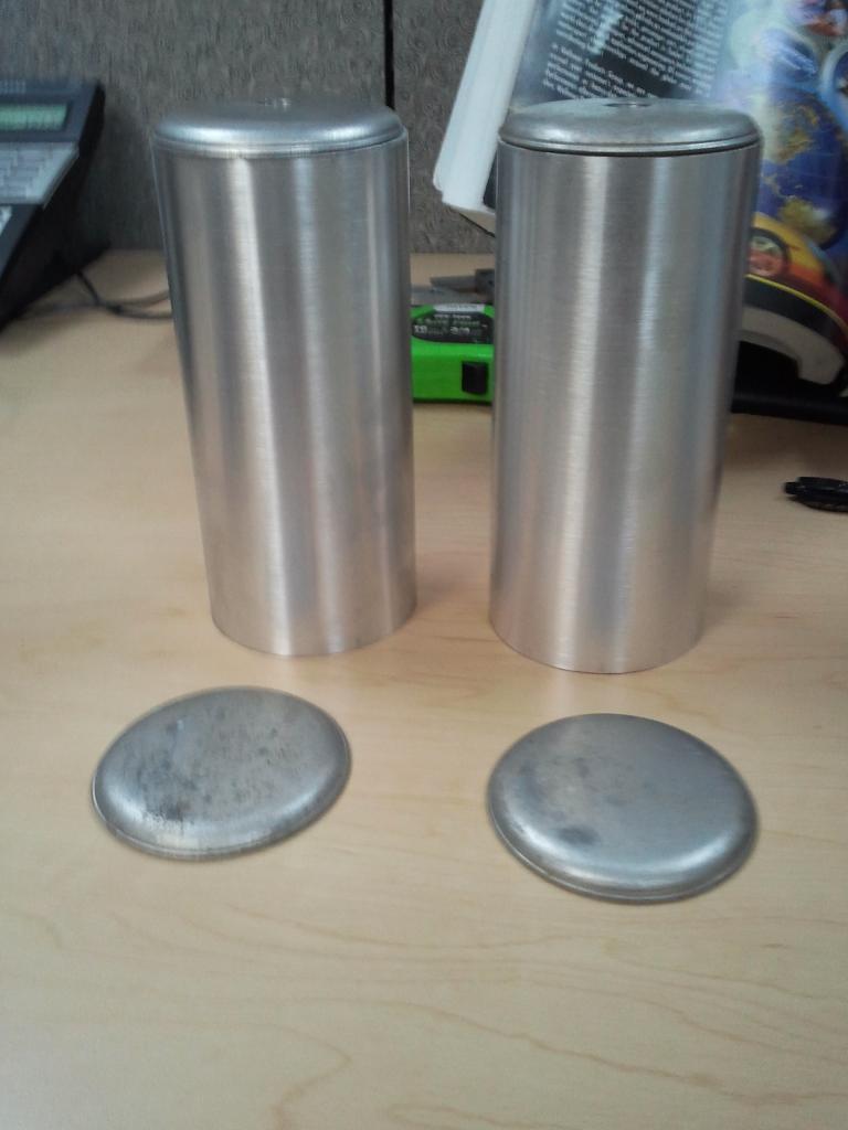

I need an expansion tank so as with most of the GT so far saving by making one. The good part years ago my expartner and I made some racing parts and expansion tanks and rearend breather tanks were some of the products we made. He still had some tube and domed ends we used to stamp out in a punch press. Which he donated. So figured I would make 2 and sell one.

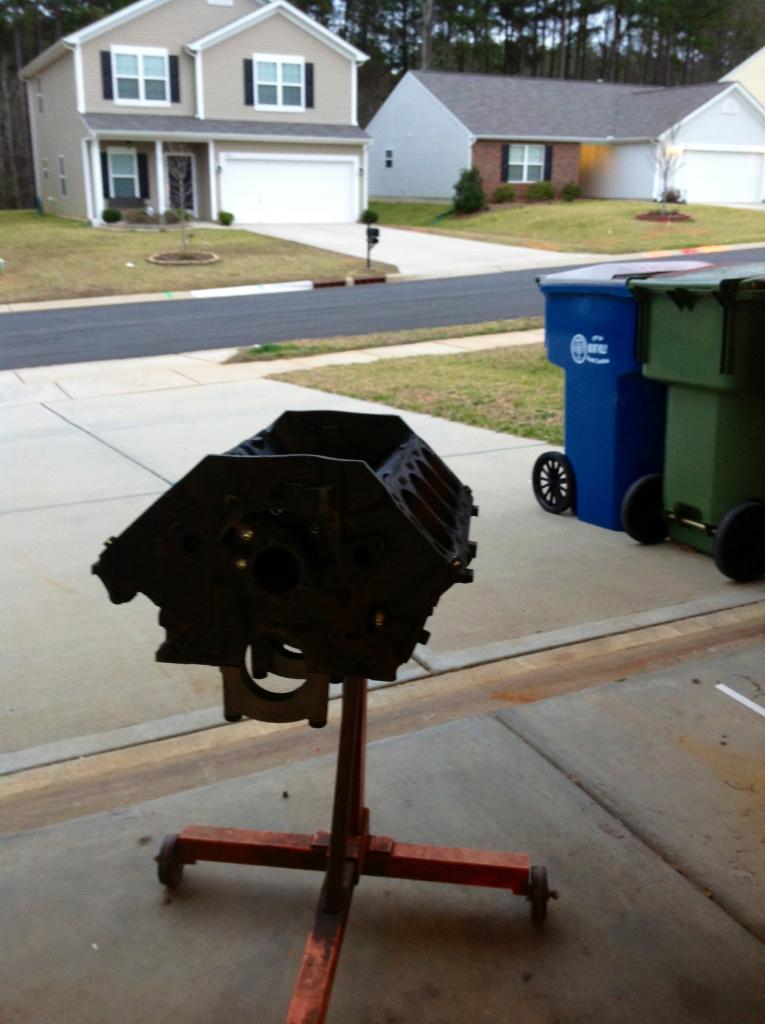

Woohoo! The engine is now at the machine shop. It will be getting a good cleaning and .040 over bore. Owner said it should be done next week.

It has been good day today. I picked up the engine block from the machine shop. Dropped off the connecting rods to have the old pistons pressed off. Frost plugs arrived a few days ago.

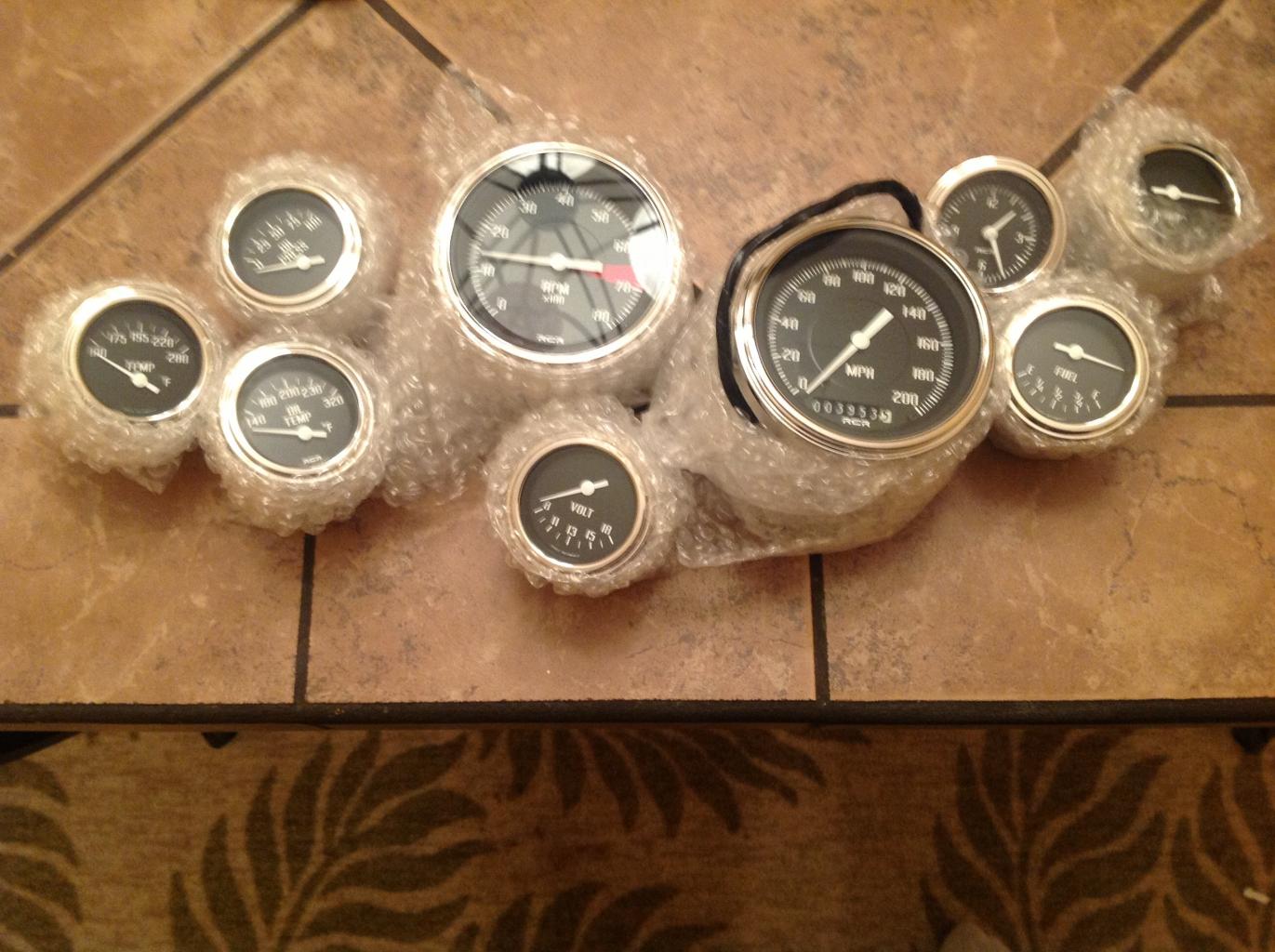

I also received confirmation my gauge set has shipped. Looking forward to getting them installed in the dash.

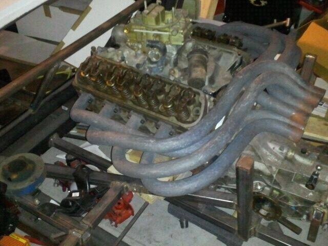

Received a package today from the UK. Specifically from Frank Catt at Wealden Engineering. Frank took time out of his busy schedule to send me a set of used headers for my scratch build. It is great to find good guys who will help you out.
Thanks again Frank

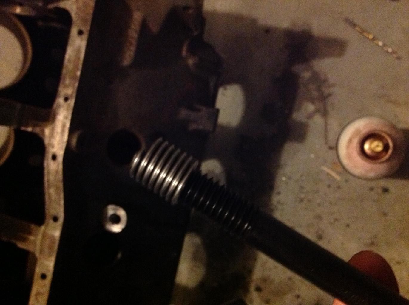

Found a broken off bolt in a motor mount hole. Tried soaking it with penetrating oil and heat it would not break loose.
Had to resort to a helicoil.
Dave, ALWAYS wire the engine block to mount bolts, never rely on just tightening them, I have had several cars turn up at my shop with bolts completely missing, one car had all four missing and the owner complained the clutch didnt feel right ! Frank
