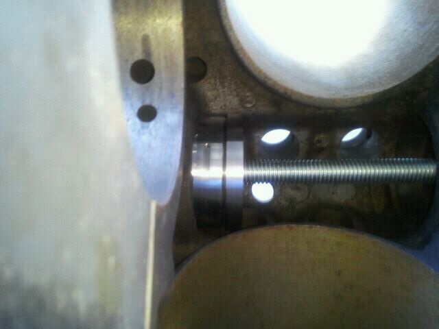

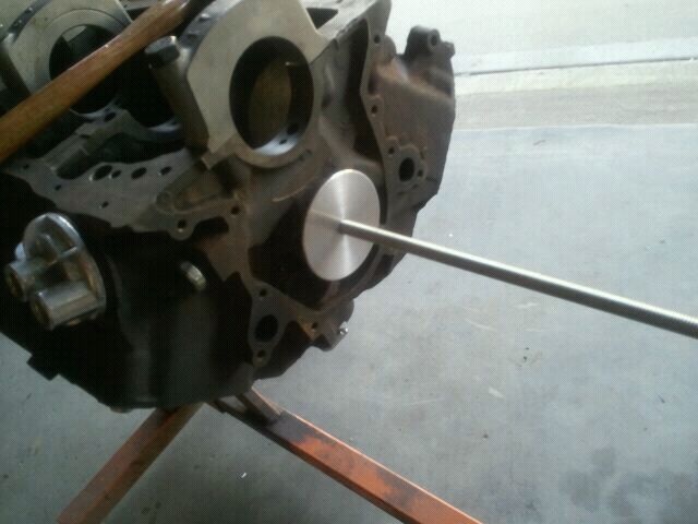

Over the years have made a few cam bearing installation tools. They all seemed to make it into some one else's tool kit. So took the old cam and made another one.

Been chasing a bit of information on the cranks I bought. Found the manufacturer and it is a 28 ounce balance crank. So started to trial fit the assembly. Bought King rod and main bearings.Picked up my rods from the machine shop.
Made slip fit wrist pin so I could check fit the pistons and crank clearance.
Jac Mac had said one of the problems with a 393 Windsor is how far the piston is pulled out of the bore when the crank is at the lowest point of the stroke. Well sure enough the crank counter weight fouls the piston skirt. Nothing a little milling wil not fix. The counter weight also contacts the oil pump so I will address that too.

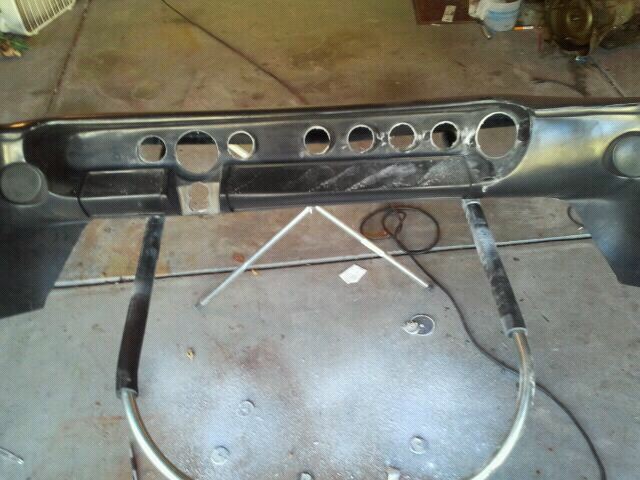

Got a bit of work on the GT done today. Got the second floor brace cut and welded in place for the pedal box. Cut the end caps for the drivers side fuel cell.
Cut the lower side plates for the rear up rights. Realized I have been putting off buying some hole saws too a trip to Lowes and picked up some. Hurried back home and drilled the dash for my gauge set.

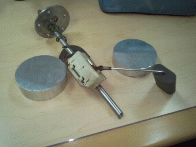

Started making the rings for the fuel guage senders to bolt onto. They will be welded to the tanks.

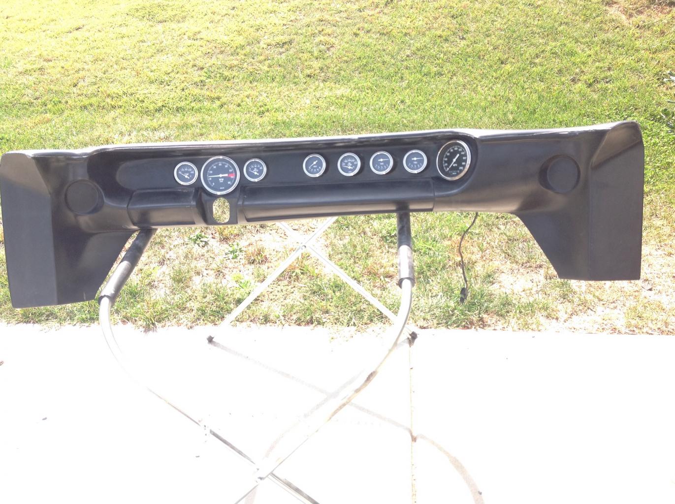

More work done today. Got the gauges installed in the dash. Also have the fuel tanks drilled with a hole saw for the filler and the fuel gauge sending unit rings.

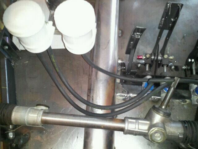

Got more done again today the pedal box mounting holes are drilled and the box is bolted in place. It has 3 AP CP2623 short masters on it. I also got the mounting bracket made for the fluid reservoirs. I used the AP large style reservoirs one with double outlet the clutch reservoir has single outlet. I need to get some adel clamps to fasten lines to the coolant tube cover that runs down the middle of the car.
