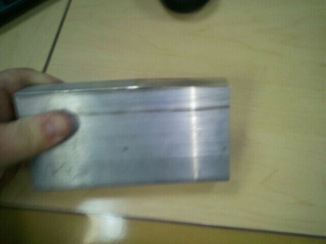

Started to machine the front brake brackets for the Mustang II spindles today. First cut an angle of about 3 degrees on the 1" x 3" x 5 7/8" Block of aluminium,

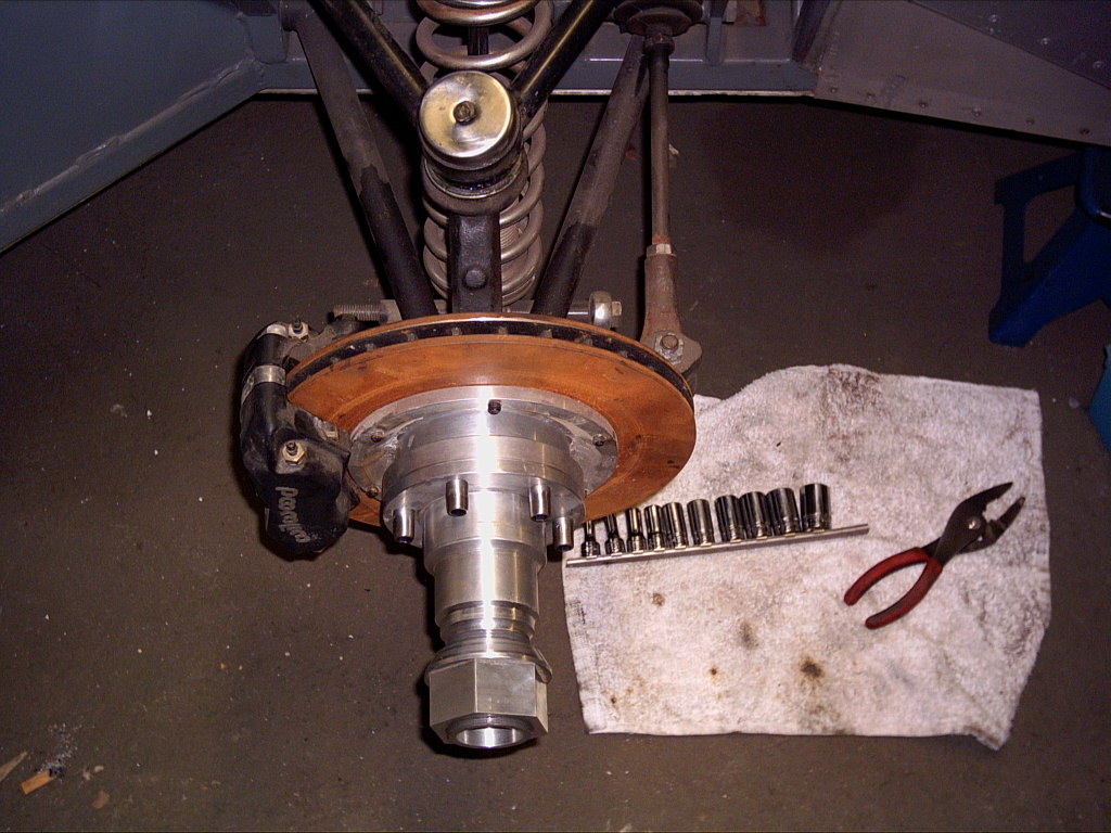

What brakes are you using on those uprights? Reason I ask is I went the Wilwood route but modified a lot of stuff, but there is always room for a few changes.
Keep it coming
Phil
Phil:
Using AP racing CP7751 lug mount calipers on 3.5" bolt spacing. AP replaced those with CP8250 forged calipers basically same dimensions. They will fit under a 15" wheel. They also make a radial mount version CP8350
They sound expensive....
I did a custom alum. hub to take a wheel adapter directly, and the rotor hat is set up to bolt directly to the back of the hub. Right now I am looking to upgrade to 1 1/4" thick rotors from 1"...but I am going to run what I got for now and do that after the first start-up and shakedown. Soon I hope, but you might catch me at this point.
Keep posting...looking good.... here's a photo of my setup.
Phil

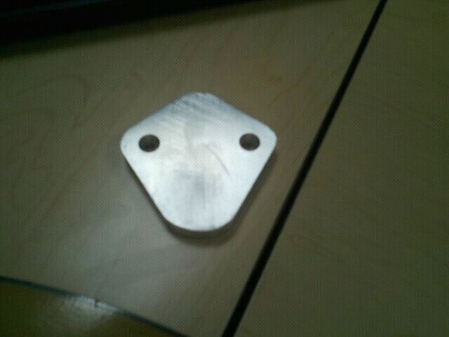

I realized I had forgotten to buy a fuel pump block off plate for the 351 Windsor. Saw some for $15.00 plus freight and others for $30.00. So I just made one on my lunch hour

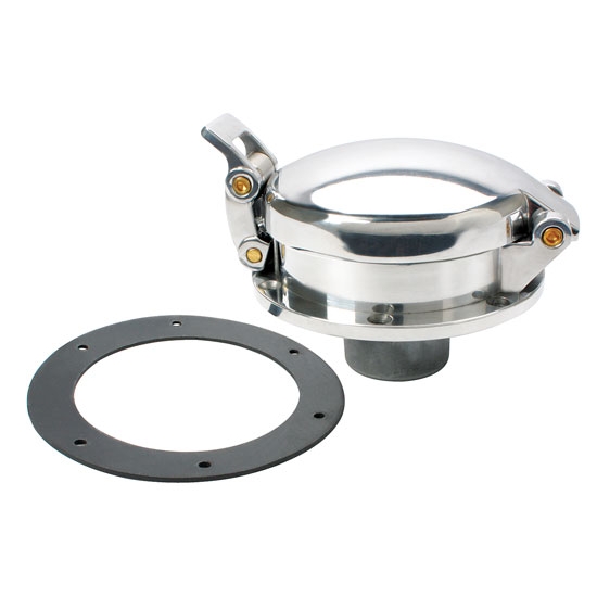

Got an e-mail today for a discount from Speedway Motors. I have been putting off purchasing the fuel caps for the car. Speedway sells the Cobra domed flip caps so I purchased both and a couple other items.

Dave, I wonder if there's enough material in the dome of those Lemans fuel filler caps to mill them flat like the original GT40s are?
I wish winter would finally give up.... We're having Ground-hog for dinner... :eek:
Hi Randy:
I received the gas caps. They nice are die cast units. From a quick survey it does not look like the dome is thick enough to mill flat. But I may at some point write a G code program for my friend's cnc to make Flat Tops. If I do this It will be open source for the forum.

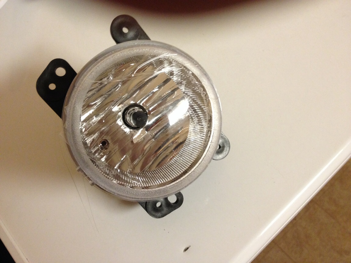

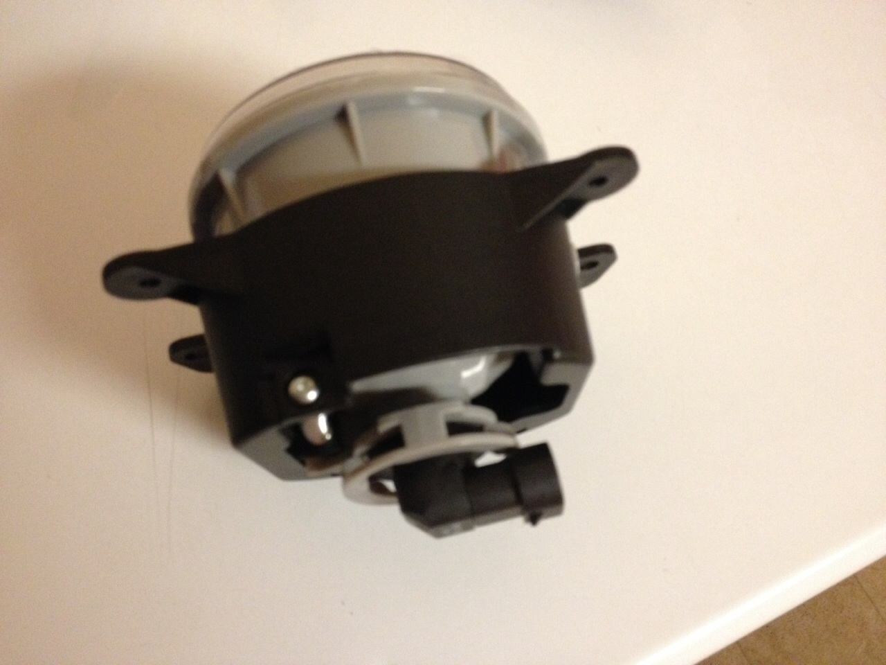

Been looking for some nice driving lights. Seemed most I ran across had angled mounts. These are for a Chrysler 300.

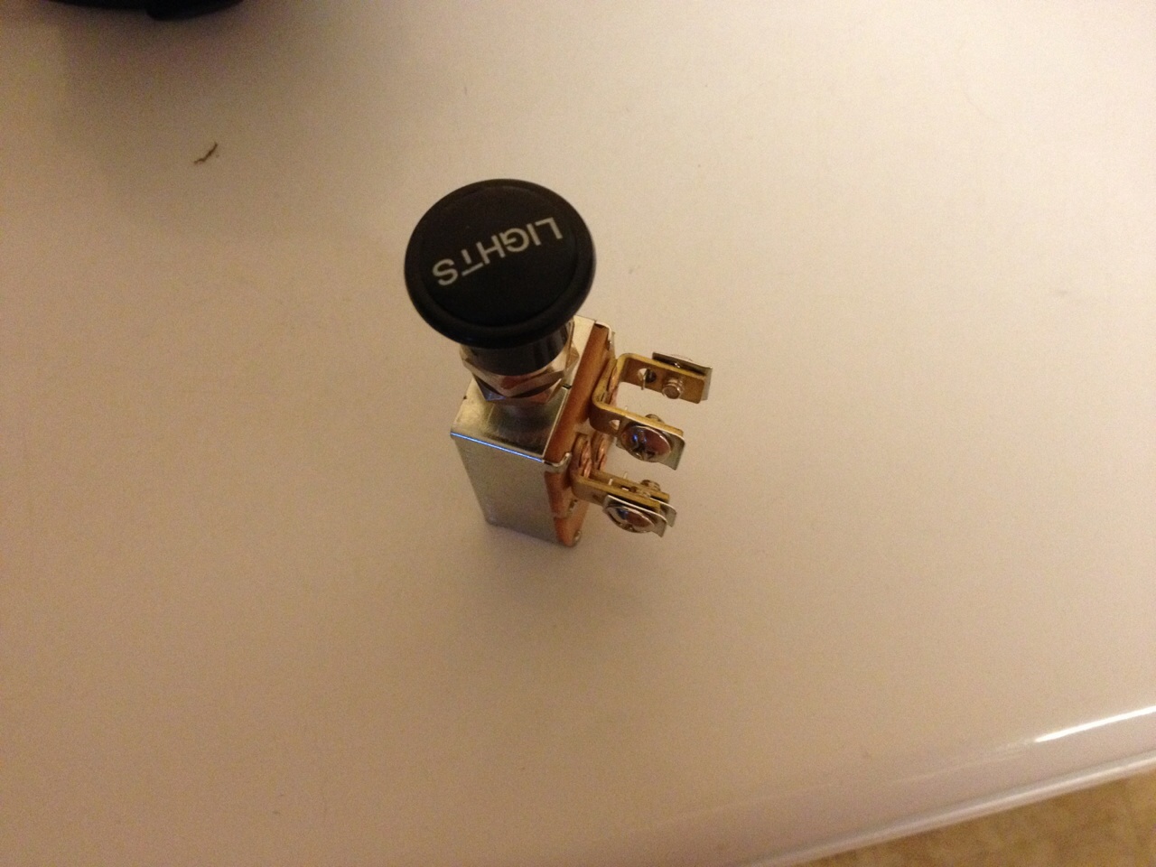

Found that Speedway motors has a nice light switch with a black labeled knob for Headlights. It also 2 accessory blades for parking lights and maybe Roundel lights

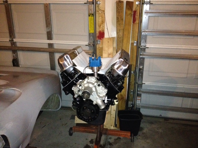

Been steadily working on the engine. Short block is together and one cylinder head installed. Hope to get the second one done and installed before Friday.
Both heads are now installed. Taking the intake manifold to get bead blasted tomorrow.
