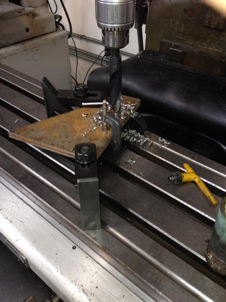

Today's lunch time project was drilling a 13/16 hole through 4 pieces of plate for the lower part of both rear uprights. A 6" piece of 3/4" OD steering shaft with 1/2" ID will go in the hole and be welded between 2 of the plates on each upright

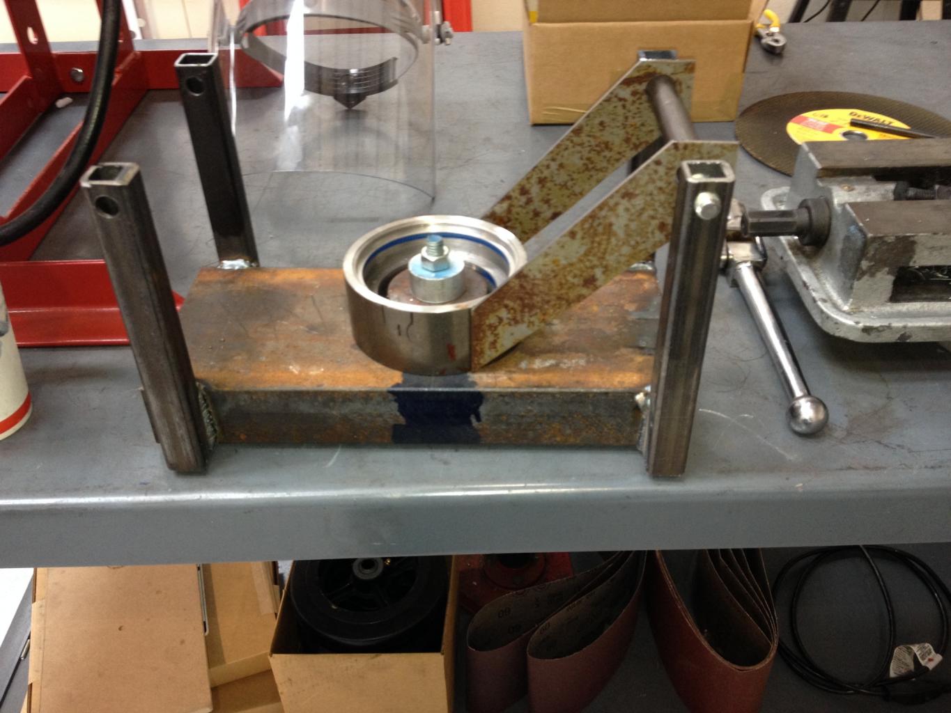

Been working on this fixture for a while got some side parts cut out yesterday on lunch break.

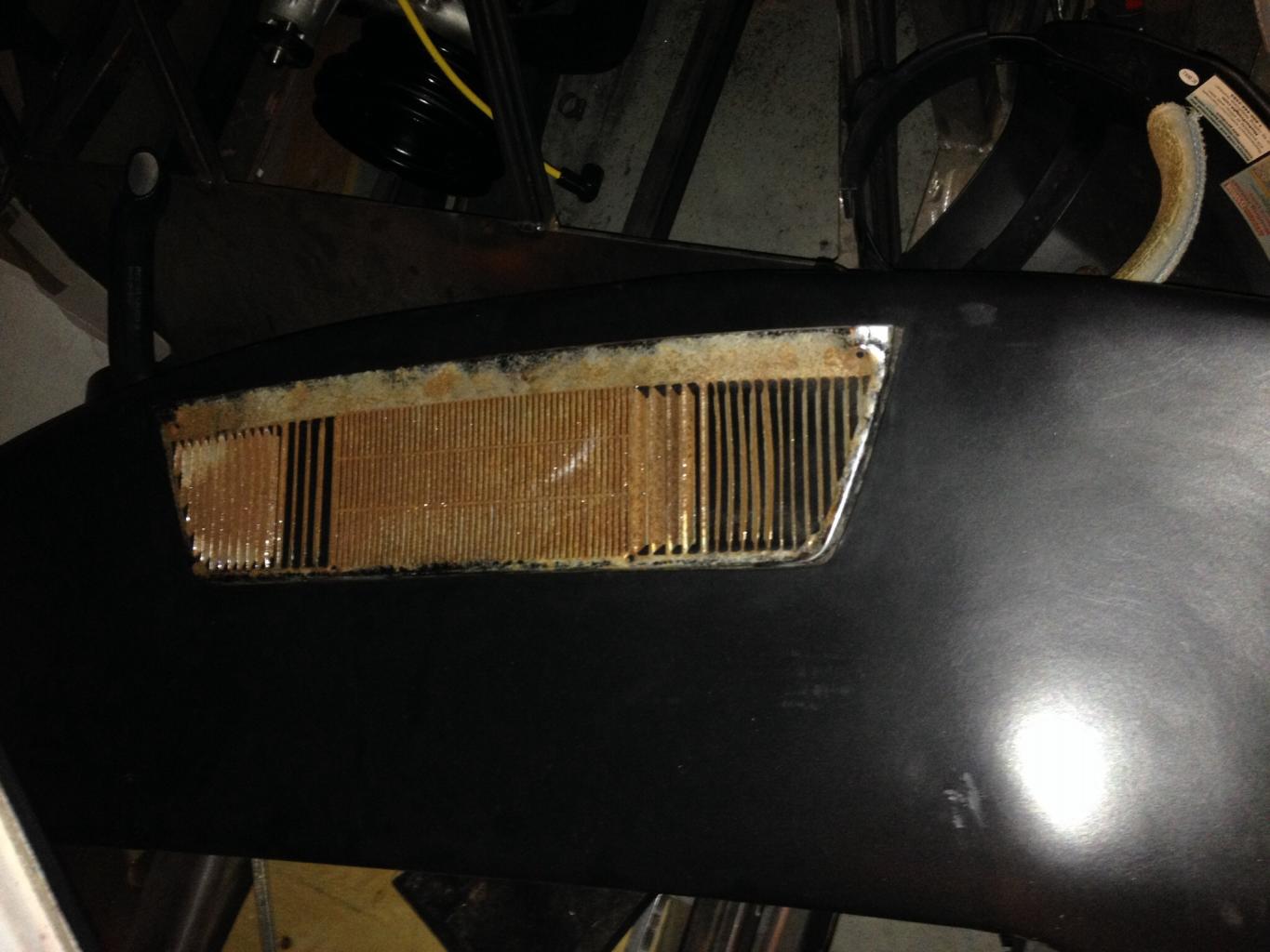

Today's mail delivery finally brought my demister grille. All the way from the land down under. It is a bit rusty and a few of the louvres need a bit of tlc. The 40 will now have parts from three continents and the U.K.

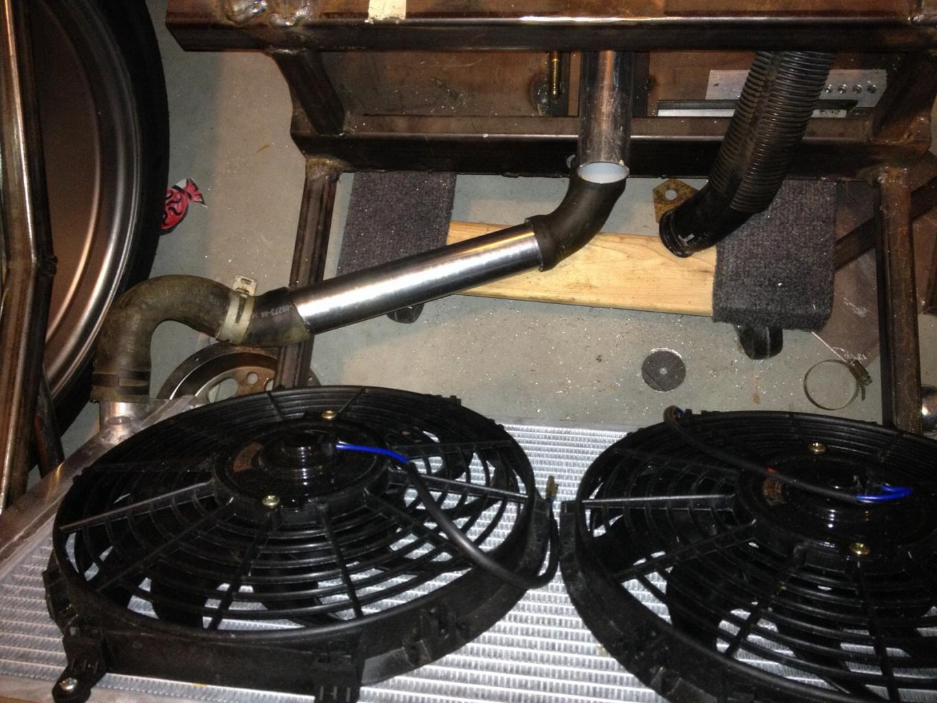

Been working on a couple parts of the 40 and have been to busy to post. Started mocking up the cooling system down the center of the chassis. Using some old hoses to get an idea of what I need parts I need to do in aluminum an silicone. I will probably use the old to get engine running also then buy new for final assembly

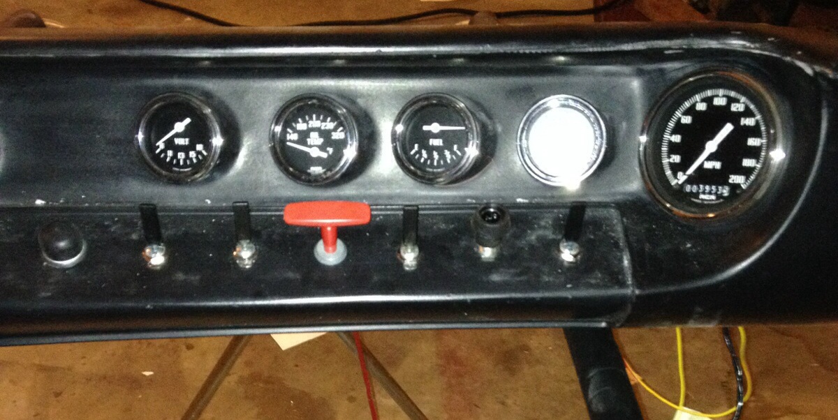

Worked on the dash a bit again tonight. Installed some switches and the starter button. Fire t handle for my A FFF system. Need a couple more switches
