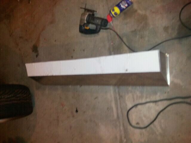

Gas tanks were started a while back. I had them 5052 .125 thick material bent in a U shape. I totally under estimated the force it would take to bend the outside leg inward about 30 degrees. So when you cannot muster enough force. Lessen the force needed. The tanks are 48" long so using the drill and jig saW.
I cut two 12" long slots along the outside leg brake line leaving two 6" segments and one 12" segment where the leg was not cut. To relieve the amount of force needed to bend it by half.
it worked and my drivers side gas tank is bent to shape. Of course the guy welding these for me has 24" more welding to do.

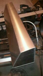

Worked on the gas tank for the passenger side today. Cut the slots as I did with drivers side so I can bend it. Also added vent hole and access hole for adjusting gas gauge sending units and cleaning tank.

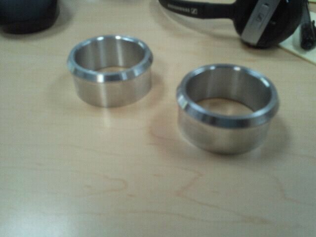

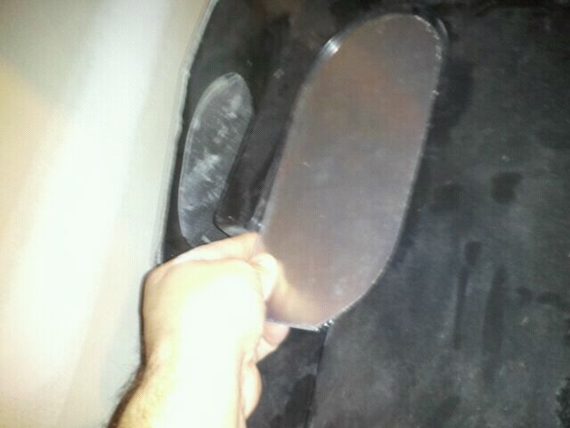

Needed to make interior door handles. Opened a box in my garage that was from my move to North Carolina. Found a bunch of handles from some 2 lever shifters I used to make years ago. Ah ha interior door handles.

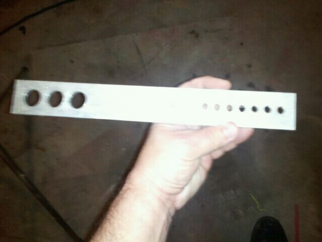

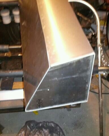

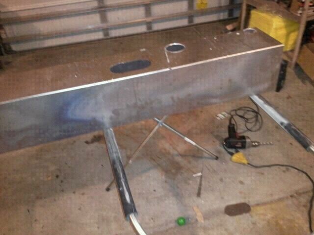

The second fuel tank is now ready for welding. Also cut the supports for the front clip.

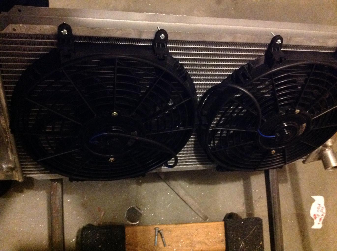

Installed the 12" cooling fans on the radiator that I got for Christmas.

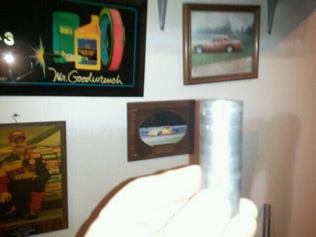

Today I finished up the clearancing of the piston skirts for the crank counter weights. Used a dremel to hand clearance each one and a pin I made on the lathe at work to test fit the pistons in the block.

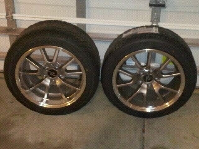

I like your wheels, where did you get them from? They don't look like usual offset for GT40.
Renato
Hi Renato:
Thanks:
The wheels are FR500 mustang wheels. I got them from a place called Wheel Replicas. The offsets are better suited to Mustangs. I am having to build custom rear uprights in order to use them. Tried to use CAV rear uprights but would not work.

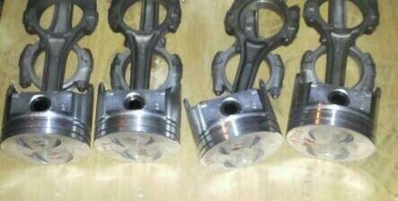

Well in 2008 when the economy took a dive. Some of my extra money seemed to go right along with it. The kids,the cars, the house come first. The forty some where after that. The forged pistons I wanted cut from the budget, the floating wrist pin rods they went along with the aluminum heads In the late eighties and early nineties I put together several engines for my buddies Ford Torino Street stock car. We used stock rods and plain old cast flat top pistons. We beat the snot out of that old car 15 to 20 nights a year. We never had a crank or rod failure so with that in mind got some hyperutectic pistons and using stock rods that have been magna fluxed and checked. Because this is a stroker it will not see super high Rpms any way. So after saying All that my pistons are mounted the the rods.
