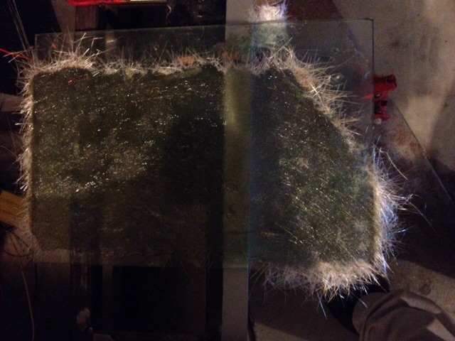

Making the center console out of fiberglass. I had seen this technique in a video for building custom speaker boxes. Laminating a flat sheet of fiberglass on a piece of tempered glass from an old end table.
Wax with mould wax a couple coats and it comes right off. You can trim it with a razor knife when it starts to harden if you would like

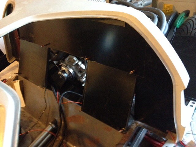

Started the day off making rear clip hinges.
Ended the day with rear clip mounted on the chassis with the hinges

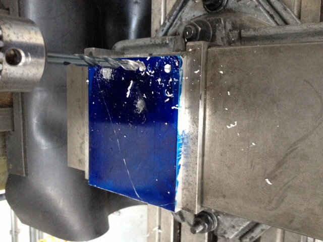

Here are some pics of making the rear clip hinges. I scaled a photo using the hinge bushing size of 1". I enlarged the photo on my iPad. Traced the photo and made a pattern. Dykem on the aluminum and center punched the hole locations.
