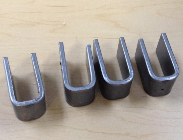

Made some clevis brackets to go from rear uprights go heim joints on the trailing arms. Used 3/16" thick flat steel 1 1/4" wide

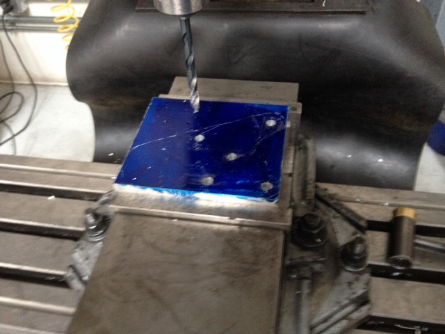

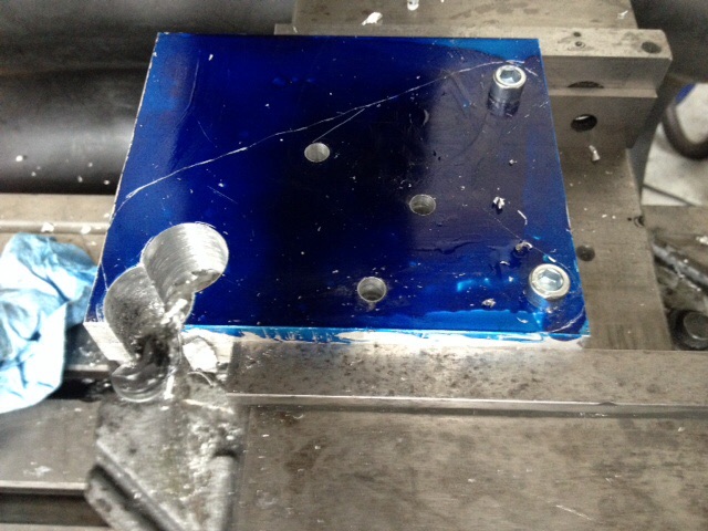

Have been working a bit on the rear uprights. Drilling and tapping to hold the Scorpio bearing carriers. Anybody who is using Granada rear bearings care to share what grease they run in them?

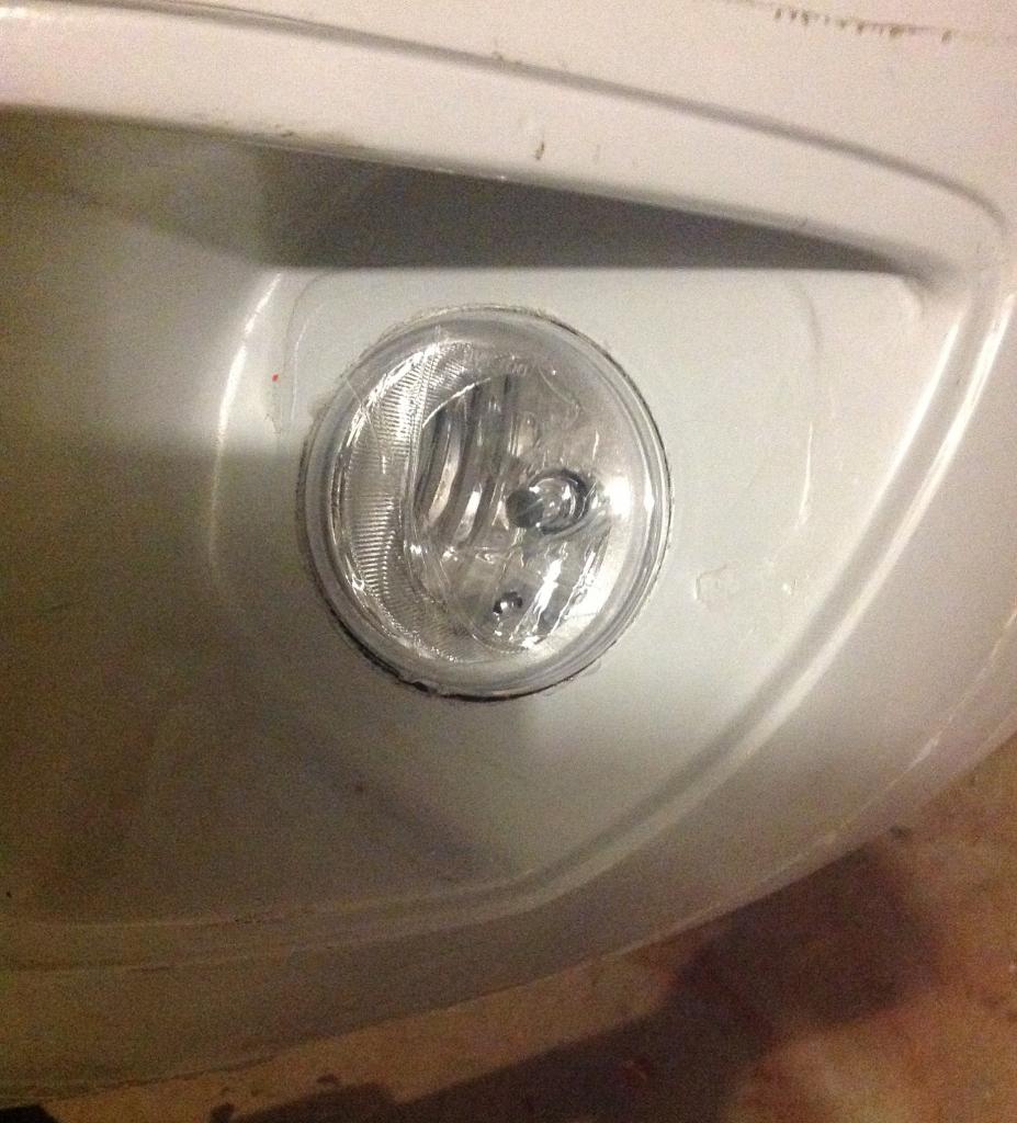

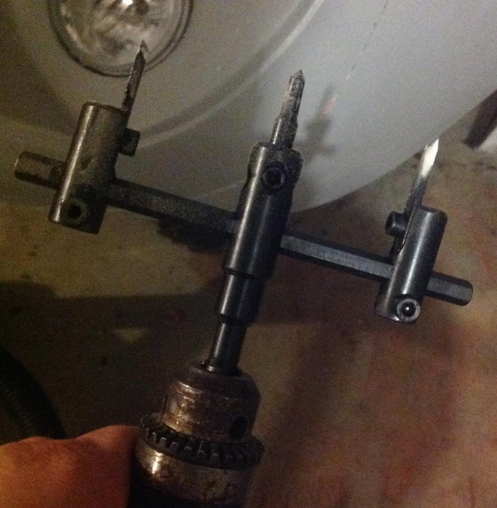

I tried using one of those hole cutter like that for my tail ilghts.. Made a mess of things as it was very difficult to control... Glad to see you have a steadier hand.
Sorry to hear that Randy. Did you drill a pilot hole? I do have a larger drill with a good sized handle. It was a variable speed.
