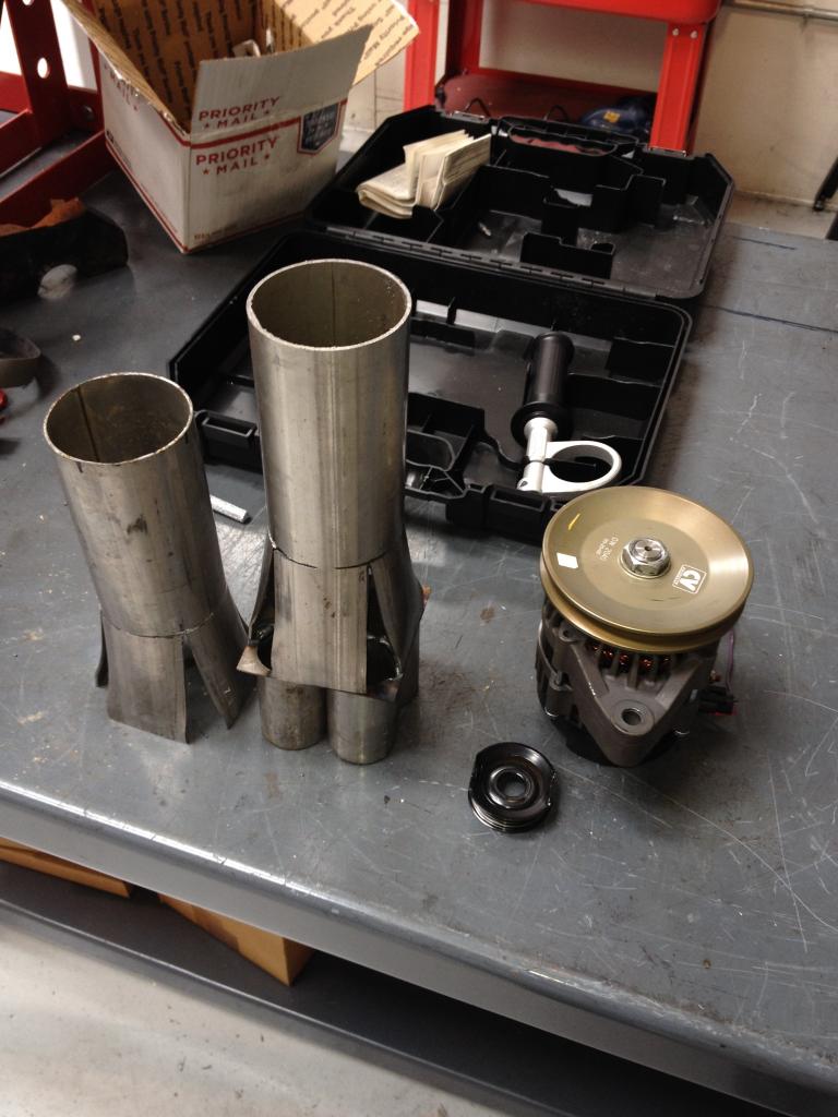

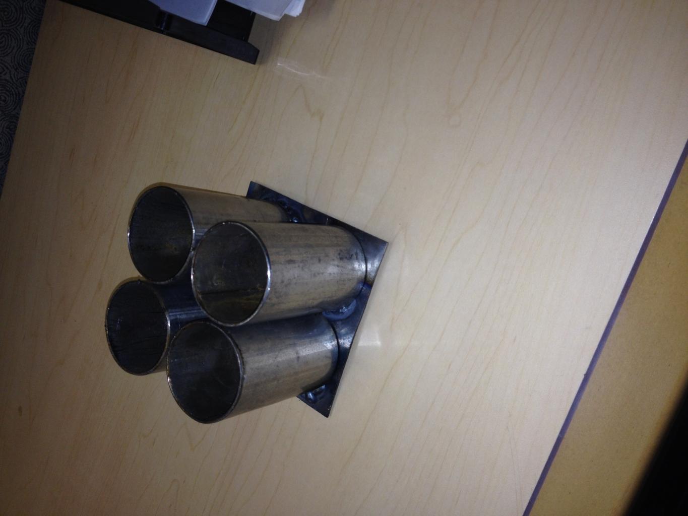

Been working on making collectors

Added the 20w50 life blood to the engine tonight. Also made another plate with 4 holes for the second collector. Pulley came for the alternator have to remove serpentine belt pulley and install v belt pulley. Working on the dura spark box for ignition. Hope to have a rumble in the garage soon!!!

Curious alternator pulley with flats on it. I take it that was only way you could lock up the shaft to get the nut off? I usually use an impact gun and even with a loose shaft the nuts burp right off..
Hi Randy: I tried ratchet first. Pulley was damaged in shipping so I just cranked the vise tight. In the end we used an impact came right off.

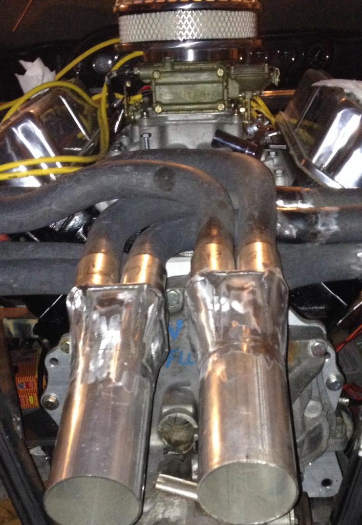

Finished welding the header mods I had to make today.
Now have to finish the collectors. I will have to put he rear clam on to get the proper angle for the collectors
