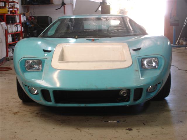

I have the Hella Supertone horns
Sound level is 118db. They're a little higher tone than domestic car horns. More of a European sound, but freakin' LOUD!
I have mine mounted in the front light boxes behind the headlights. The sound comes out through the inlet ducts.

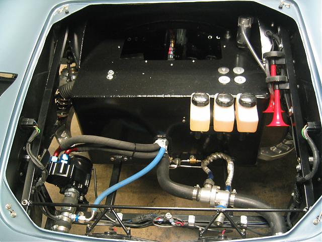

Here is where my Horns are mounted, they are air horns and work well.
I cant remember the brand, but will have a look tonight if you wish.
Dash mounted button, but awkward to get at in a hurry.

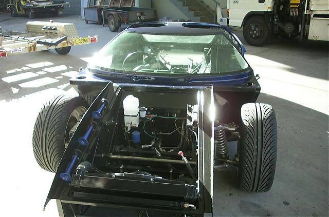

I bought an electric horn, rated at 121dB, as I remember. The loudest of the ones I looked at, but they were all within a few dB of each other.
I mounted it as far forward as possible, in an opening, so that the maximum sound went at whatever needed to get out of the way. Since the photo, I've raised it so that it's not visible, unless you're kneeling right down.
The horn is operated from a stalk on the steering column. I used XD Falcon stalks for this reason. No horn button to complicate the removable steering wheel.
Lance

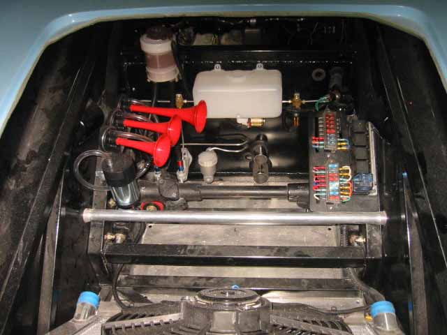

Fiamm Air Horns - very loud. Compressor is the blue cylinder on the bulkhead.
All operated from the centre steering-wheel button & a relay.

The horns are covered by the light box. They are also offset from the air inlet. The aire inlet is plumbed as an inlet to cool the brakes (see below). Since there is complete flowthru, any debris should move through the inlet to the brakes.
Dutton

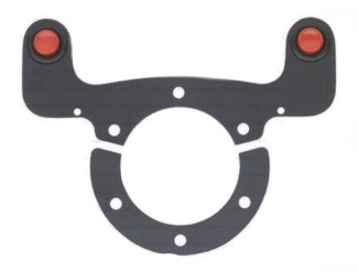

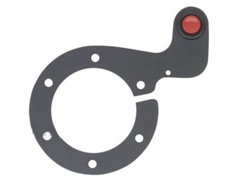

Pat's latest comment got me to thinking about how and where I'd prefer to mount a horn button in the car. For me, drilling holes is pretty much out of the question because of the reproduction steering wheel I obtained last year, however, reaching for a switch on the dash doesn't seem like a wise choice should I ever have to go evasive when some inattentive soccer mom driving a tank pops into traffic without so much as a glance. And there are just too damned many of them in my part of the world!
So I went to looking. While I wasn't able to locate anything reasonable (to me) which could be mounted ON the steering wheel, I did find a little something that should mount just under the wheel and, in the case of the dual-button set up, the second button could even be used for intermittent use of driving lites or even line-lock should some one opt for that method of parking brake.
Here's the model numbers:
Sparco 015NE981 (single button)
Sparco 015NE982 (dual button)

Ron, what is that thing on the left side of the photo with two black hoses and a blue hose running in to it?
Looks like an electric waterpump but I can't figure out the function of the blue line....maybe a bleed line???
Ron McCall
Tim is absolutely right! It is made by Meziere and flows 55gpm.It works great!
The thing on the other side is the thermostat housing.
