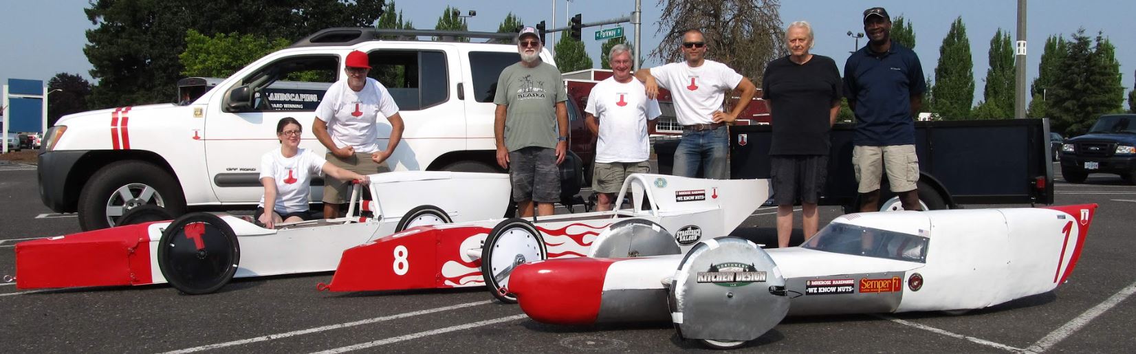

A shot of the fleet from last week:

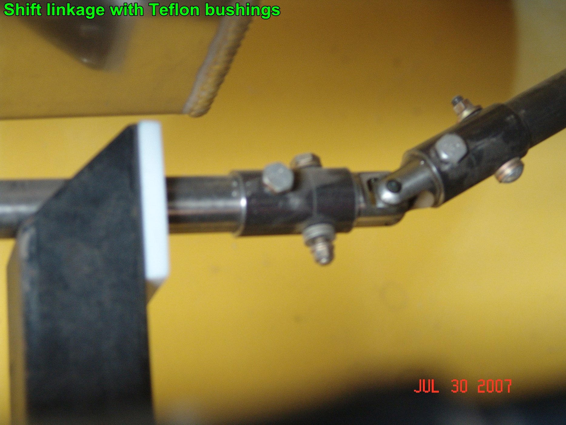

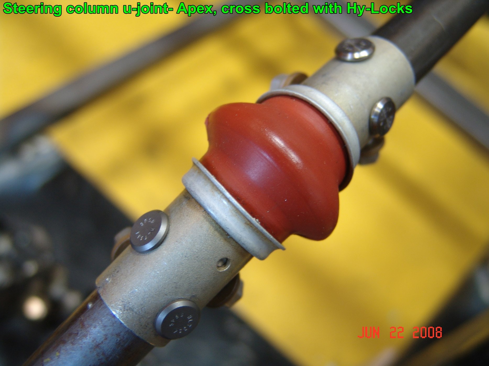

Chris;
It is good practice to cross-bolt tube joints rather than use only one bolt. Redundancy is your friend.
