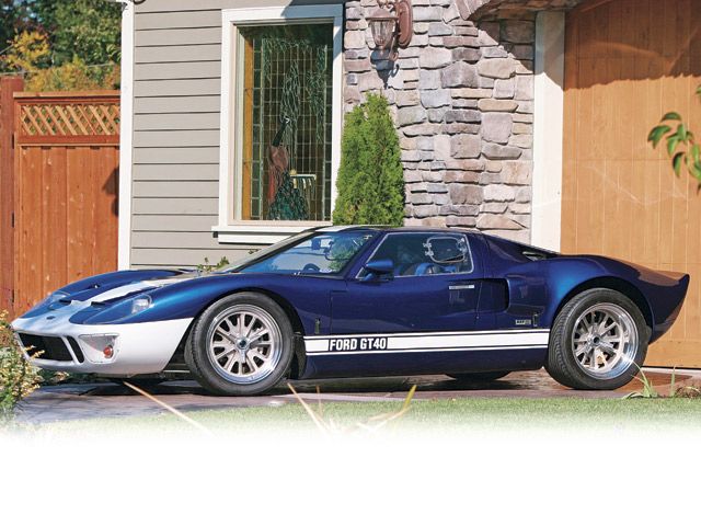

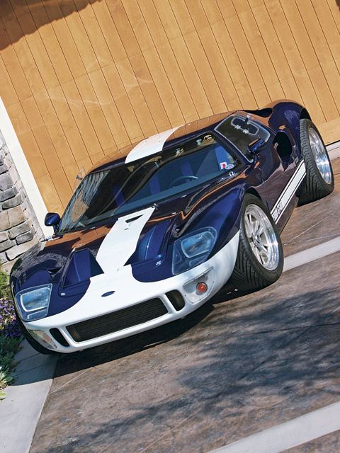

GL with the build, I noticed you want to go blue, heres an idea of a really cool looking blue. Not sure whos car it is, but that blue looks really good. Just a thought for you :)
Take care
Nice colour, that's something along the lines of what I was thinking although I'm not a big fan of the chin, so I think just a straight stripe. Maybe the side stripes but plenty of time to consider those.
