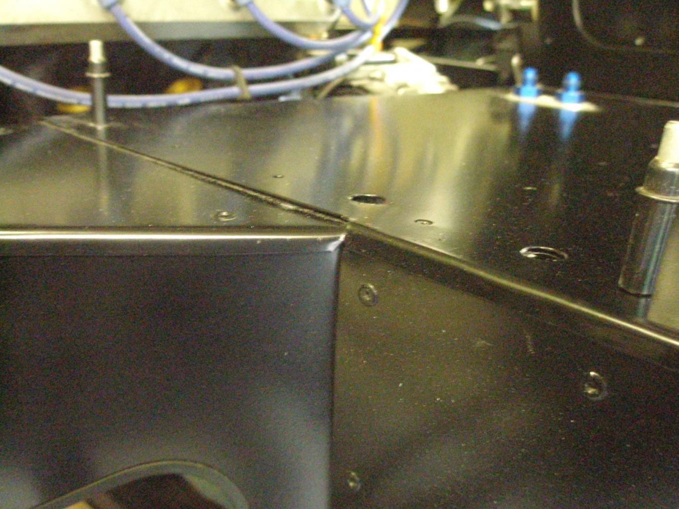

Yesterday I fitted some edging trims, they do finish off the panels nicely but it's a lot of work and in doing so had to remove some of the nicely placed rivets and fit countersunk rivets so that the edging lays flat on the panel.
Worth remembering if your going to edge trim.
I will post a picture when I can on my build,, you can see what I mean.
You can buy countrsunk rivnuts but they still are not 100% flush
Practice on an old panel, then you can choose !
