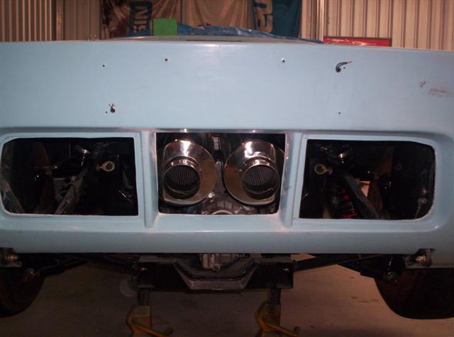

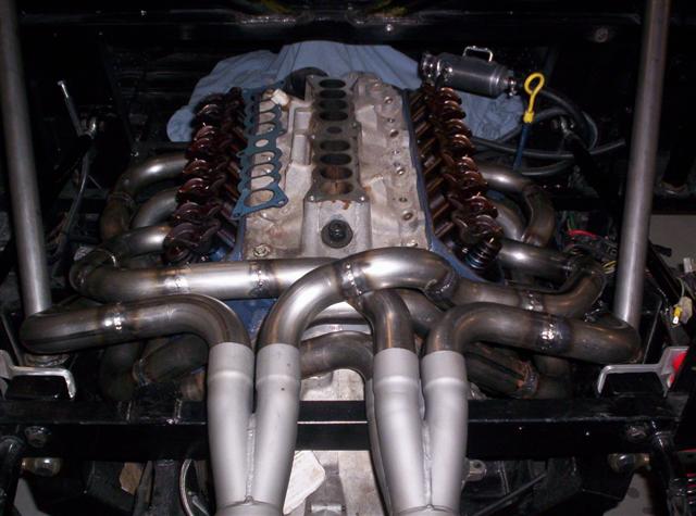

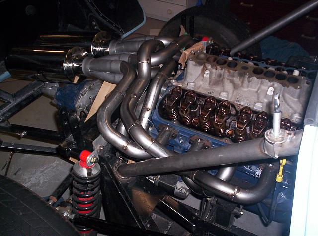

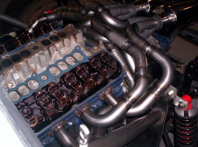

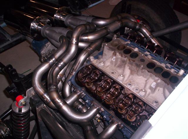

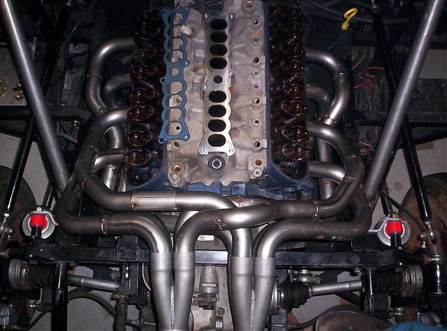

Hey Guys
Just a few pics of exhaust system as it is progressing. Still need to tack a few spring clips to collectors and pipes and then some black HPC coating.
Hopefully the HPC stuff will work as advertised.

Re: Chassis #64 due in July
Very nice work Dave.. :)
I like the design a lot - especially the routing of the cross-overs..
May I inquire as to why you chose divorced exhaust flanges over a single 4 hole flange?

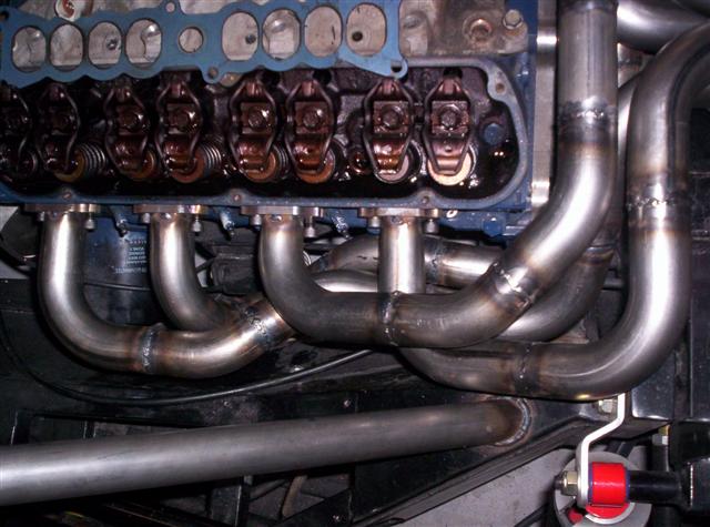

Hey Randy
Congrats on your RCR purchase by the way, looking forward to reading the build thread.
I'm not sure what you mean in regards to the exhaust flanges but will assume you are talking about the flanges that bolt to the heads, they actually came as a one piece unit which I cut into 8 single flanges to aid removal and fitting of the cross over pipes. The flanges are very large as I have used 1 3/4 inch pipes.
Thanks Dave - Looking forward to the build with great anticipation!
Your explanation on the head to header flanges makes perfect sense.. My only reason for asking is that I've had some bad experiences with divorced flanges in the past once they've gone through a few heat-cycles. Seems that the pipes get a lot of additional forces in them that want to twist and move the flanges from their intended locations. It's fine when everything is bolted up, but once removed and then subsequently re-installed, the blasted flanges are far from where they need to be to bolt up.. But thinking further - these headers had the primary tubes welded solidly to the collectors rather than slip-fit..

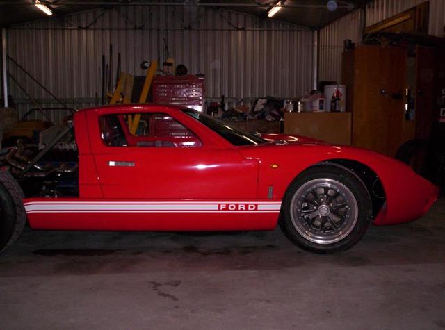

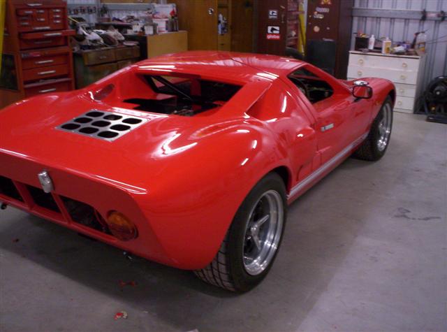

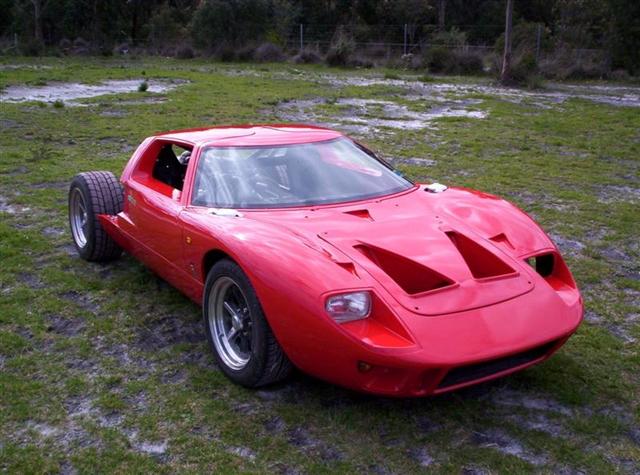

Hey Guys
It's great to see some interest in the car. Painting is almost finished.
Thanks for sharing Dave. Looking good. I look forward to a few more pictures with the rear clip when it is done. I am particularly interested in your car for a number of reasons, the most pressing is that there is not a whole lot of DRB's without the wide rear arches. There are a few such as Pete Delaney's but I would like to see a few more of them to get a feel for how they look in a variety of colors etc. Plus, i enjoy your energy of the build!!!
Regards
Jack

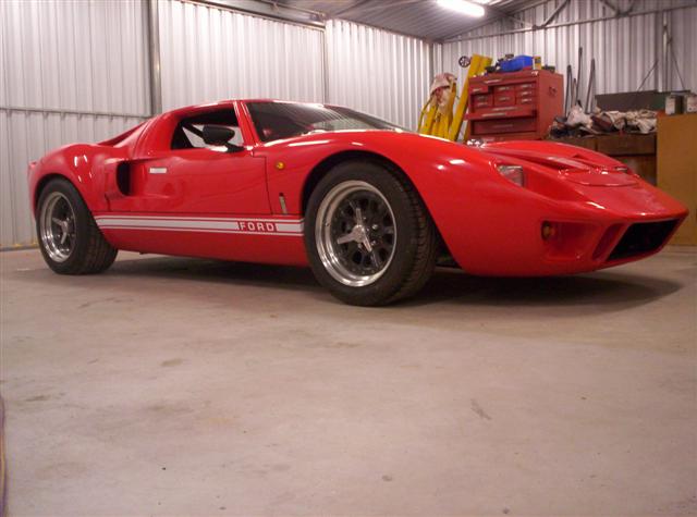

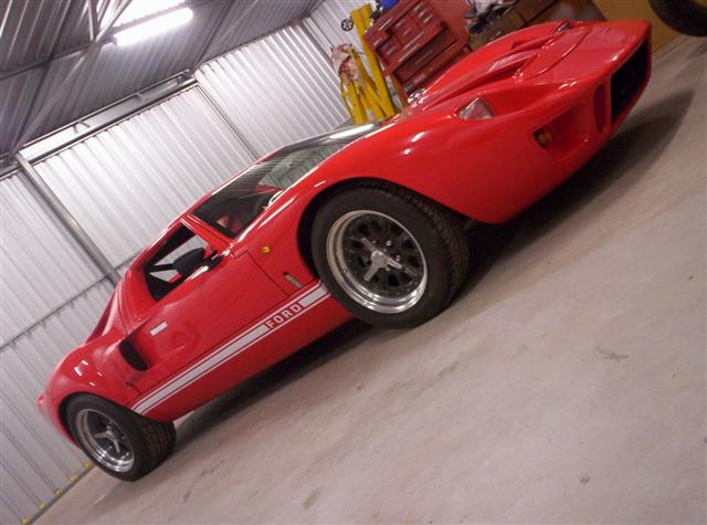

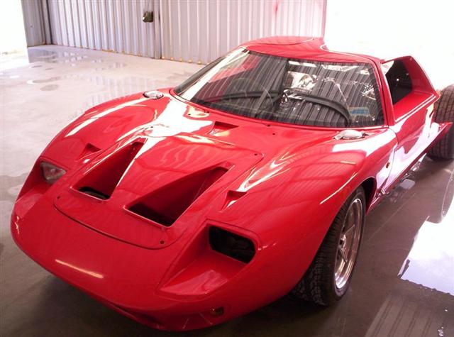

Hey Guys
A couple more pics of the car. Hoping to be driving again in a couple of weeks. Still got heaps of odd jobs to do so can't rest yet. Hope to get some shots in the sunlight soon.
Looks great Dave. Well done. When will you be out to play with the toy ??
Collie sprint is Nov 4th. May make a nice debut.......
