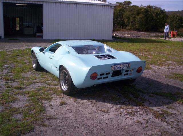

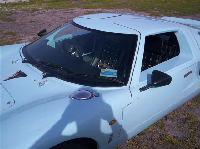

Took the car to Perth on Monday, waited 5 hours in a queue for my inspection. Had my test and now I have a licensed GT40.:pepper: :pepper: .
The Inspectors at Welshpool are a great bunch of Guys under a lot pressure with huge waiting queues lasting all day. Will have to come up with a custom plate.
Now onto painting trimming and engine performance.

Been meaning to ask you about your side mirrors - Where did you get them and do you like them and the position they're in for driving?
Thanks!
Re: Chassis #64 due in July
Hey Randy
The side mirrors are cheapies from my local parts store 'Super Cheap'.
The positioning for rearward vision is acceptable for this type of vehicle.
I have the standard width rear clip, I don't think you could use them with a Gulf rear clip. When it came to choosing mirrors I couldn't find exactly what I was looking for so I grabbed these ones. If you want a set I could send them to you, as I think they are only $60 AU a pair. :)

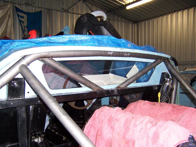

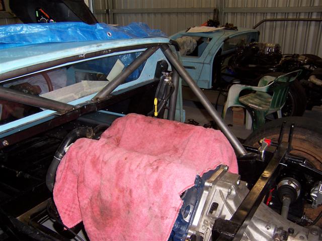

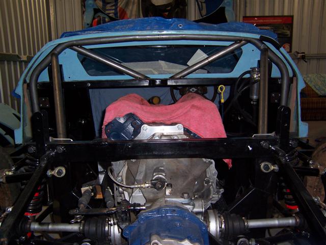

After a few days break from the car, to much talk and not enough action.
I've started on the rollbar installation. I can hear you all saying why didn't you get that option from DRB, Well the answer is I can't bring myself to pay for something I am fully setup to do myself and have saved myself near on a grand aswell. Dummied up the bars and just need to weld in for final time. I was going to TIG the cage but have opted for the lazy way and will MIG it in after I get CAMS approval.

Great workmanship Dave, but I think it needs to be inside the cab(a PITA) for approval--best check with CAMS -- ROPS though.
