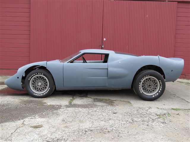

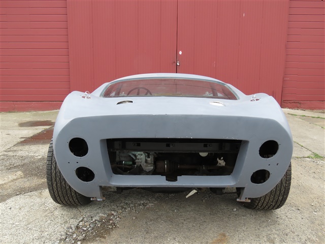

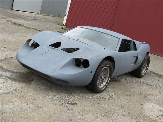

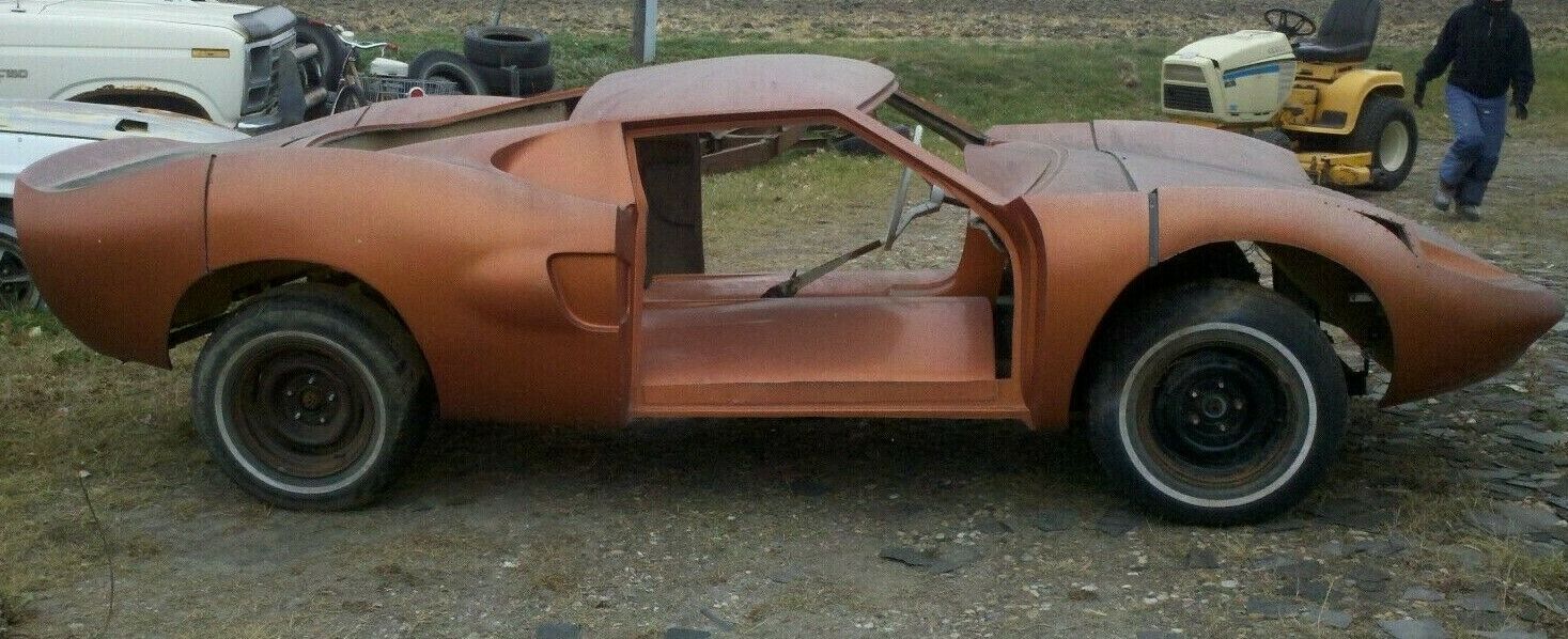

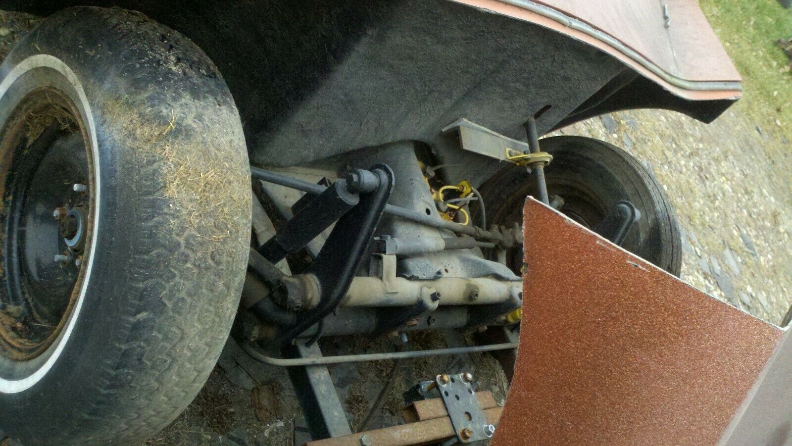

Just bought this kit car off eBay. So where to begin? Never owned a mid-engine car. Currently has a VW transaxle. No clue how much HP that can handle. I wanted to drop a 302 in the back. A lot of older mustangs for sale around my area. Was thinking of buying one to use as a donor car. I'm a little overwhelmed and any advice on how you would begin this project would be appreciated...Mike
Car due to arrive mid-July.

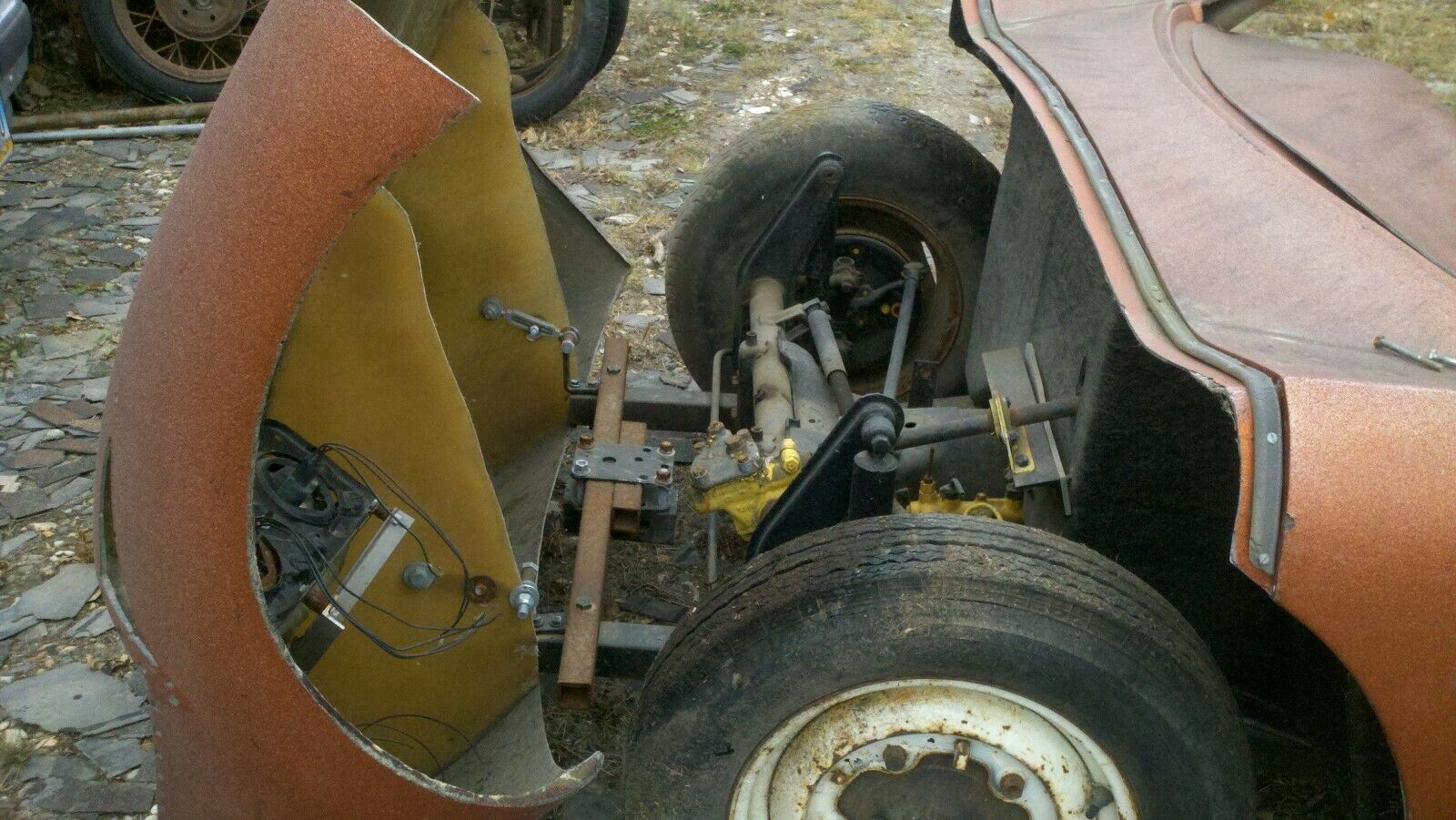

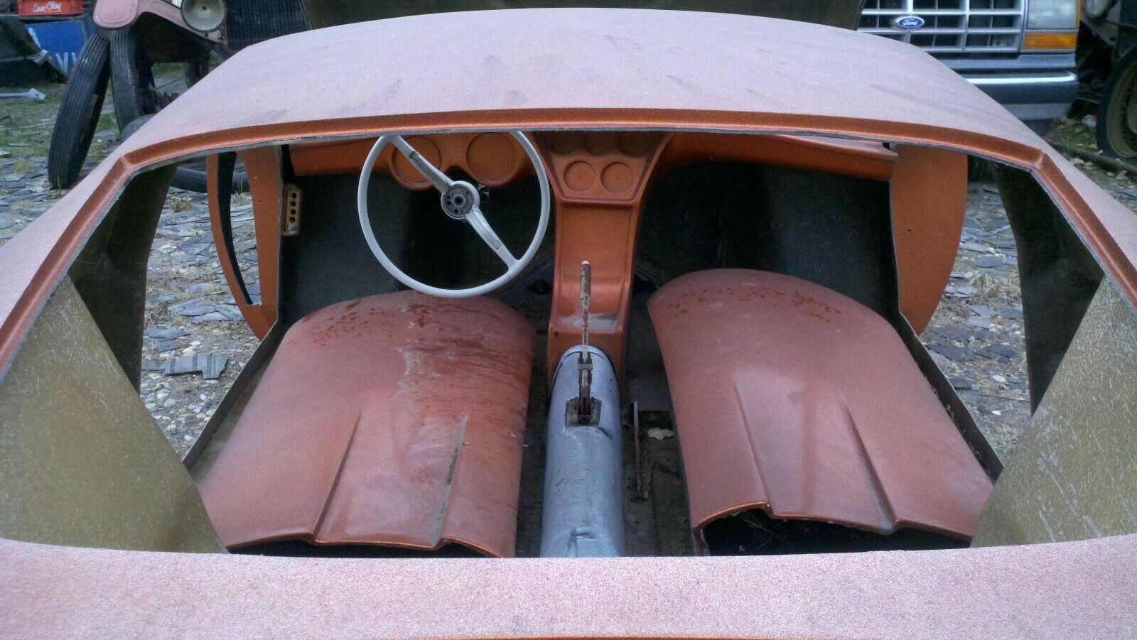

Your Avenger was built for a 36 hp VW engine; an iron-block 302 is NOT going to work for many reasons, one being that it is not a mid-engine layout. The engine hangs off the rear of the transaxle so it is a rear engine car. The weight of a 302 hanging off the rear is not going to be feasible. Yours is a swing-axle tranny so the handling- even with a VW engine- will be treacherous. The VW trailing arm front suspension is also not a good design. A VW pan is not a very rigid chassis, either.
I'm sorry to disappoint you, Mike, but I suggest selling it to someone else. To finish this Avenger will take a LOT of time and effort which would be better spent on another project that would yield a more satisfying result for the same amount of effort and $.
Or you can hone your car-building skills by completing this car as a VW powered unit.
If you mind your budget closely, you may have something you can make a bit of money with.
Start looking for a VW Donor...
I'm retired, so time is not an issue, and I got some money. (If I had a lot of money I'd buy a real GT40) Reselling right away is not an option. Wife is ready to kill me already. So from what I gather so far the VW frame is shit. So going back to the donor car option. Plenty of mustangs maybe even fieros by me. I have plenty of tools, planning on taking a welding class in the fall.
So I guess when the car comes, measure the dimensions and figure out a better donor car? Not really interested in keeping the VW chasis if it's meant to hold 32HP

Looks like low budget , FUN build to me. First thing I'd consider is that I have seen the V8 Tornado versions for sale up here in western Canada for real reasonable running and driving so you may consider one of those if you want to scare yourself...but what you have there looks fun too.
King link front end is fine, you can throw on dropped spindles cheap.
Disc brake kits all the way around easy to install.
VW pan is pretty simple to repair and beef up with modest welding skills.
Conversion to IRS bus tranny 3 ,5or 6 rib should be done, Easy to do. Sell the swing axle to a beetle guy.
Subaru engine conversion for more HP or look for a stroker vw.
Heck if you look around for someone selling a good old school sandrail you could use it as the parts donor.
Just keep it fun and low budget.

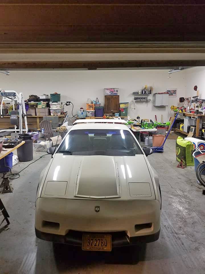

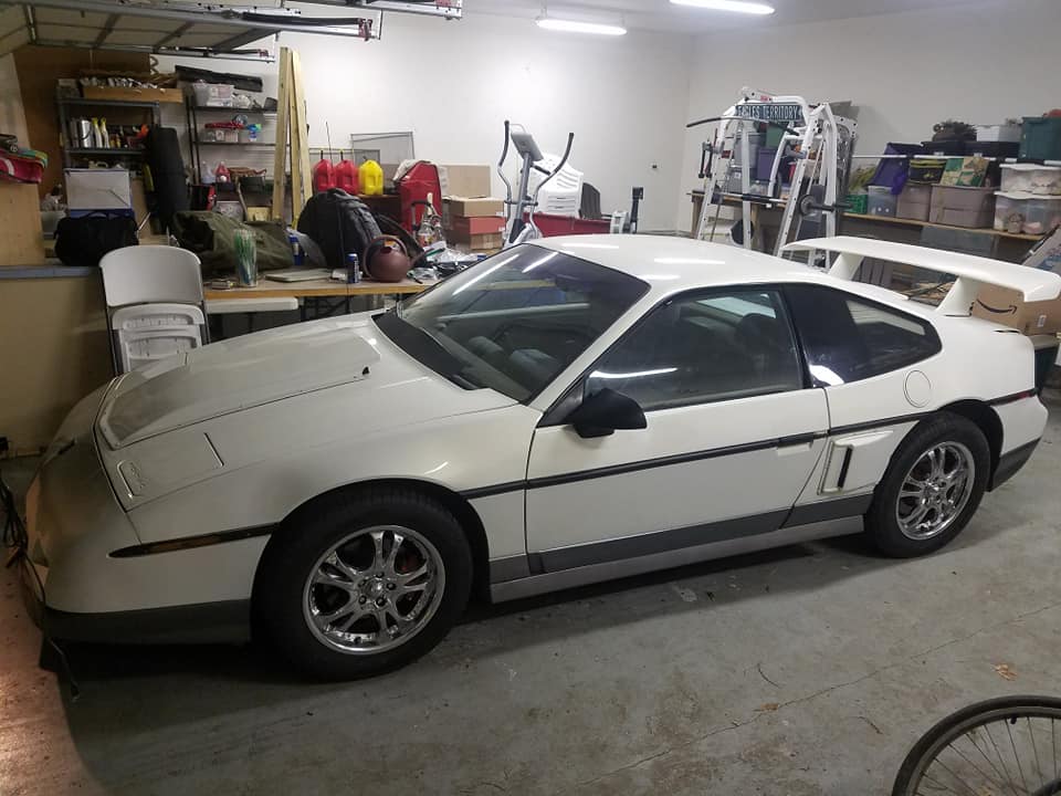

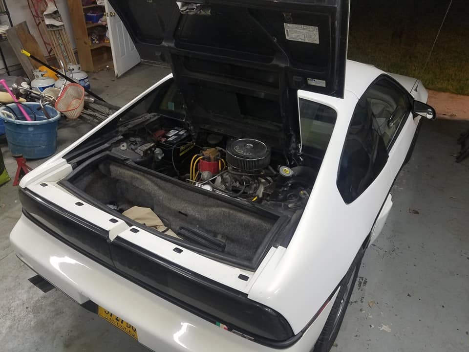

Donor Car. Found this car for $1500. This is what is has:
86 fiero gt with a v8 archie motor swap. The kit consists of - Engine/Trans. Adapter Plate 6061 Aluminium Front Engine Mount A/C Mount Torque Strut Rod Starter Mount Block Harmonic Balancer Pulley Custom Flex Plate Adapter Flex Plate adapter and Flexplate 1985 and older SBC engines Remote Oil Filter Kit Remote Oil Filter Adapter High Torque Starter Electric 34 gpm Water Pump The motor/trans setup is currently a 406ci with a edelbrock 750 performer, mated to a 4 speed automatic with a shift kit and lock up torque converter.
VW Beetle measurements: FIERO measurements:
160.6 length 160.3 length
width 62.4 inches width 68.9
wheelbase 94.5 wheelbase 93.4
With some minor fabrication is this doable? What problems should I expect/anticipate?

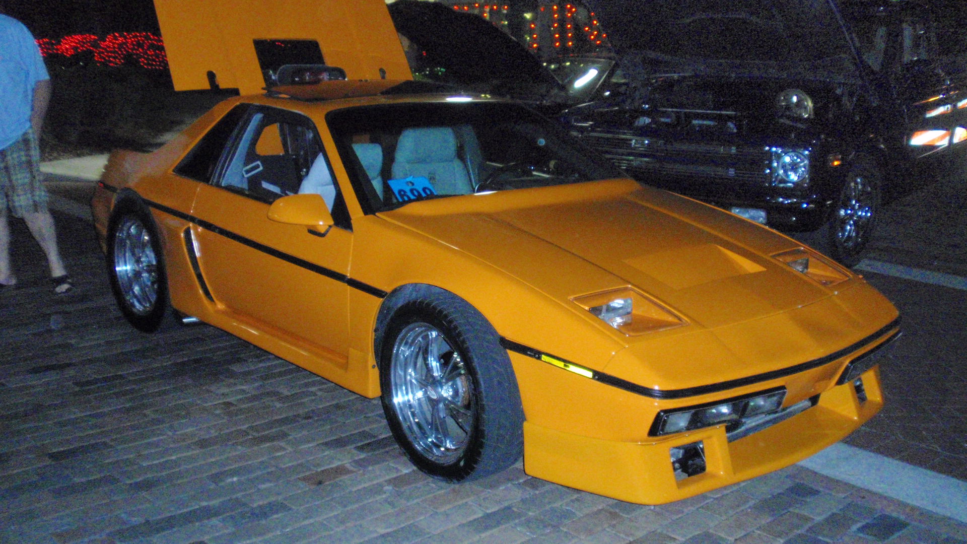

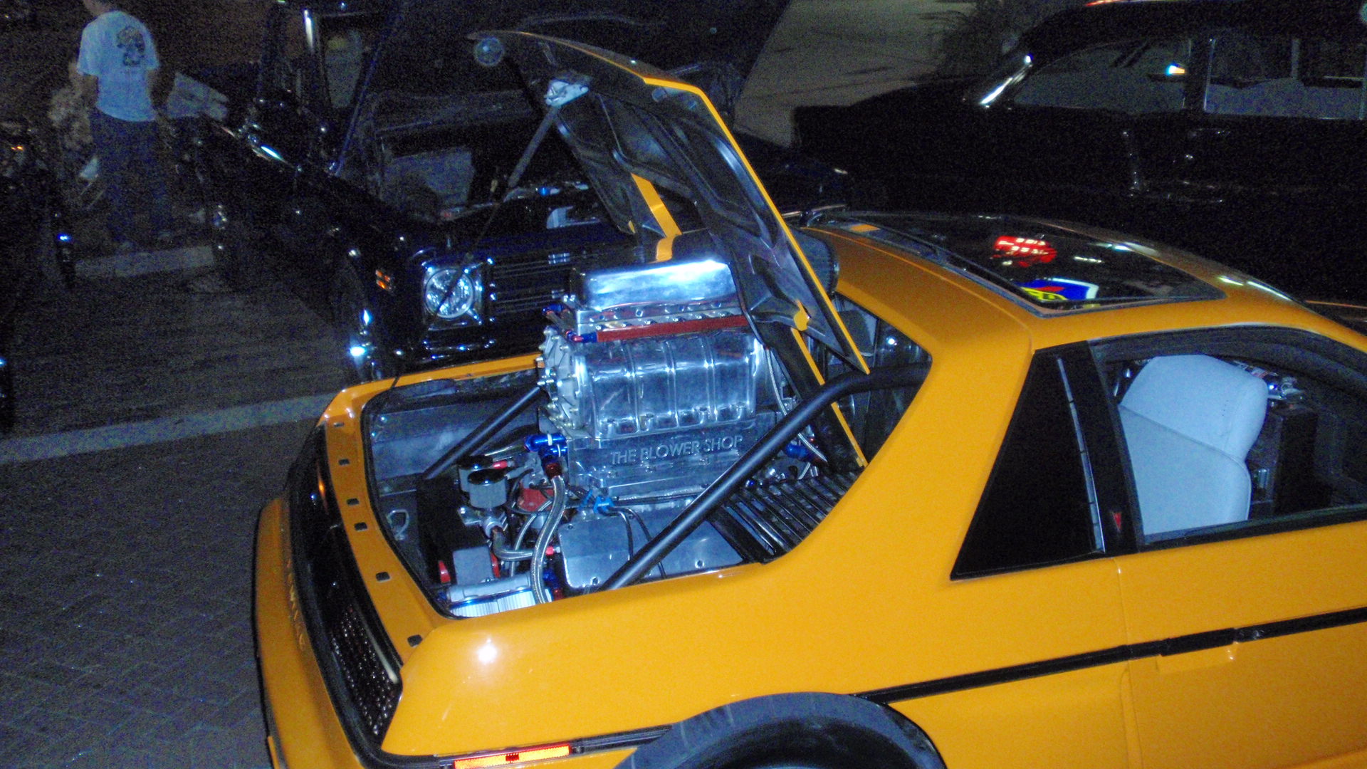

Picked me up a fiero with a blown motor for $350. Found these pictures of a Fiero mounted to the kit so I know it can be done.
