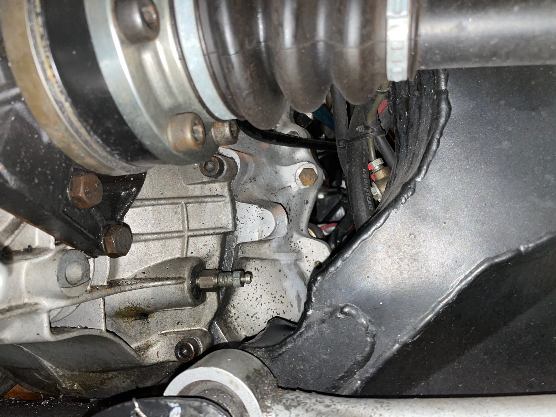

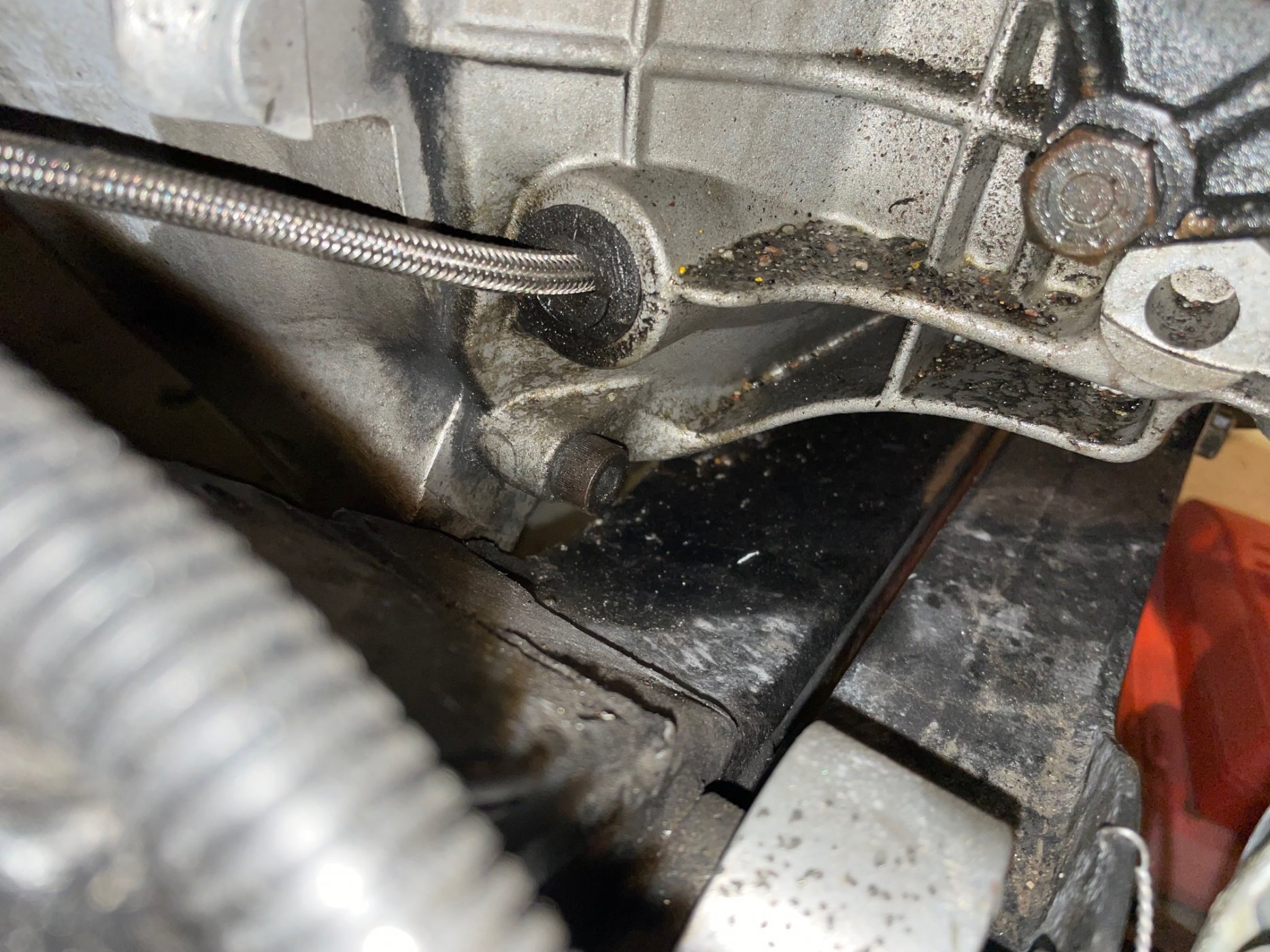

Got home, bled the clutch with all new fluid, and went for a test drive and the clutch is dragging or not engaging completely. If you give it any power the car will go up in RPMs but not move forward.
Is the clutch shot? Do I need to bleed something besides the nipple on the lower passenger side of the transmission? Do I need to adjust something?

Do you have a hydraulic throw out? If so I wonder if the initial loss of fluid or pumping has coated the friction disc in hydraulic fluid and it is now slipping.
I am not 100% sure to be honest, how can I check or determine if I do?

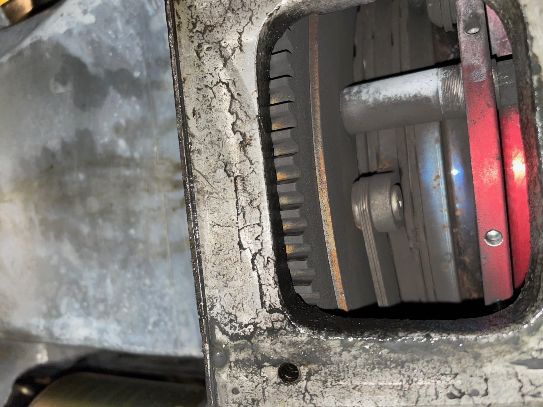

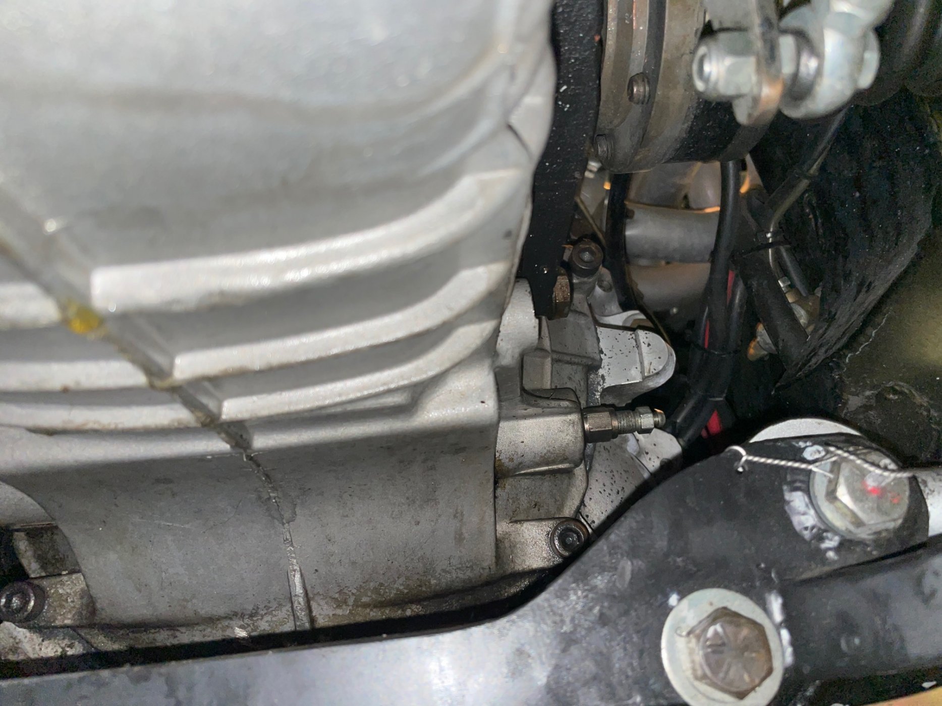

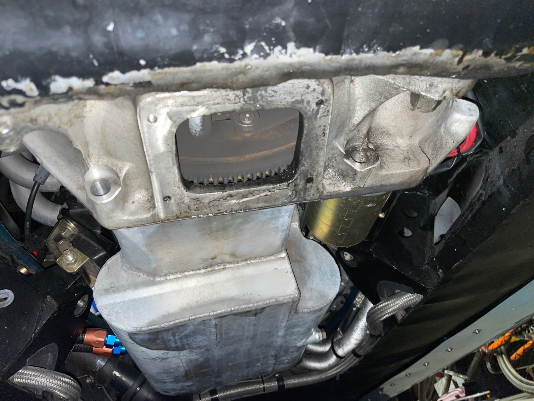

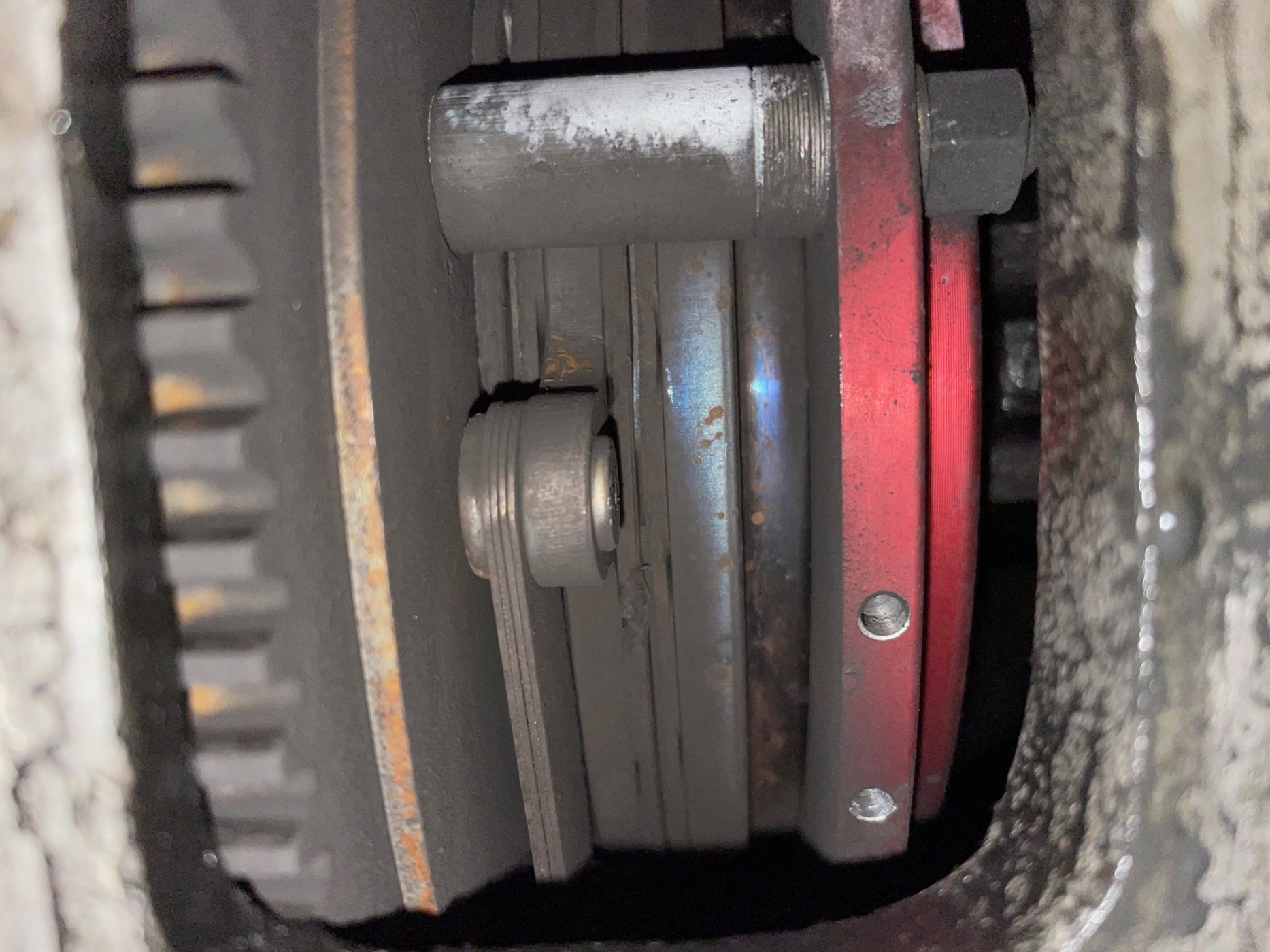

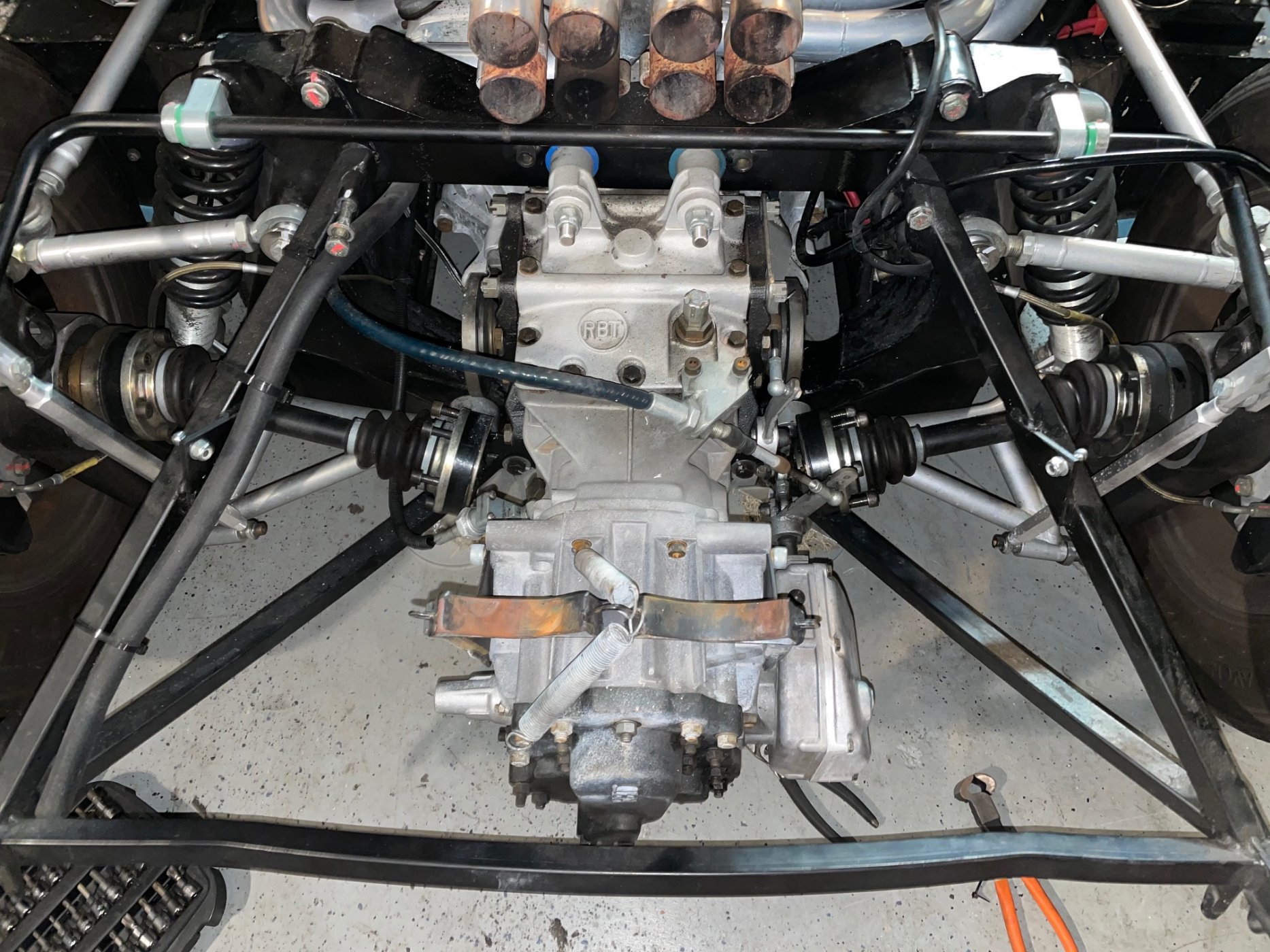

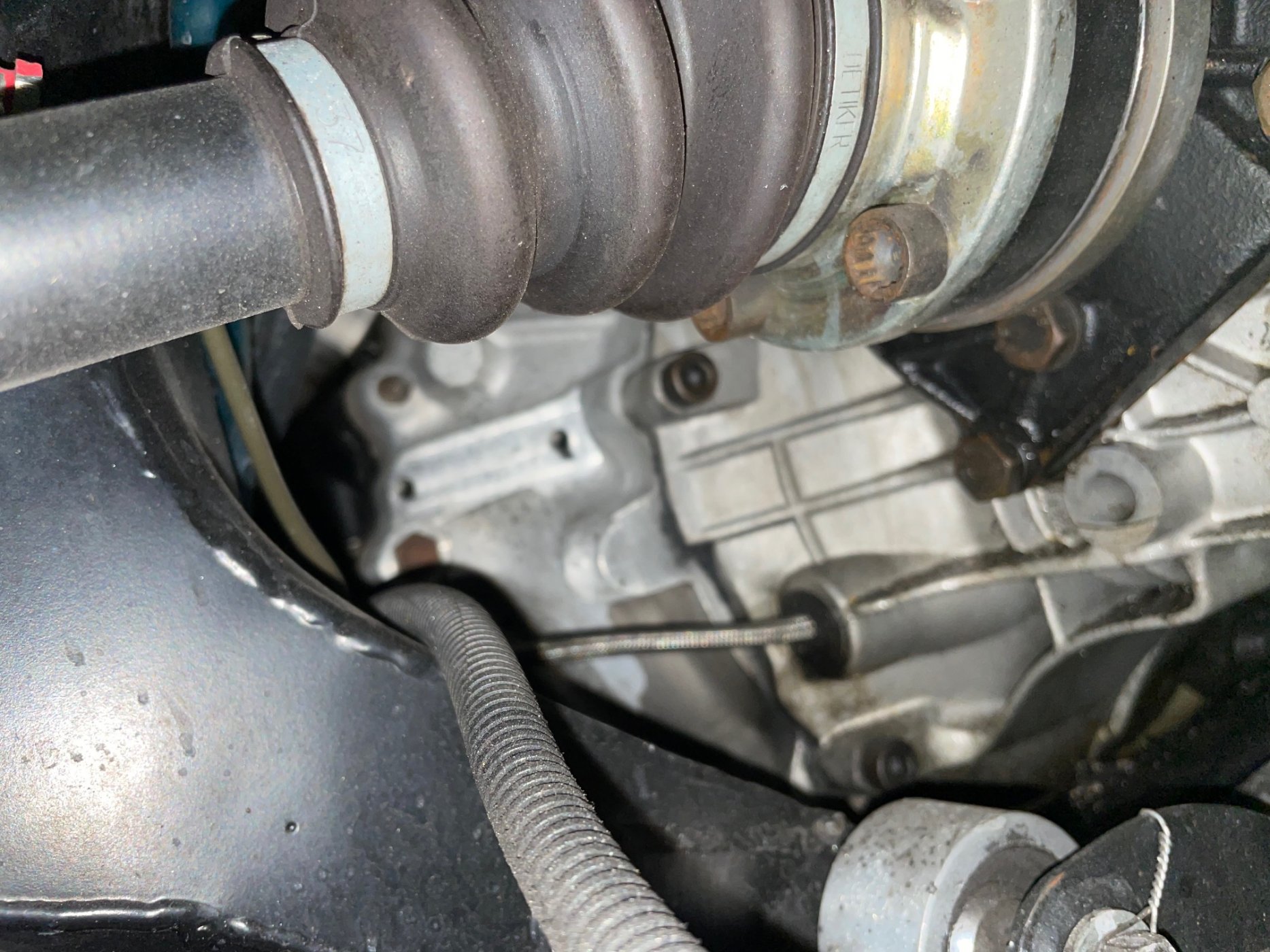

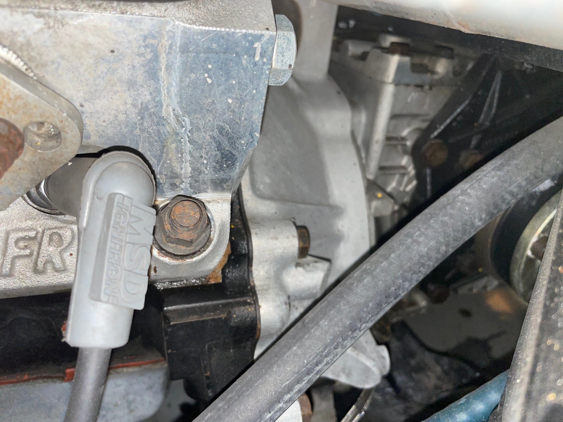

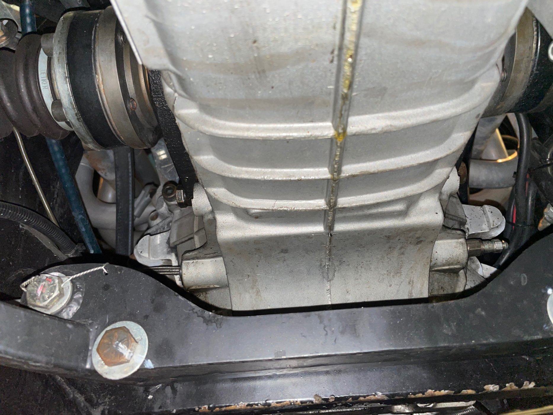

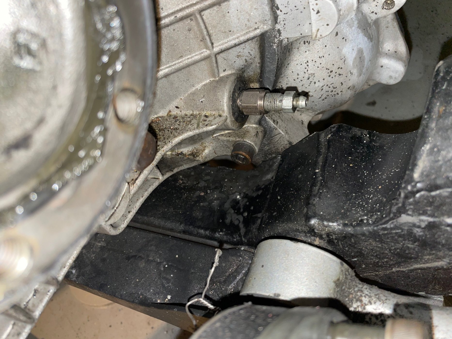

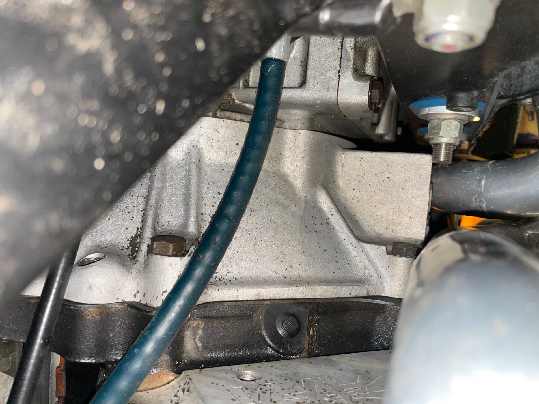

Started to pull the rear end apart, looks like there was a minor leak for some time. Going to replace the Slave and the Master just for peace of mind, also going to replace the clutch while I am in there.
Any recommendations on clutches for 347 motors pushing 500hp?
