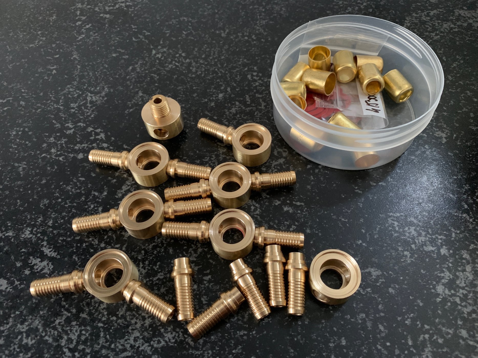

JimmyMac Lifetime Supporter Nov 26, 2022 #1 I wanted the original style GT40 fuel line banjo but made my own, however I revised it to fit the new top grade Teflon hose liners and with better fitting gasket joints. A wee bit of brazing and we are all done.
Randy V Moderator-Admin Staff member Admin Lifetime Supporter Nov 26, 2022 #2 James - Just out of curiosity - do you use a Silver-Solder on those Or do you actually flux them up and braze with brass rod?
JimmyMac Lifetime Supporter Nov 26, 2022 #3 Hi Randy Flux and brazing wire. I have a friend who is a silversmith and cutler and he is doing the job on them for me.
JimmyMac Lifetime Supporter Nov 26, 2022 #6 These will be plated so I think brazing is a better filler.
