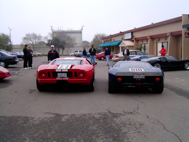

Here an image posted on the forum some time ago. The Ford GT is also roughly 15% larger than the original GT40 due to the previously discussed reasons. A scaled-up GT48 would certainly attract kit car enthusiasts that decide to purchase other kit cars at the moment.

A 20% larger gt40 would be ungainly and unappealing to many
The Ford GT is 12.6 % larger than a Mk1 and is plenty large enough with it's 106.7 inch wheelbase
Regardless of the cars size the door/roof design will make it nigh on impossible to make side impact and rollover strong enough
The reason the GT was not built longer was due to the fact that Ford knew it would not pass the changing criteria for 2007s USA rollover and front offset crash tests
The end of run cars were sold into Canada in 2007 as they implemented the updated tests 12 months later.

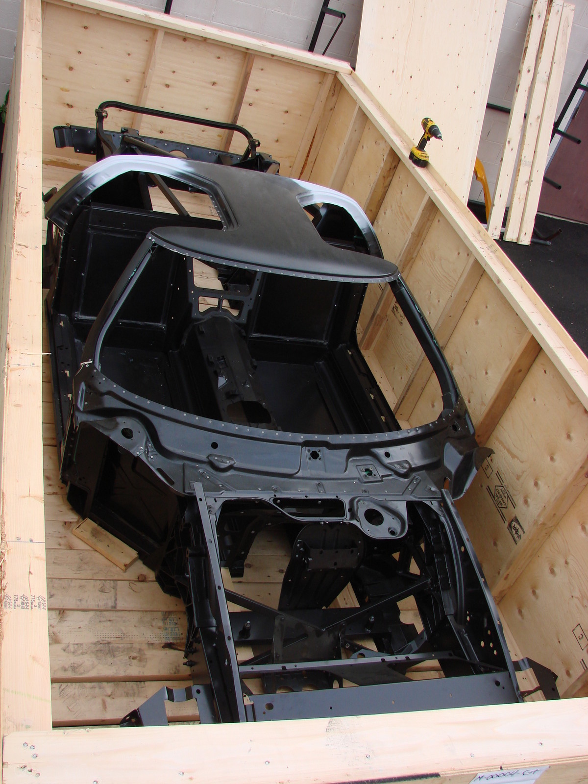

Here some images of the Ford GT chassis. Looks great, but I would be much happier if the previously discussed roof members would be included.
That is very interesting. The sills of the Ford GT chassis are very narrow, since there are no fuel tanks. Do you think the side impact protection of the Ford GT chassis is worse than that of the GT40 replicas? A first look at the Ford GT chassis images would suggest that.
