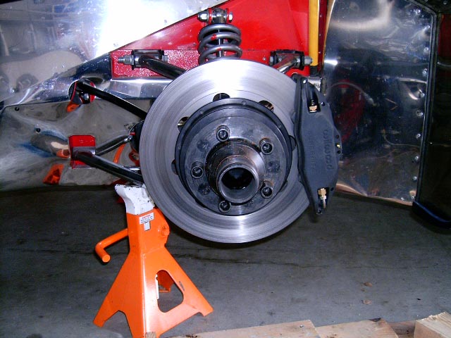

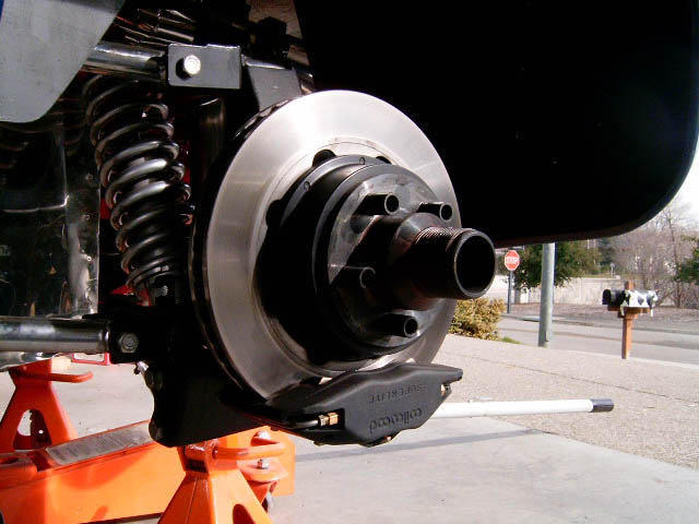

Howard Jones
This is a wilwood hat that comes undrilled. I just drilled it for the GTD bolt pattern. In the end the fronts required a 1/16" shim between the hat and hub to get correct caliper to rotor alinement. Otherwise a perfect fit.

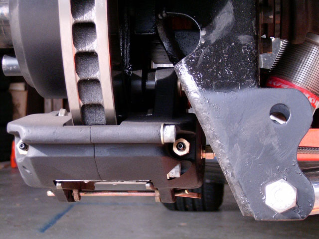

Howard Jones
Another, 12.13 X 1.25 wilwood HD48 curved vane rotor and superlight 2A caliper.

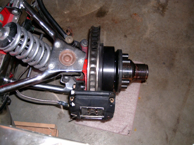

Howard Jones
Shot of caliper bracket. This shot also shows the end of the hose. I cut off the orginal metric fitting that came with the GTD granada caliper and put on a standard USA AN3 steel brake fitting.

Howard Jones
I would have to begin with I had a serious buget issue when I began this upgrade to wilwood parts. This is the main reason for wilwoods in the first place.
Compaired to alcons, baer, and others wilwoods are alot less money. I bought my calipers from stockcar products for $120 each. They are superlight 2a's and have been replaced in the wilwood lineup with billet superlight 3's. These are a 4 pot caliper that is used on short track stockcars that run 1/2 and 5/8 mile ovals. The cars themselves weight about a 1000 pounds more than our cars and usually run 50 mile races. Thats about 100 laps with two big brake zones per lap. 120mph down to about 65mph or so.
Rotors are the wilwood 1.25" X 12.13" curved vane HD's This is also the same rotor used on the same stockcars but limited to 11.75" in diameter.
I believe that I will be hard pressed to stress my brakes more than that.
The hats where the major issue. I wanted to use stock item wilwood hats so that I would save some money and stay away from a lot of expensive custom machine work. I ended up with the undrilled 1.41 offset 8 mounting hole type. It was necessary to drill them to fit the GTD bolt pattern and make a ring to fill the center hole on the fronts because the hole in the hat was about a 1/2" larger in diameter than the hub.
On the rear the fit was just about perfect and the hats only required having the 5 holes drilled.
To mount the calipers I had to make adapters. The fronts came out to 3/8" thick as did the rears. Again simple and little machine work. Th rears did not require shims but the fronts did need 1/16" thick shims to get the calpiers centered on the rotors. I will say that if you used 11.75" dia rotors on the rear I think you would be able to simply bolt up the calipers to the orginal GTD hub with a little opening up of the holes on the hub bracket. Less that a 1/16". I kept the caliper on the bottom to save money. The caliper adapter is a very small 3/8" thick piece that we welded to the orginal hub ears. The caliper then bolts to it. Again I think that 11.75" rotors would not need this step.
Now as to wheel diameter. I have 17" wheels. I did this because I knew that I wanted to upgrade the brakes and I also wanted to make it as simple as possible. 17" wheels left me with plenty of room for 13" rotors all the way around.
I also needed to install a porportioning valve in the rears. I have a little front pad chatter and have ordered a residual valve to fix that. Also from the above posts you can see that the wilwood "Q" pads worked well for me.
As to the master. At this point the standard GTD setup works well enough. I have kept the vac. boosters. At some point in the future I think I might change over to a wilwood duel master with ballance bar.
A first time design of the brakes as to cylinder diameters and such could be done of course but I think that a ballance bar still would be needed to get the front to back pressures just right.
As to bleeding the rears, The caliper needs to be unbolted from the adapter and swung up to vertical. This is something that is added work but to mount the caliper on the top would have required cutting out a notch in the upright. A front or rear mount would have needed a much more extensive adapter. Again a money issue. Its OK I don't need to bleed the brakes all that offen anyway and when I do I just swing them up like I did the old GTD ones.
I also needed to cut off the euro fitting at the caliper end of the brake hoses and put on a an3 fitting to fit the wilwood calipers. No big deal.
